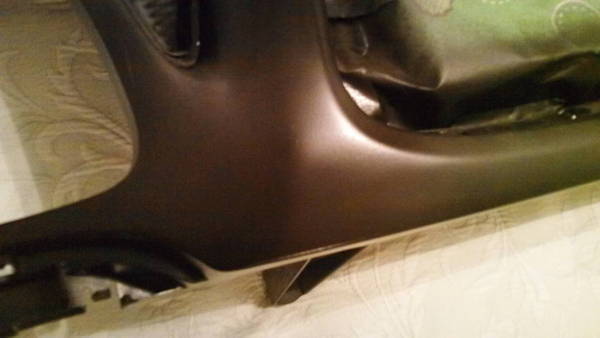

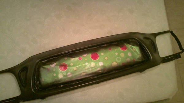

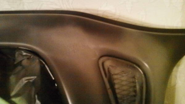

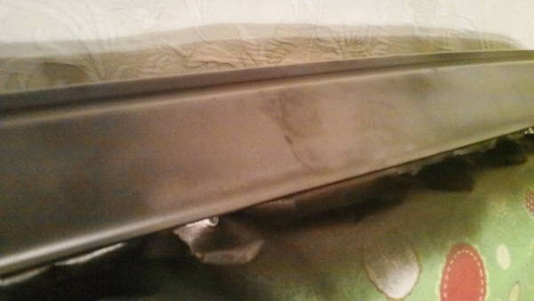

    Painted my grille surround today. Wet sanded with 400 grit sand paper, primed it with rustoleum automobile primer. Sprayed 4 light coats of satin black rustoleum, then 2 coats rustoleum crystal clear enamel. But i put a 3rd coat of clear on right as it started cooling off when the sun started going down. Put it on in semi darkness, let it dry for 30min and brought it in and it looks like its faded to gray in some spots? Any ideas why? :confused:
    )First pic is the whole grille with paper covering center.
    [​IMG][​IMG]
    this one is the bottom portion which turned out great and didnt fade
    [​IMG][​IMG]
    the next 2 are parts that faded
    [​IMG][​IMG]
    Like I said i did the 3rd coat as it started rapidly cooling off and maybe moisture or condensation had something to do with it?

    It might be blushed (solvent from previous layer or moisture trapped). You may be able to force the blush out with heat. Put it under a heat light or try a blow dryer just dont get it to close.
    If that doesnt help you will have to lay down base again and make sure each layer is pleanty cured before you add the next. When night comes often moisture settles, and the sunlight isnt there to cure the paint enough to not absorb moisture.

    The same thing happend to me last week when I painted my grille. I think it was because the clear coat, I did it over with krylon fusion gloss black and no clear coat.
