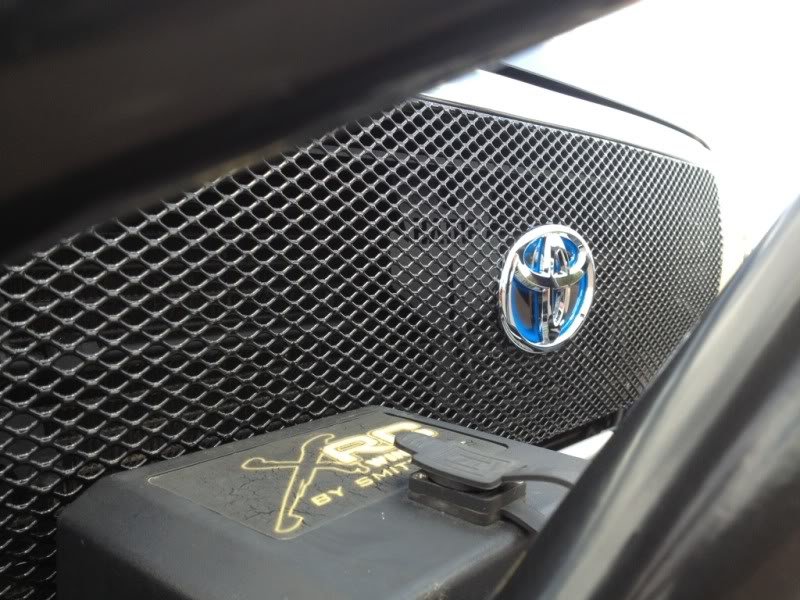

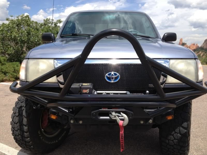

    These are some pics of mine. It's almost coated in like a rubbery finish so it's real tough. Only thing is, it looks like you want a thin lip. These will mount flush.

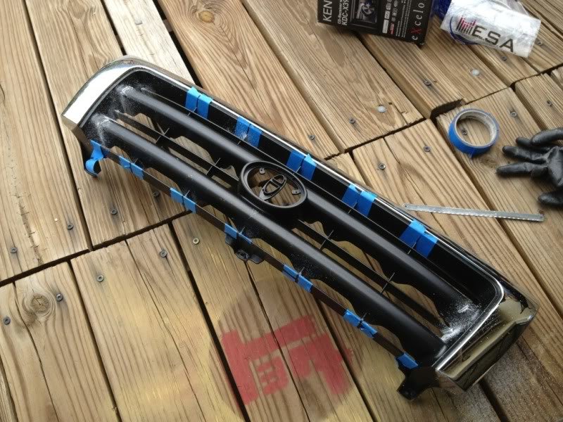

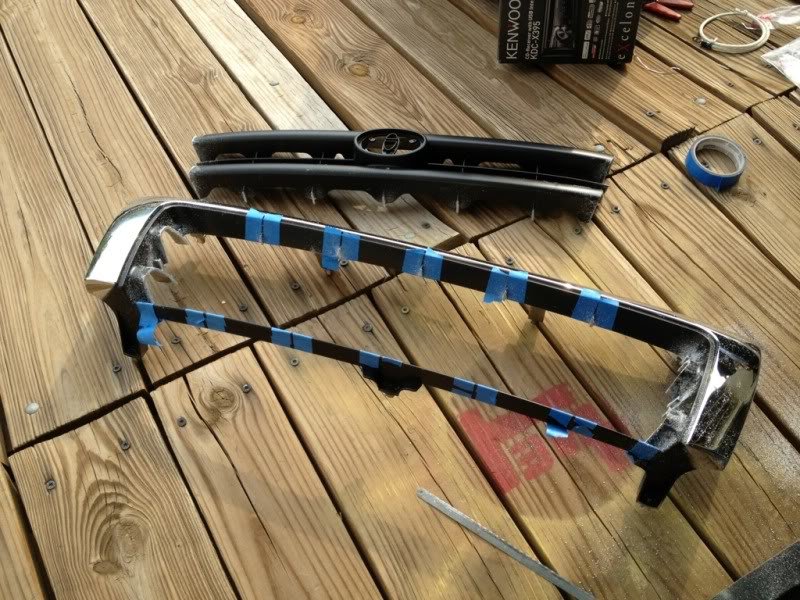

    I ordered a new grille from Rock Auto for about $25 then started cutting. I didn't have a dremel at the time so used I think like a sawzall blade lol. Much faster the other way though. Taped off the "lip" areas to try and not scratch it and then cut. Then filed down the remaining stuff sticking out until it was smooth. I left the lower piece for support.

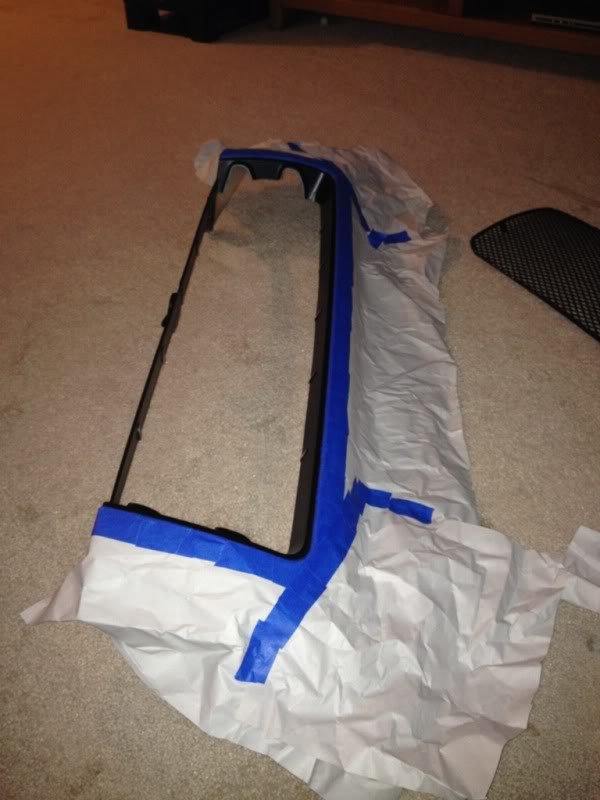

    Then taped it off and painted the inner lip area avoiding the chrome on the outside.
