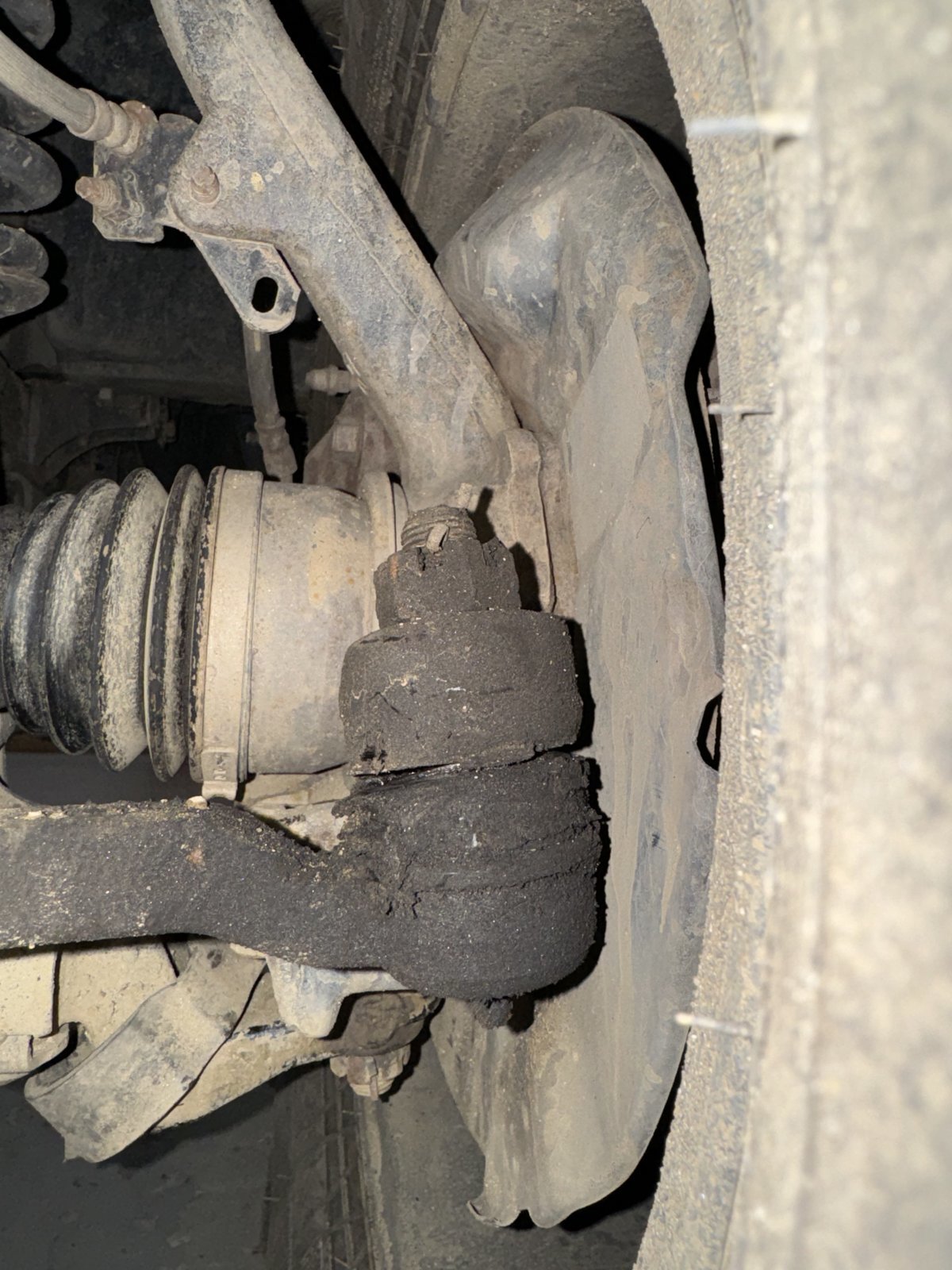

    - My passenger tie rod looks like the inside of a smokers lung... probably a split boot issue. Still, I don't think that is the issue because the vibration felt stronger at the LCA bushings.

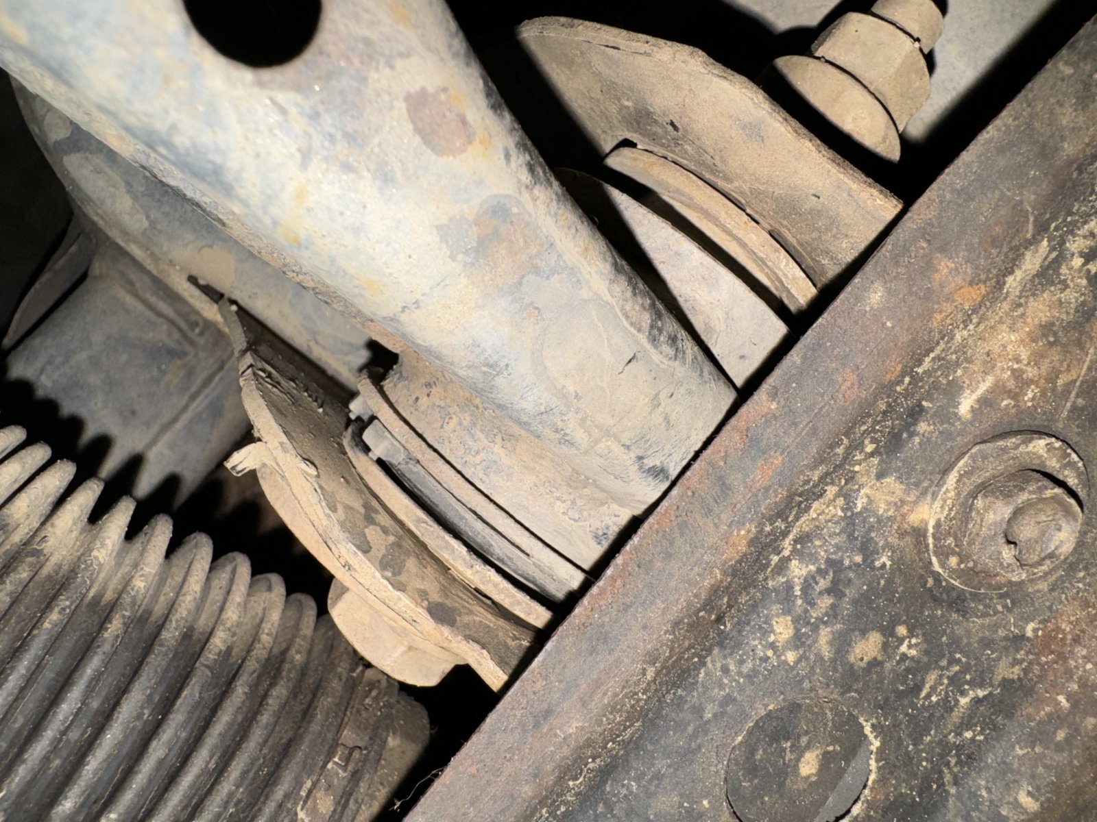

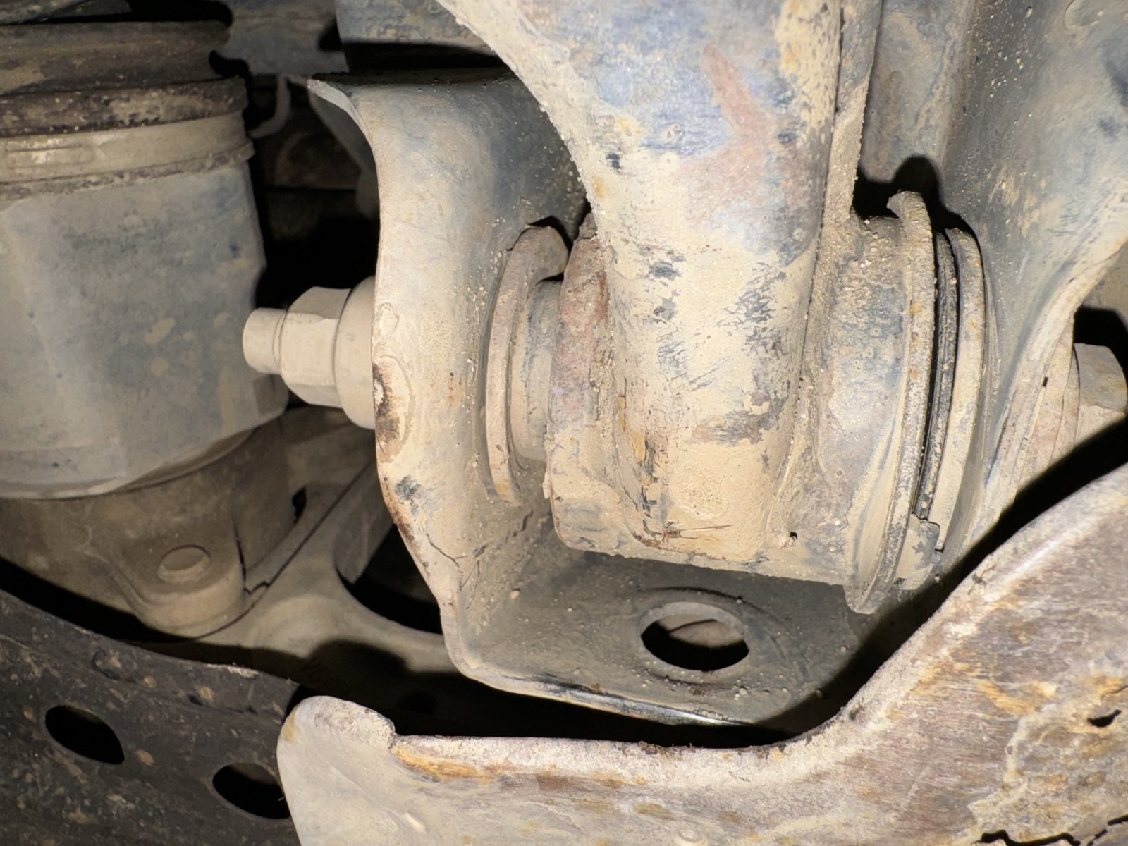

    Here are my passenger front/back LCA bushings:

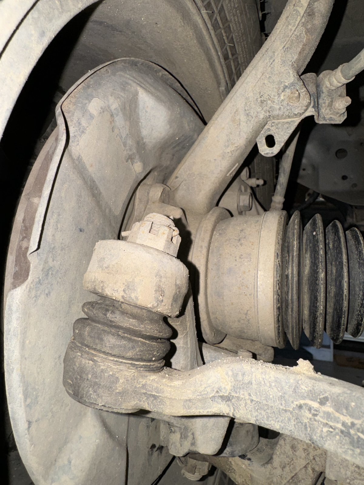

    Here is my passenger (yuck) vs. driver outer tie rod:

    Rest the front frame on stands and chock the rear wheels. Then have a friend turn the wheel back and forth while you’re monitoring underneath with truck off. If your rack bushings are bad you’ll see the rack moving side to side with steering wheel input.
    For TRE’s, grabbing the tire and shaking in/out with front end off the ground will produce slop/movement if the TRE is bad. I agree one of yours looks a bit sus

    Now that I reread your post again the passenger side noise and crap all over the passenger TRE definitely seems to point to CV. The boot is cut somewhere and flung its grease all over the TRE and probably your other suspension components. Then you went thru water and dirt; they made their way inside the boot and the Birfield left the chat.

    No way man, you ever have a cut boot, it flings grease absolutely everywhere, not specifically a single part that has a boot and grease in it.
    Visually, it would point to the TRE failing due to the leaking grease. But is that the noise? Maybe maybe not.

    So, I was under my truck and saw that my rack and pinion bushings were moving like crazy... Seriously like 3/4 of an inch of play.
    As much as I want to do it myself, I don't have the time or the garage space to replace them, so I brought it to a highly-praised suspension/steering shop in my area to do it. Plus, since I have bought the truck, I haven't had the suspension properly looked at by a mechanic, so this will help with peace of mind. I have no idea if this is what the popping noise is from, but regardless, it needs to be fixed for my own safety at this point.
    Will keep this thread updated with new findings.
