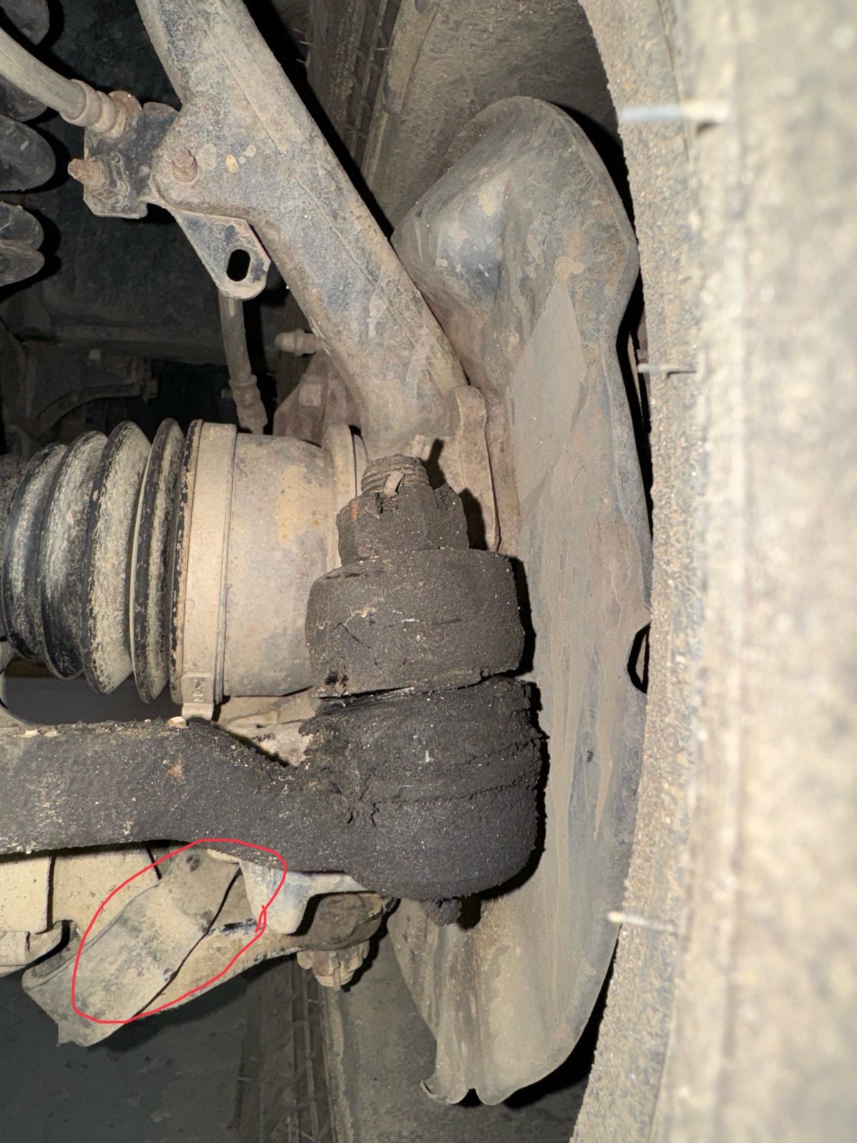

    Kevins60
    Kevins60 axle wrap tells me my rear brakes are working
    Dec 23, 2018
    #276677
    1,215
    Kevin
    Odessa FL
    ‘04 4cyl SR5 AT Pre-runner Garage Queen
    SCS Cruise Westin step bars Lund tonneau Jensen HU
    IMG_1425.jpg There’s definitely something amiss with this LBJ. The dust cover should cover the rubber boot.
