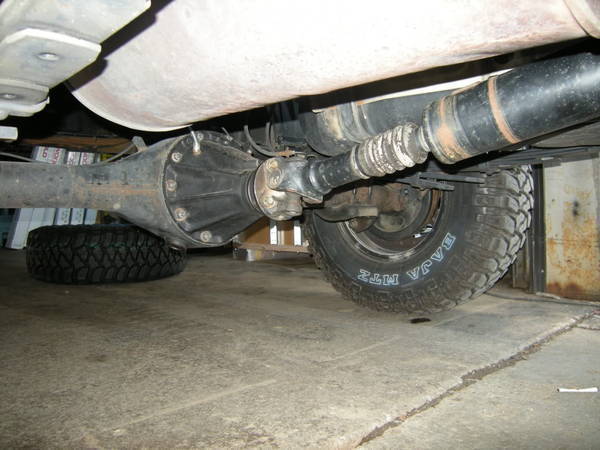

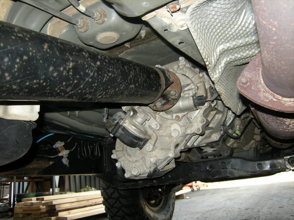

    Found some pics of where someone flipped theres. Still open to any info regard actually doing this.

    It's pretty easy.
    Mark one bolt hole on each end so it's the same orientation.
    Just support both ends after it's unbolted so you don't bend the u joints past their max angle as you remove it.
    Once it's unbolted, it'll need a tap from the hammer to let go.

    Ok. Am I actually taking the round plate on each end of the shaft off? Or half of the U-joint? A apologize for my ignorance but I haven't actually looked under there closely at it. It may be self explanitory once I get off of work and am able to look at it. I'm just going by this guys pics.

    The flange is attached to the pinion and stays there.
    Theres a smaller flange attached to each u joint that can come off when you remove the four bolts from each end.
    It will be obvious when you see it.
