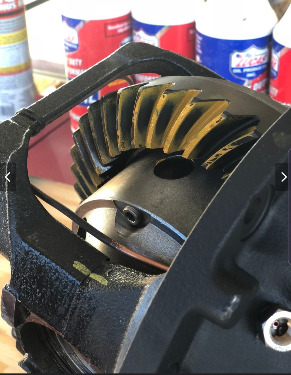

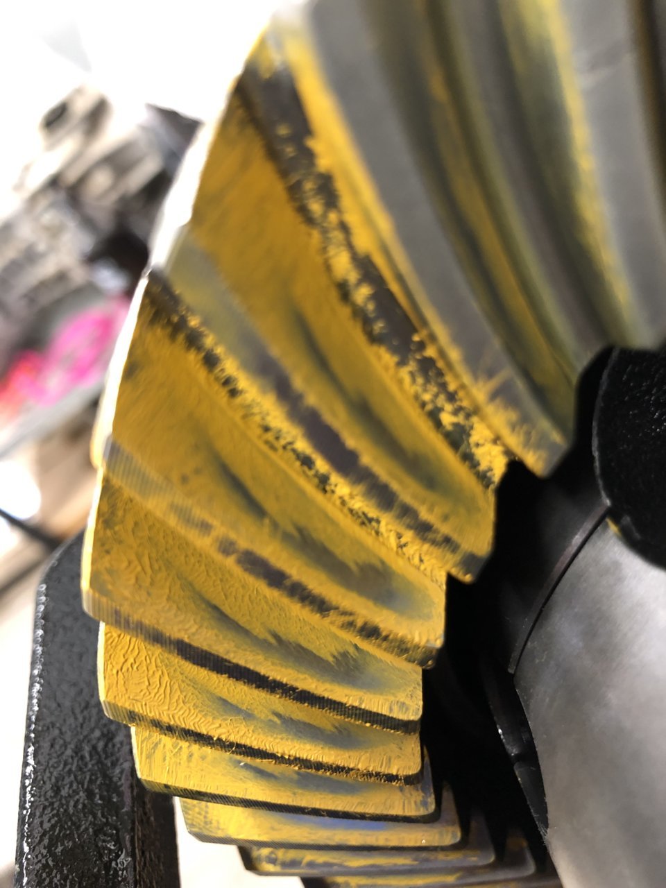

    I recently regeared to 4.88's and I have a grinding noise/vibration when I let off the gas at freeway speed. If I put it in neutral the sound amplifies and I can also hear a slight hum when I’m on the gas at the same speeds. After a few hundred miles I took the rear diff back out to check the pattern and the coast side looked like this.upload_2019-5-27_22-46-34.jpg
    I added and subtracted pinion shims to try and fix the pattern but the best I could get looks very similar to the picture above, just a bit more centered on the tooth (from toe to heel) and the pattern looks more like a crescent.
    I put the diff back in and still have the same noise.
    Everything I’ve read about nitro gears has been fantastic and the setup seems to be right so I’m not sure if that noise is coming from the differential, my driveline being out of balance, or something else.
    Has anyone experienced a similar problem or have an idea of what the issue could be?

    That was the gear pattern from mine when I regeared. Something looks amiss with your pattern, but I can't say for sure whether that is the cause of your noise. I assume it wasn't there before the gear swap?

    That looks textbook. And no the noise want there before the swap. Or if it was I didn’t notice. I did my lift a few weeks before the re gear though. And I know the driveline is spinning a lot faster after going down to 4.88’s so I pulled the rear driveline and checked the angle on the transfer case and diff flange and I’m within a degree of them being the same. It’s also and access cab so there’s no carrier bearing.
