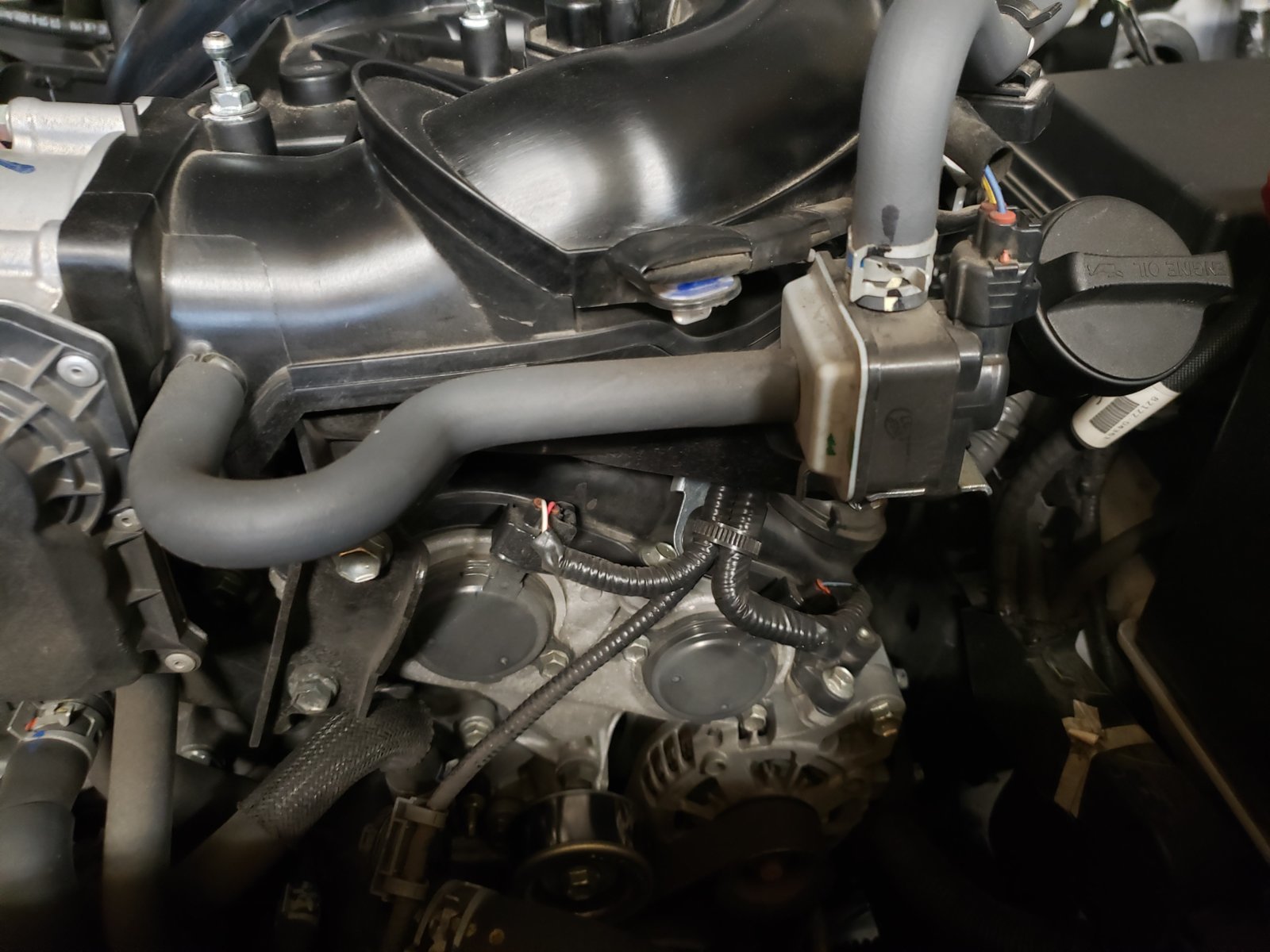

    Did you look at the purge valve and trace the house to the intake?

    Where the purge valve?

    Lift the plastic cover. It is on the left of oil filler cap.

    Okay, it’s not the part that sit on the outer part of the front manifold ?

    Yes hoses look good
