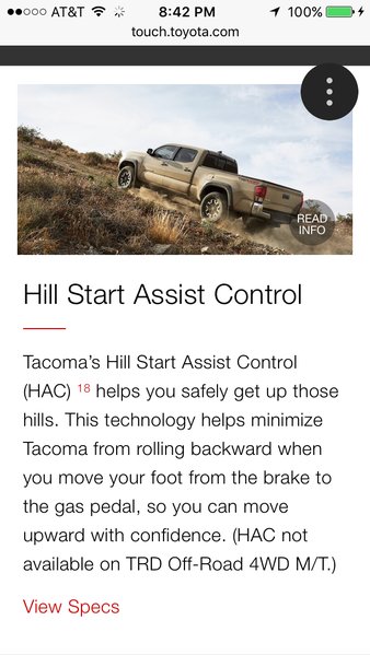

    It's your brakes activating from the hill assist feature which, as you've found out doesn't always work so well. It's not your transmission, please change your thread title.

    Swimmer, it seems my model does not have that feature. I could be wrong. Thanks for the help

    Your first post says you have an automatic.

    Yes I do :crapstorm: sorry gents and thanks for the help.

    Woo Hoo .... problem solved ....... Hill Assist Control ..... Ok, after work, I will go find me a hill and give it a try ...... good thing I read this on the forum, because I am SURE that I would have thought that the gears would be grinding as well.
