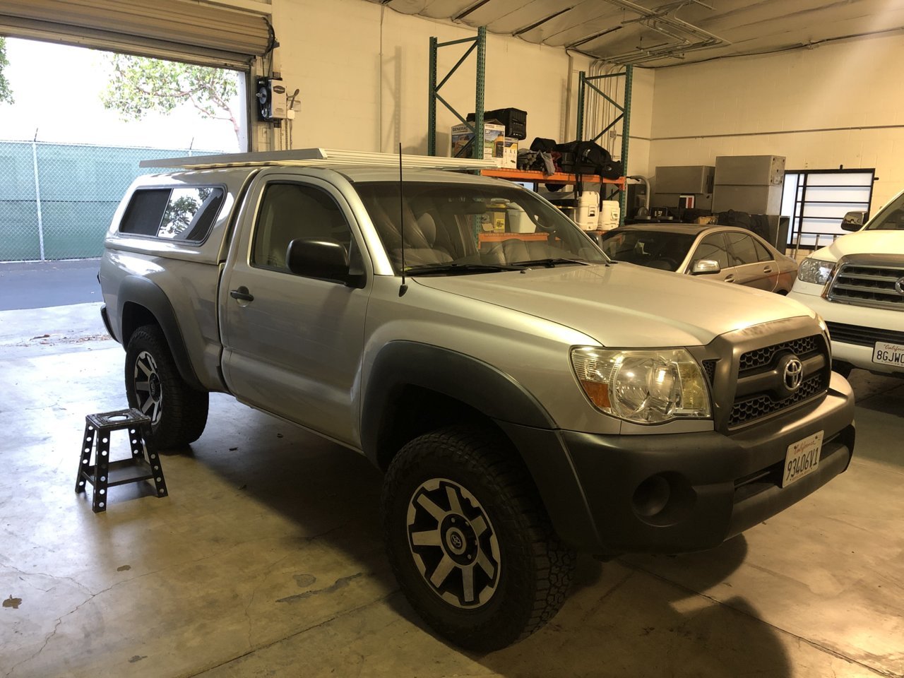

    Hello TW Friens.
    I have done some research but haven't found a thread describing my particular problem so I am creating this thread to hopefully shed some light on my Dumb@s$.
    2011 Regular Cab 4wd 5 Speed
    1.5in lift all around using TRD off road suspension an a Toytec AAL.
    When driving at highway speeds and either no load is applied OR I depress the clutch, I get a grinding/ vibration from what I think is towards the rear of the truck. I brought it to the dealer for a 60k mile service and took a spin with one of the techs to demonstrate the issue; they mentioned that it could be the damper inside the driveshaft needing to be rebuilt, and wanted $400 to remove the rear drive shaft... so I didn't even ask about the cost for a replacement.
    The strange part to me is that there is no issue when below 50mph, and so many of the described issues from others are when accelerating from a light, but mine seems to be when the driveshaft has no load and is being driven by the diff and not the trans.
    Curious if any one else has had this issue and if a ECGS bushing, diff drop, carrier drop would help with this.
    Thank you all!
    Pic for good measure.
