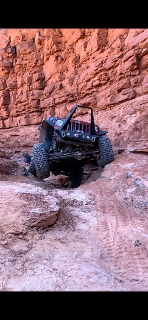

    The slippery slope I speak of has to do with modifications that result in other OEM components being compromised in the driveline because they no longer operate at their designed angles or stress tolerances. IE Birfield joints, U joints, ring and pinion, axles...... Then their is the addition problem of ME wanting an absolute trail beast and winding up with an LS3, 4.5in lift, full float Danan 60s and 39in KM2s, among other things.

    Cool Jeep! Just be aware a Tacoma (especially a DCLB) might struggle to go many of the same places... The long wheelbase and the IFS can be hindrances in very large rocks unless you reeeally start throwing some $$$ at it (to include going even as far as swapping out the IFS entirely for a solid axle), which this it sounds like you're trying to avoid.

    Thanks for the input. It's been to Moab 3 times. 3 rated trails or less are no problem, but I've been out there 25 times and know the trails. Rocks beat the crap out of the skids, but that's what they're their for right?
