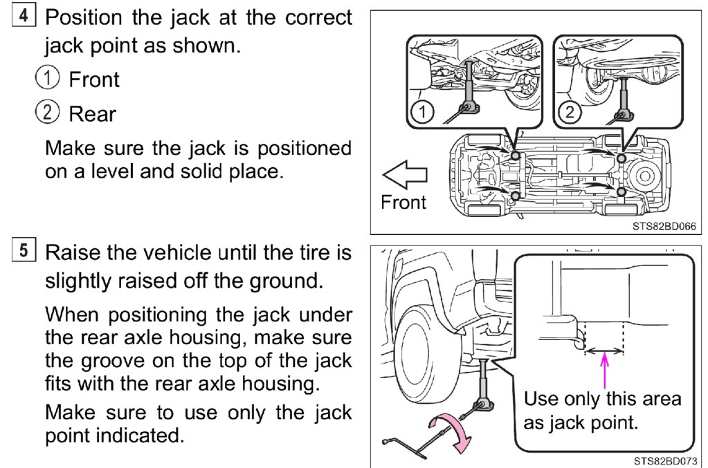

    You can always put it under the tube on either side if the center doesn't have the clearance. I was wondering this myself and pulled up the manual to take a look:

    Yeah, it’s not as if you need to lift the whole ass end to change one tire. I’m just really used to the diff as a jack point. Only had the truck up to rotate tires, Have a regular floor jack for that, haven’t had a flat yet. :fingerscrossed:

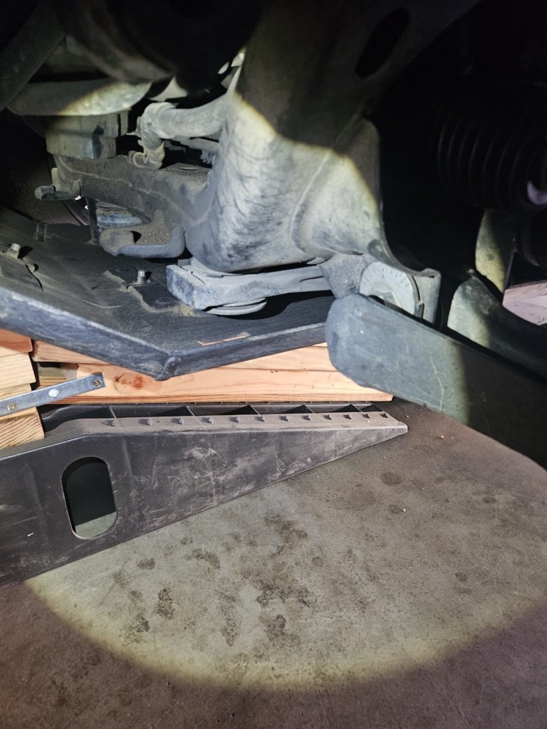

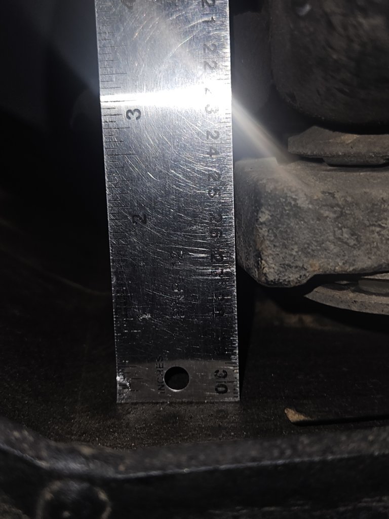

    One big engine skid clearance that isn't always known before purchasing is the amount of space given between the front differential and the plate. For example, RCI engine skid spaces about 1.5" down. I presume this is to allow for a dif drop. If you are low lift and do not dif drop, you are giving up an inch of front clearance.

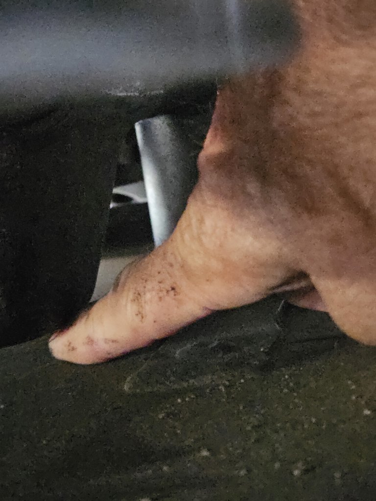

    I posted this update in another thread too. The front jack point is only 1/2" above the top of the RCI steel engine skid, not an inch or more given away for future dif drop. That said, I can live with 1/2" lower than need be. It seems strange that the upward facing skidbracing posts go right up into the bottom frame cross member but the same exact fit is not done with the downward facing jack point.
