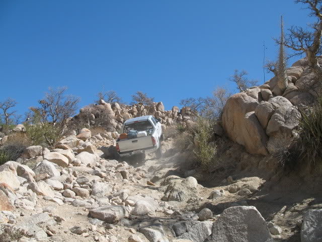

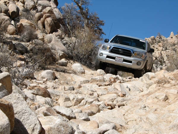

    Well, if you ever come down to Baja or the desert, we have a reason for wanting more than 9 inches of ground clearance!
    The Widowmaker Grade near Mission Santa Maria is just one example...

    I am no stranger to the rocks, and I understand the need for ground clearance. I do my crawling up in the Sierras though (outside of the annual pilgrimage to KOH of course)
    Your truck appears to be tackling a fairly tough climb and yet is doesn't seem to have lots of clearance. ;)

    My truck is stock... and the photos above are of just one of three Tacoma trips over the Widowmaker (2003, 2007, 2010) in each of my three Tacomas ('01, '05, '10), all stock with the BFG Rugged Trails 265/70-16 in '03 and '10 and Cooper Discoverer STTs 265/75-16 in '07.
    Look up Widowmaker, Baja on You Tube.
