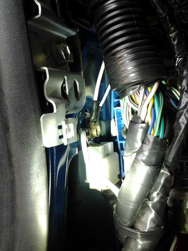

    Hey guys. New here ! I'm installing fog lights on my 08 Tacoma and I can't find anywhere inside the cab to connect the black ground wire for the switch! Any advice? Pics would be very helpful ! Thanks!

    Behind the left cover in the driver's footwell there is a ground bolt with a bunch of white ground wires going to it - just use a 1/4" eyelet on your wire and add as many as needed.
    Like this:

    yep this is what i attempted when i installed the ABS on/off switch. my problem was i couldnt find a rachet to fit the bolt to unscrew it. it seemed like it was stripped. if you have that problem @ Bro highlander , i grounded my end to the back of that metal clip up front in the photo where the kickpannel snaps on works just the same just isnt as secure of a connection.
