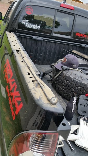

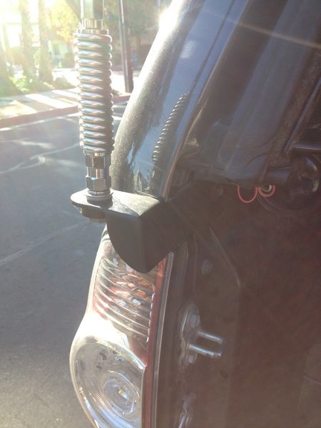

    Any suggestions to the best way to ground my Firestik antenna mounted on my tailgate? Will I have to run a wire to the frame?

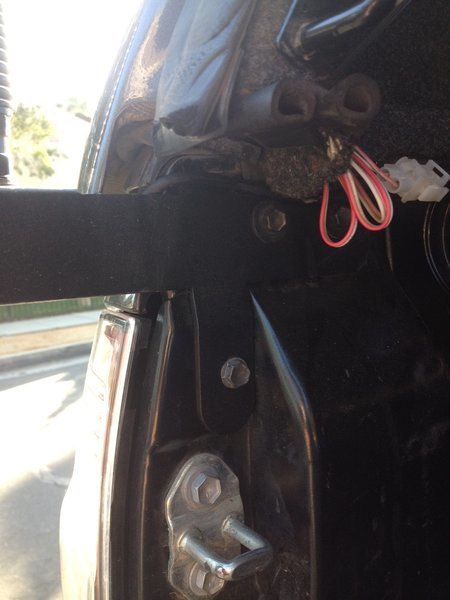

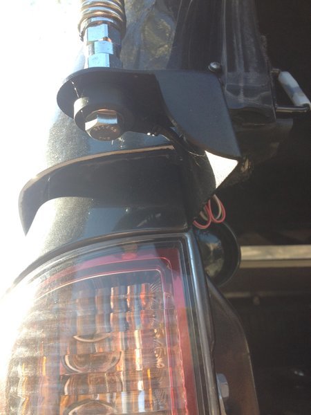

    Hard to tell in your photos, but if that antenna mount is steel (or aluminum), and is bolted to the cab, then you may not need an additional ground. If the mount and/or cab is painted where the bolt is, then that would be an issue.

    From the pics it looks like paint is between the mount an cab preventing there to be a ground.
    Grind the paint away so bare metal is touching bare metal, or wire up a little ground wire to the mount (must be bare metal to the wire) and run it to another ground on your vehicle. Should help

    That mount is already grounded. I have the same so your g2g after you tune the swr
