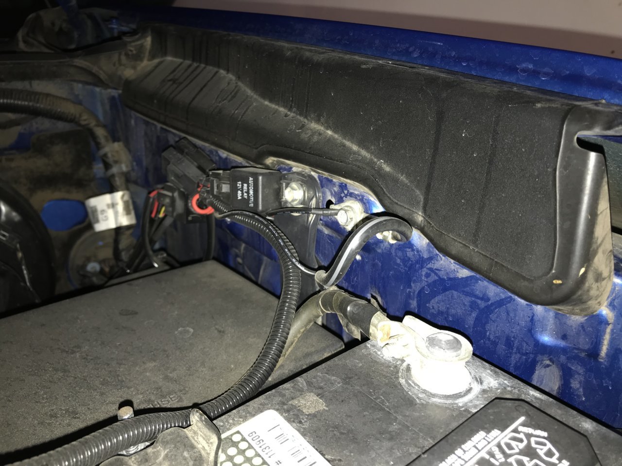

    In back of and just above the negative post.
    splitbolt, 02Duck and SauceTaco[OP] like this.

    Thanks man! I was not sure if I could do it there because of the paint, but looking at the picture it seems fine to ground the black wire there.
    CaptainBart45[QUOTED] likes this.
