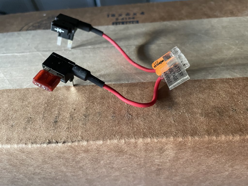

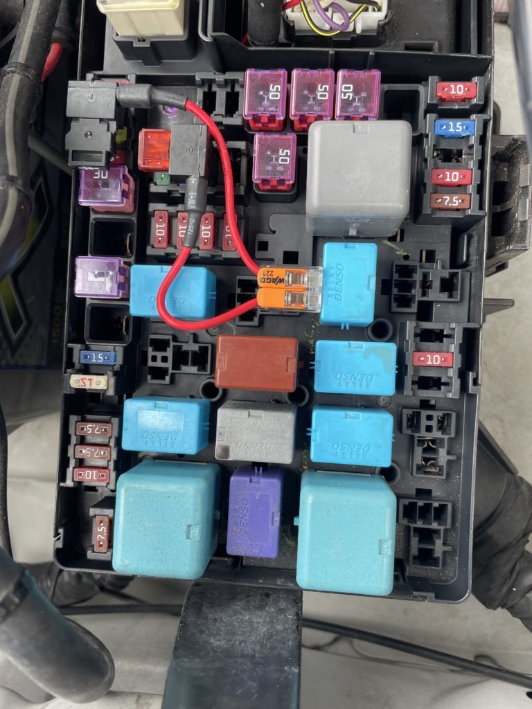

    Make one using a mini diode and 2 add a fuse adapters.
    I ordered the diode from O'Rielly's and picked up the next day. In my area they are not in the stores.

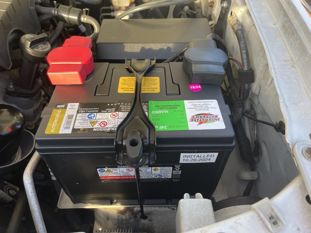

    I just downgraded from a 6 year old X2 to a less expensive Interstate AGM. I removed the booster as it can shorten the life of a regular AGM
    battery from excessive float voltage. The mod is needed for the X2 battery in my opinion.
    My truck came with a 27F and I downsized with no problems. The X2 24F has better specs than any 27F lead acid battery. And weighs more also.

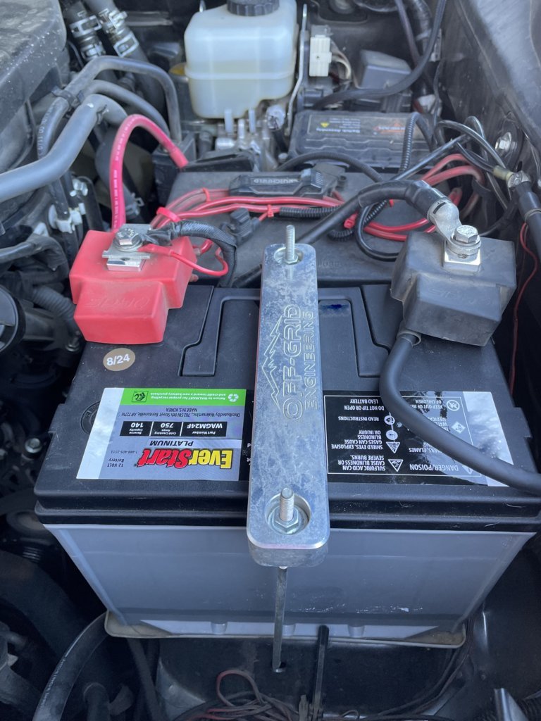

    I've been running a NorthStar 27 as the primary battery since 2019. No issues getting it to fit (using the OffGrid Engineering tiedown)
    That said Im definitely going to be downsizing to a 24 next time I need to buy batteries. A 27 is a lot of weight for that little core support, and its taking its toll. Probably too late for me honestly. But if you dont need a lot of power, Id 100% stick with a 24
