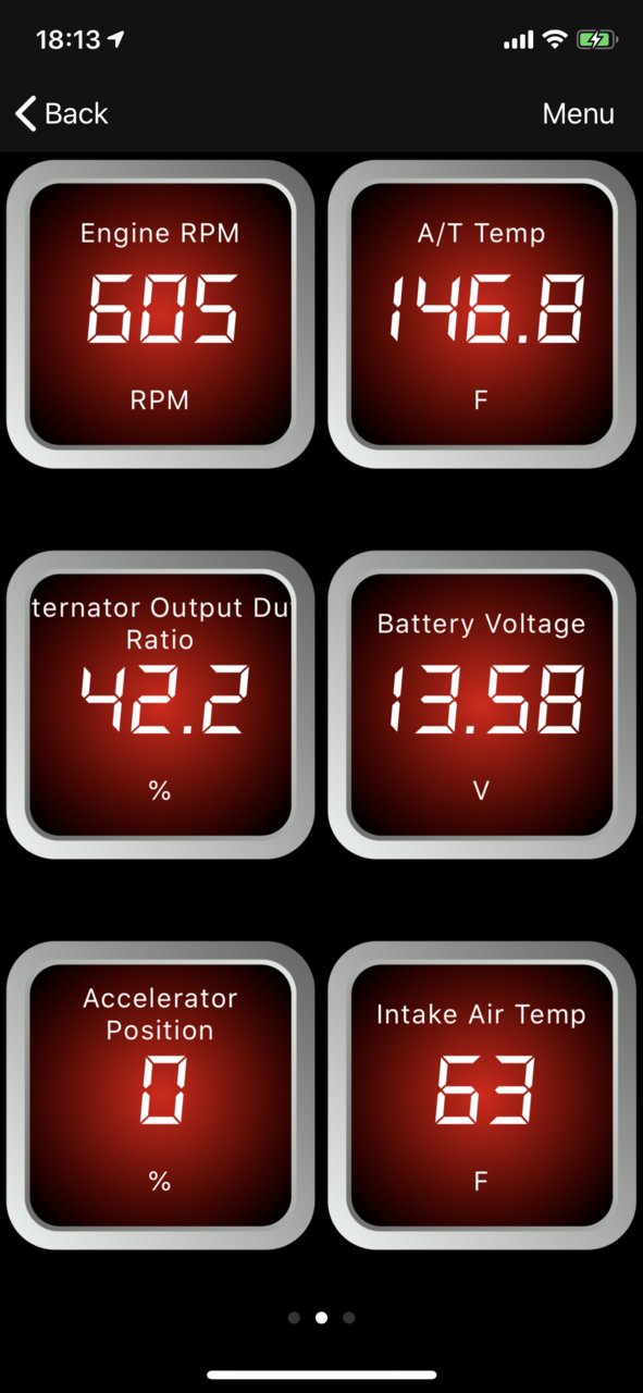

    Interesting. I checked mine at idle while getting gas this evening..
  19. Dec 10, 2018 at 6:47 PM
    #59
    johntoyota
    johntoyota "I'm higher than you'll ever be." -Treetop
    Mar 11, 2016
    #180956
    5,245
    John
    Down yonder in TN
    16 truck
    Yours says % under it.
    Yours says volts.
    Curious, 19.x would be insanely high if it were volts.

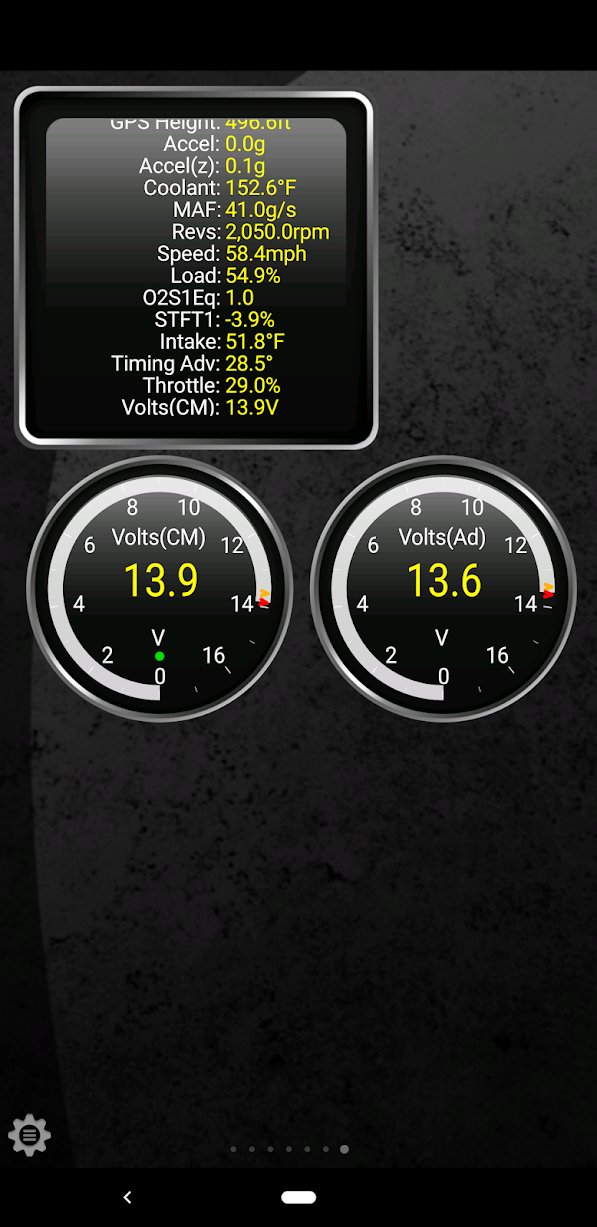

    I snapped this. It was the highest that I saw and did surprise me a bit since I thought that I saw higher charging numbers in the post.
    You can see from the tick marks, that the volts didn't range any higher. The left one is commanded (by the ECU?). The other is reporter through the OBD adapter.
    I would definitely think this is too low to keep an AGM happy?
