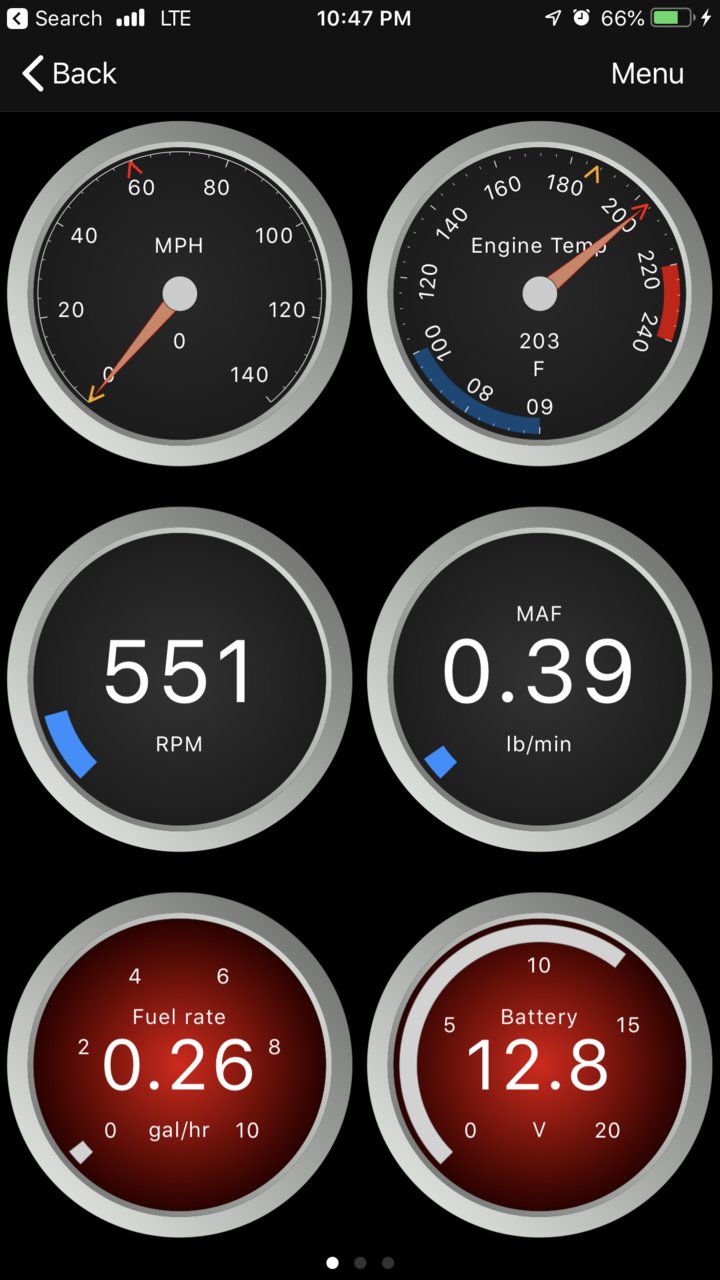

    This was mine at idle. It didn’t get up into the 13s at higher rpm, but never the high 13s or 14s.
    This is why I am installing a solar panel to supplement the alternator.

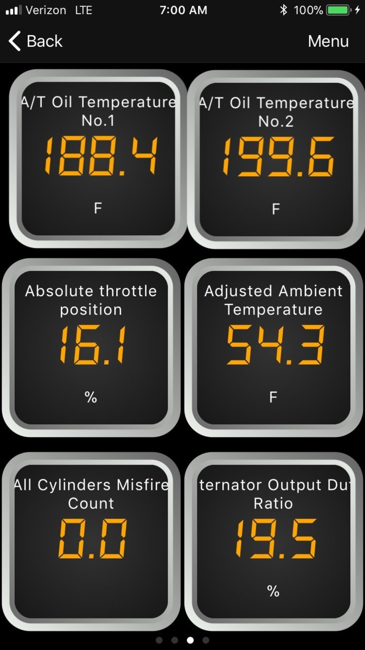

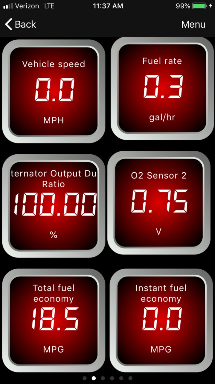

    What is your Alternator Output Duty Ratio % at idle?

    I couldnt say except to say that that picture was taken at idle. Id have to be honest and say that I am not familiar with the term "Alternator Output Duty Ratio %".
    I did take an interstate drive in to work this morning just to get out of the stop and go traffic to see if some higher RPMs and sustained RPMs would boost it. The readout on my display never broke 13.0.
