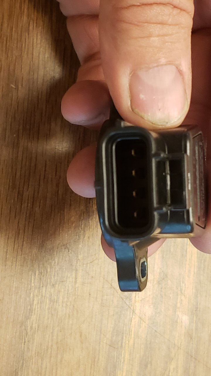

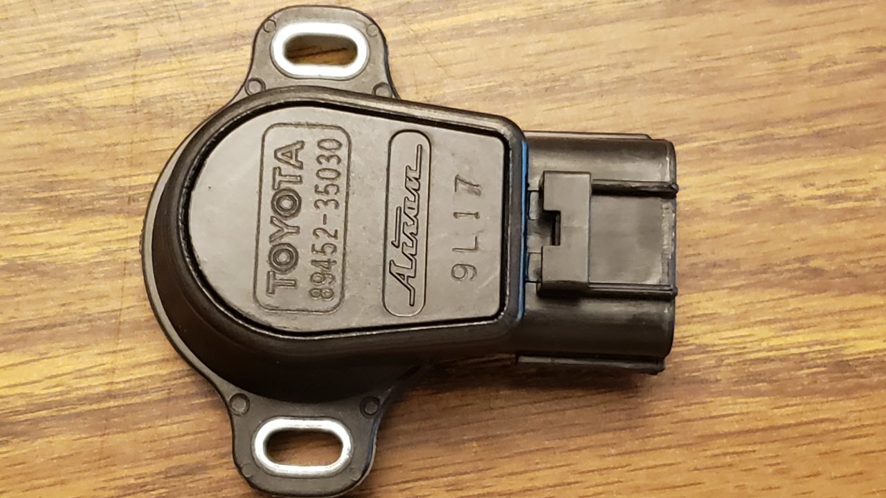

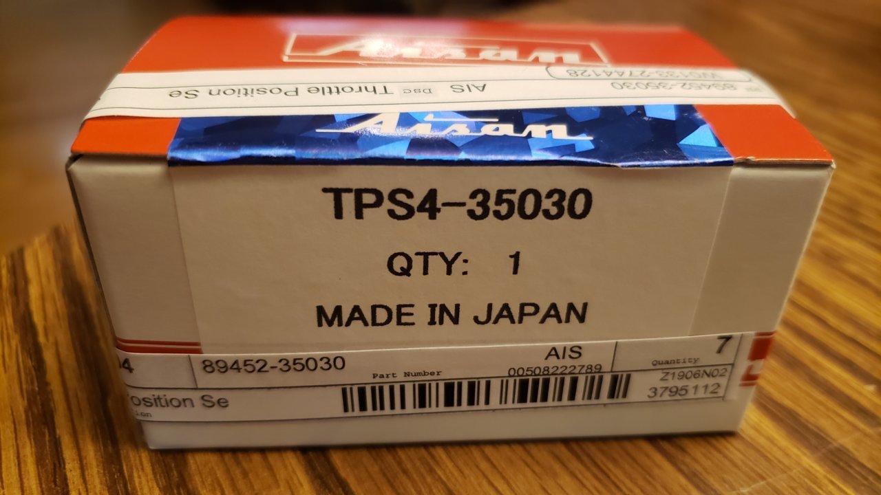

    Ordered the Throttle Position Sensor from PartsGeek.com got it next day and it is the 89452-35030 part # needed for the 2003, 2004 Tacoma. Installed it and it works great. So now there is a way to get the sensor without having to buy the entire throttle body.
