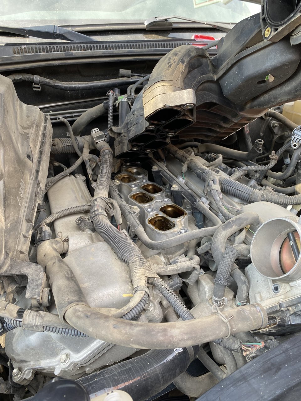

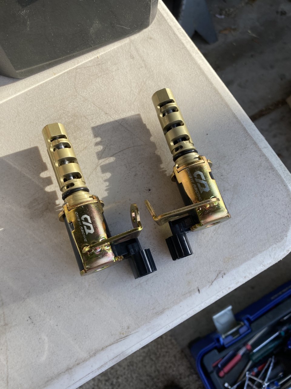

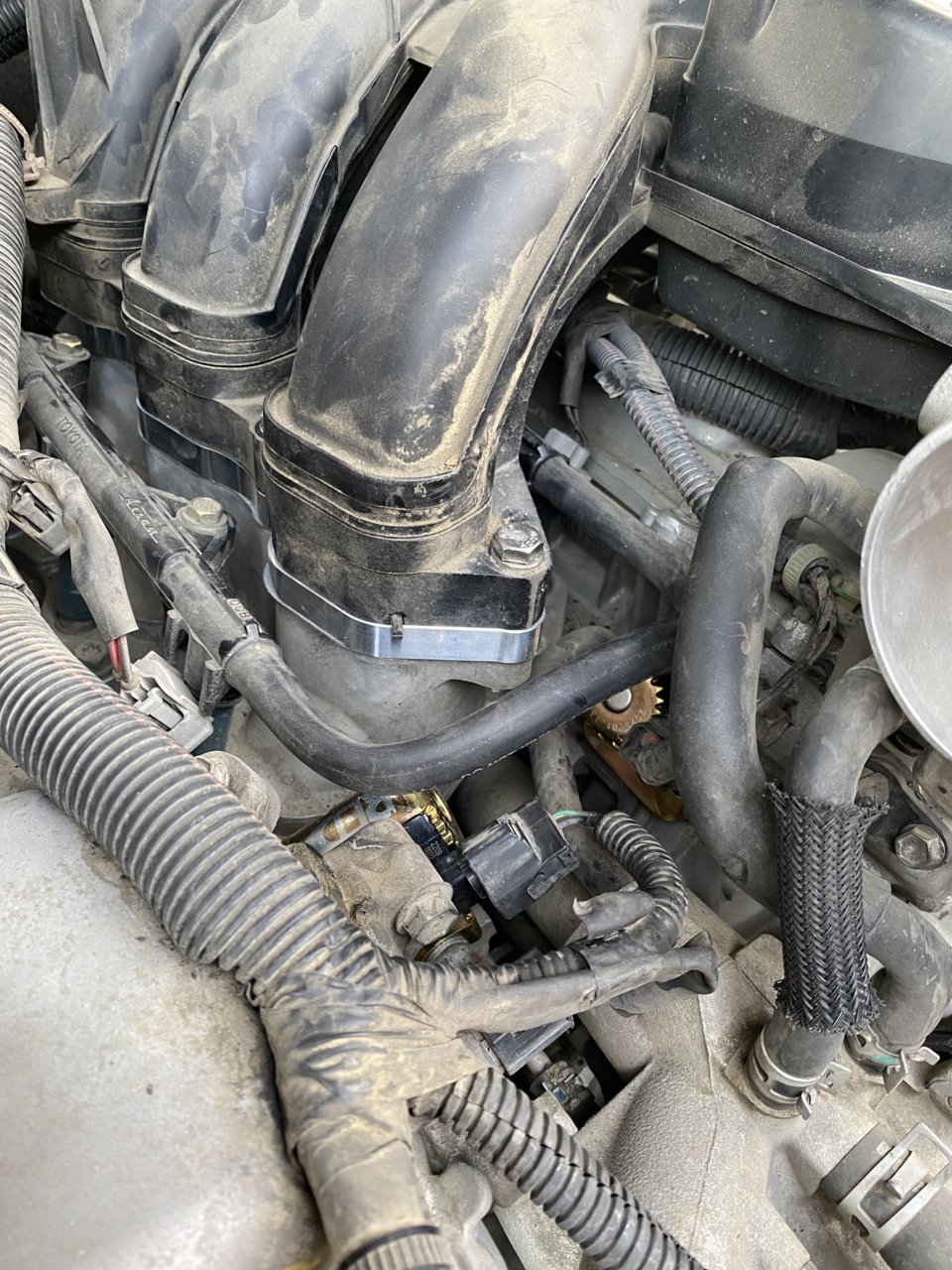

    Installed mine this past weekend with an intake manifold spacer. Old ones were a bit tight getting off, new solenoids went on easy. :thumbsup: Intake manifold spacer is supposed to lower the torque rpm range and it seems to be doing just that with help from cam gears mod. Engine is running smooth as ever!

    Is that all blow by in the intake?

    you can thank the PCV valve for that crap in the intake. Catch cans help reduce this snot from reaching the intake runners and TB.

    Welp that picture alone is enough to make me want to buy a catch can.

    I've seen worse lol. I've heard mix reviews about getting a catch can. What are the negatives of having a little oil make it's way to the intake runners? If anything I would think it would help catch more dirt and aid a small bit in lubrication. I can see it would dirty up the air-fuel mixture slightly, but nothing that would harm reliability.

    "Oil catch cans are simple devices that greatly benefit direct injection engines. The oil catch cans prevent oil and other contaminants from causing a buildup of debris inside the engine's intake manifold."
    Can mess up plugs, pistons, valves, etc if it builds up. A little blow by is probably fine, but a lot is not ideal as it builds up.

    Pretty sure that is a worst case scenario. Seen stock 4.0L go 400k+ unmodified. However, I agree your point of view, keeping the intake manifold clear of excessive debris for protection of the valves and plugs would be more optimal. Not like catch cans are difficult or expensive to add anyways. I'll probably add one soon. :thumbsup:

    I'd say monitor it for a while and if it's not catching much between changes it's probably fine. If you're having to dump it between changes, then there may be an issue.
