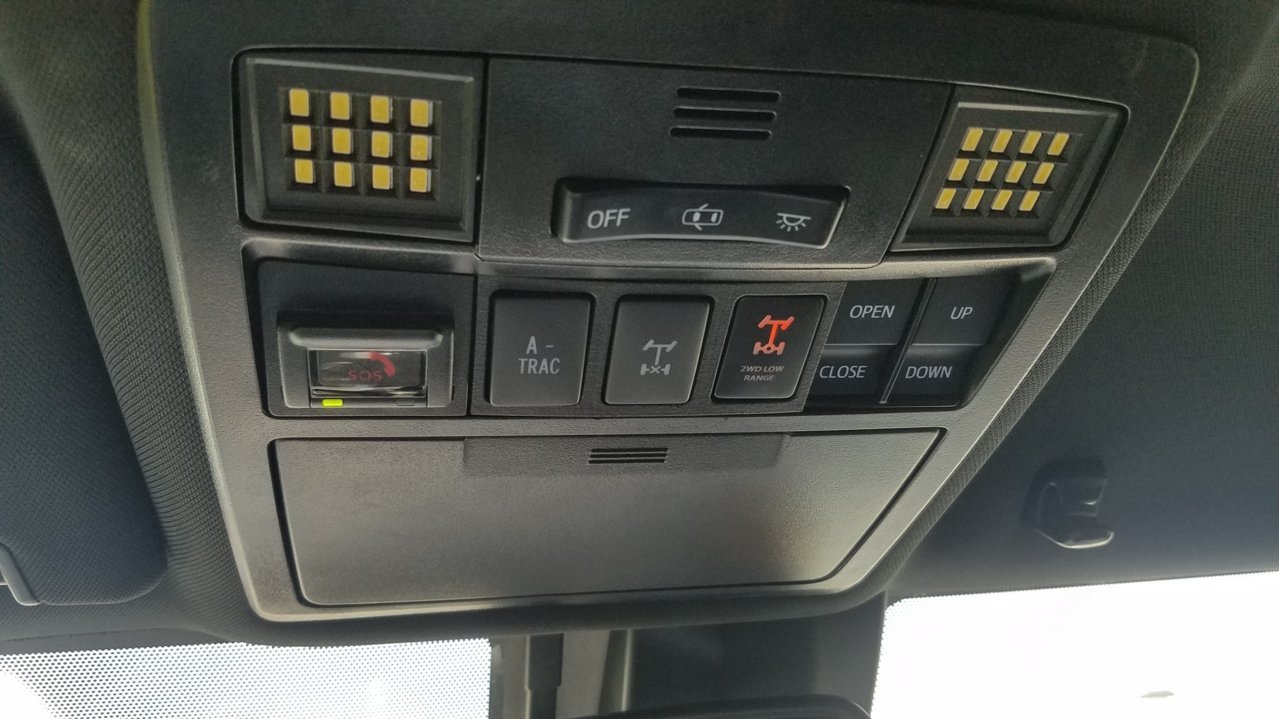

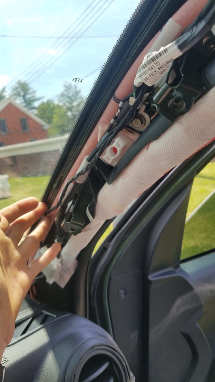

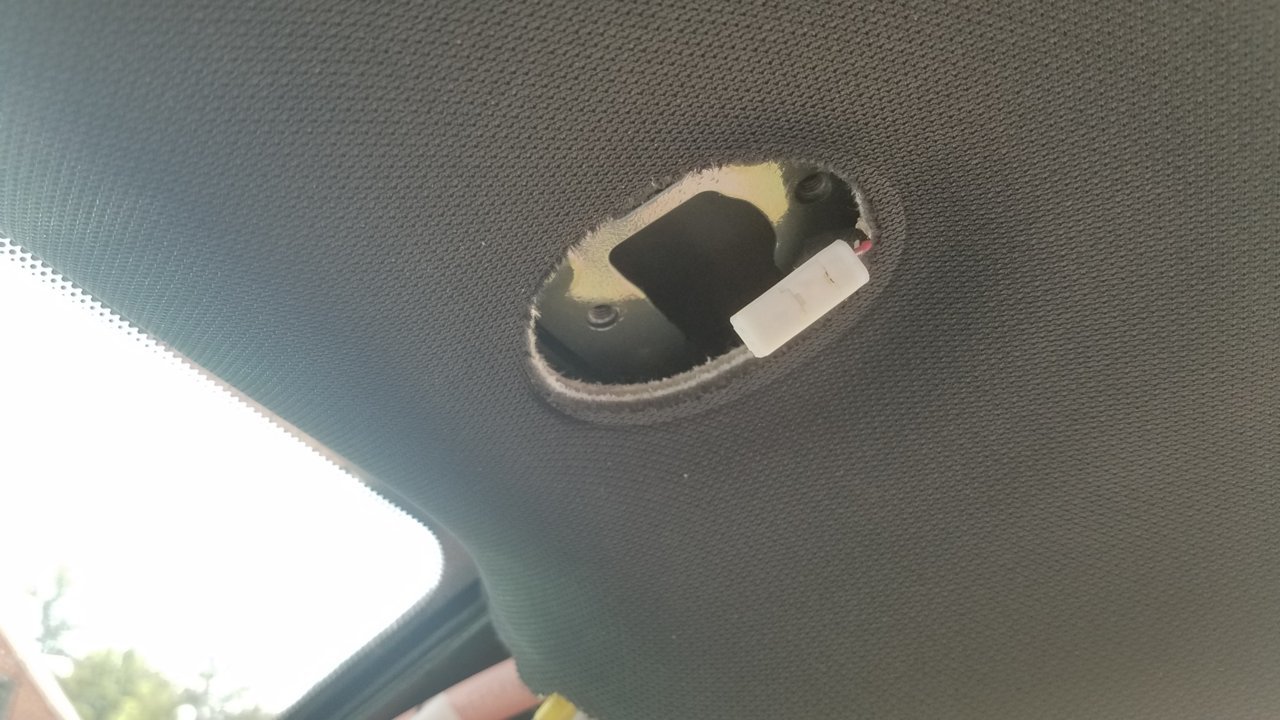

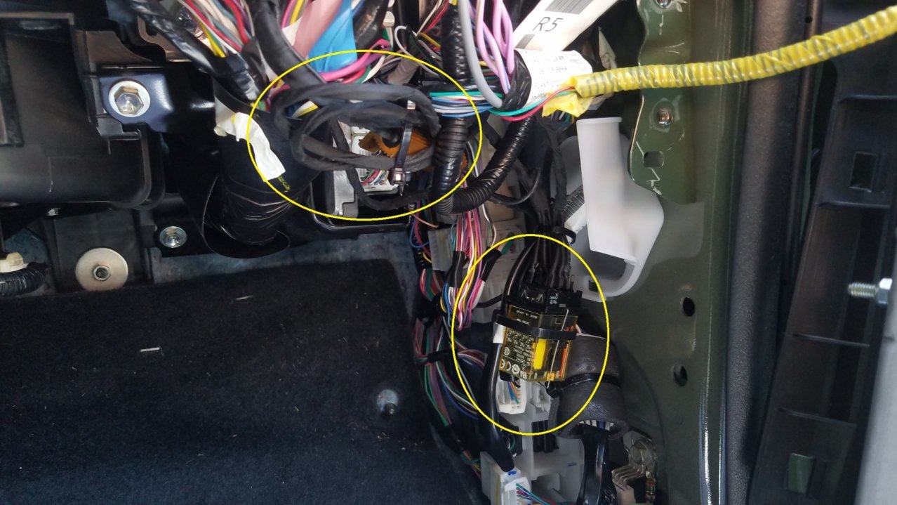

    Finally got around to installing it today (it had been sitting in my box of things for a couple months), thanks you to all y'all who did great write ups and photos!
    The hardest part was honestly pulling the air bag and figuring out how I wanted to best secure the relay and wires.
    I decided to run the the switch up to the overhead console and used a MESO switch panel to give me another blank switch spot.
    I took the sun-visor off and was able to fish the switch end through the headliner pretty easily from there.
