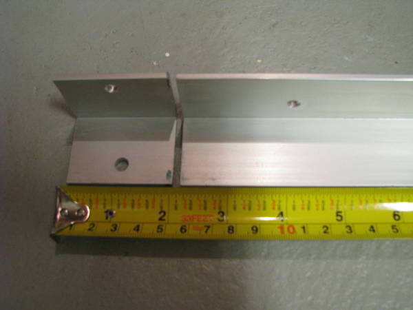

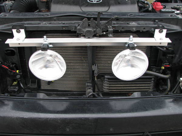

    I made a mount for my lights behind the grill it might work for you too. Buy a piece of 4' angled aluminum from Home Depot and cut a 28" length plus two more pieces to get the LEDs to the desired height.. just a thought :notsure:

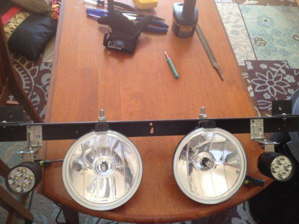

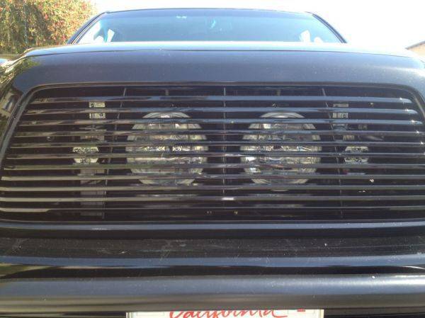

    here's what I did to mount the model 60's behind the grill w/ the hellas.

    Show is the lights lit up? How bad does the grill disperse the light?

    didn't take any pics last night, kinda forgot. The hellas are HID converted and you wouldn't even know they're behind the grill it's super bright. I've seen Aaron's first hand so I expect the LEDs to blast thru no prob.
    I'll post up later if I remember ;)

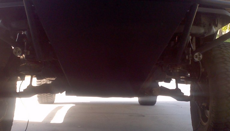

    Got the fog lights mounted but NOT hooked up... opinions or suggestions?

    mount them higher. Mine are about that level but the light gets cut off/blocked when wheeling in uneven terrain. Higher = better
