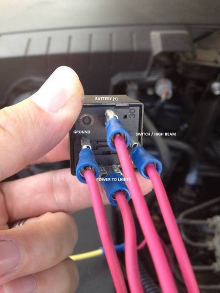

    I need help finding out what wire color is what going to the high beams. Looked on here and google, nothing for 2012 Tacoma TRD sport diagrams.
    Left side has, white w. black, purple w. black, magenta solid.
    Right side, white w. black, purple w. black, purple w. black.
    Am looking into wiring these 60's into the hi-beam circuit. Going to get a 30 amp relay from Radio Shack, SPST, and hopefully follow the directions on the relay.
    Can rebuild motors, set up ring and pinions, install any lift, make any thing waterproof, but can't design a circuit for shit, HELP PLEASE

    the relay from radio shack wont have any instructions...I've bought one from there before, it just comes in a plastic bag. The autozone had the same relay for $1 cheaper too and I think it at least listed which was positive, ground, switch, etc.
    I'm not sure which wire is the highbeam...and who knows if it changed in 2012 :notsure:
    this pic I took of the relay I'm using to power my model 60 LEDs. I have them running off a switch instead of high beams but I'm pretty sure you'd splice the high beam on/off into that terminal.

    Cool, that's beautiful, thanks.
