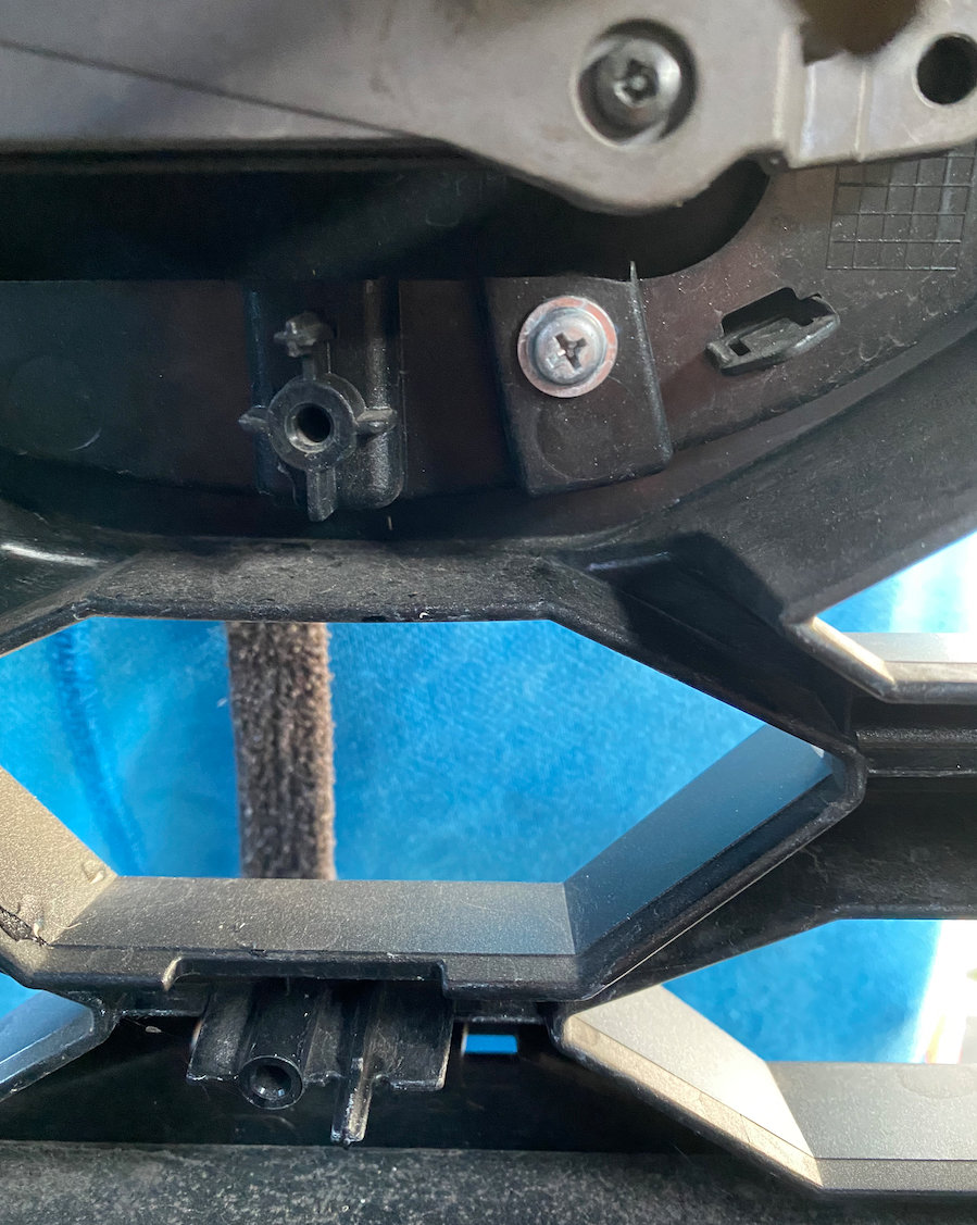

    on the 2020 trd offroads there are 2 screw holes for the oem camera bracket under the tss/emblem, not sure if that's the same for other models.

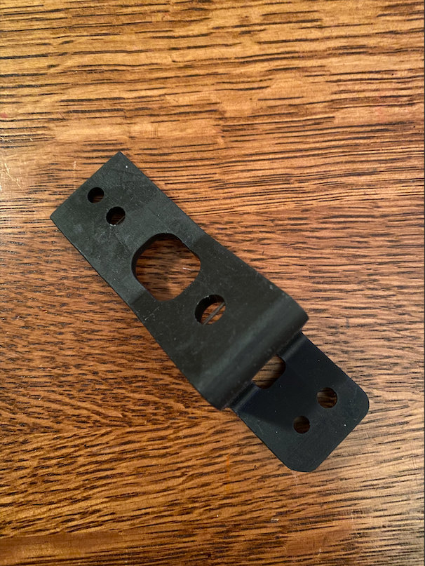

    i bought this bracket for the front camera from taco garage: Taco Garage bracket.jpg

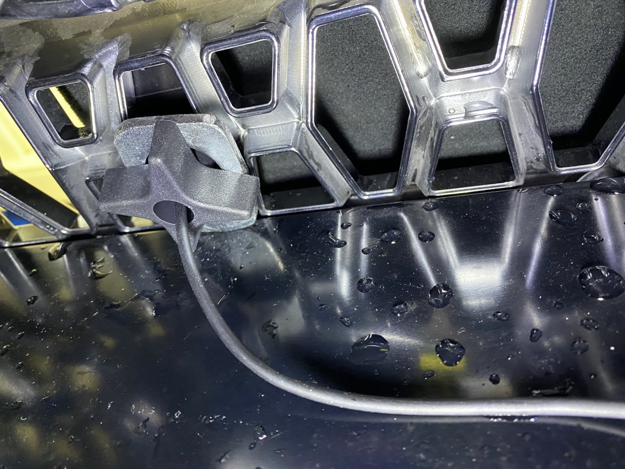

    Got my kit today. Need to come with a way to mount the camera. The shank on the camera is not long enough for the depth of the grille. If it was only 1/2” longer.

    I ran into the same problem. I bought the bracket from Yotaleds and thought I was home free. Guess I need to make a trip to Home Depot to look for one of those nuts. If the shank on the camera was just a little longer that bracket would have worked great.

    Thanks for your idea of mounting the front camera. I went to the hardware store and for a 1.89 I pickup up the knob and used a washer just to make the mounting a little more solid.
    I probably would have spent days figuring a way to mount the camera if I did not see your post. The pictures was a real help.

    welcome glad I could help out.
    I tinkered unsuccessfully for about an hour before finding that knob to try.
    I was very frustrated that the plate I purchased was essentially no good due to the depth of the grill.
    Did you use any thread locker or anything to keep it from backing off? maybe a dab of silicone on the washer, thread locker might be too strong on the camera threads.

    Yea, I used a small amount of thread locker. I had to be sure I did not tighten it down too much, I was afraid of cracking the grill. I mounted the camera below the emblem. Once I have it wired up I can determine which is the better location for me, above or below the emblem.

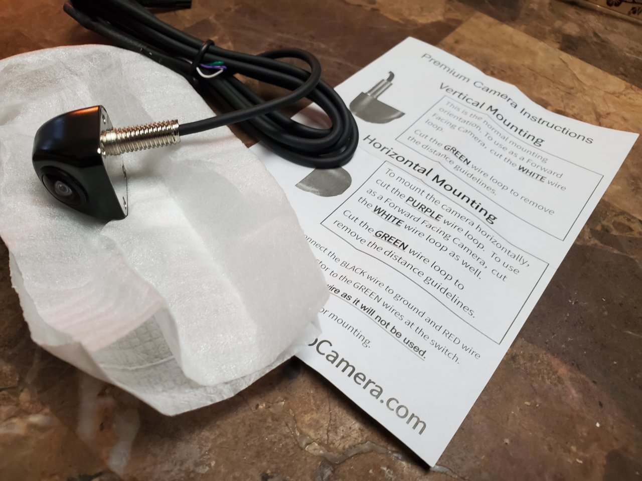

    Thank you OP, just received my standard camera kit :thumbsup:
    Now the fun of installing. Quick question yall, I ordered the standard camera kit, even the packaging label, says so but in my kit it has a premium camera instructions and the camera has a chrome threaded nipple............. Did I bonus out or its just the standard camera
