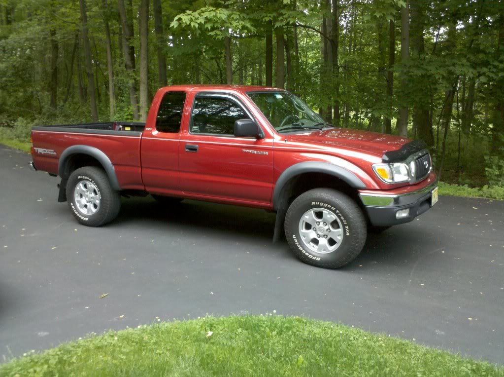

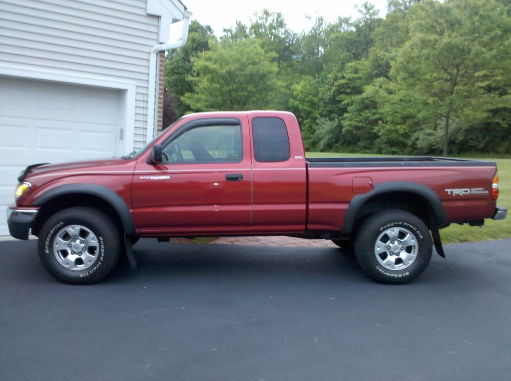

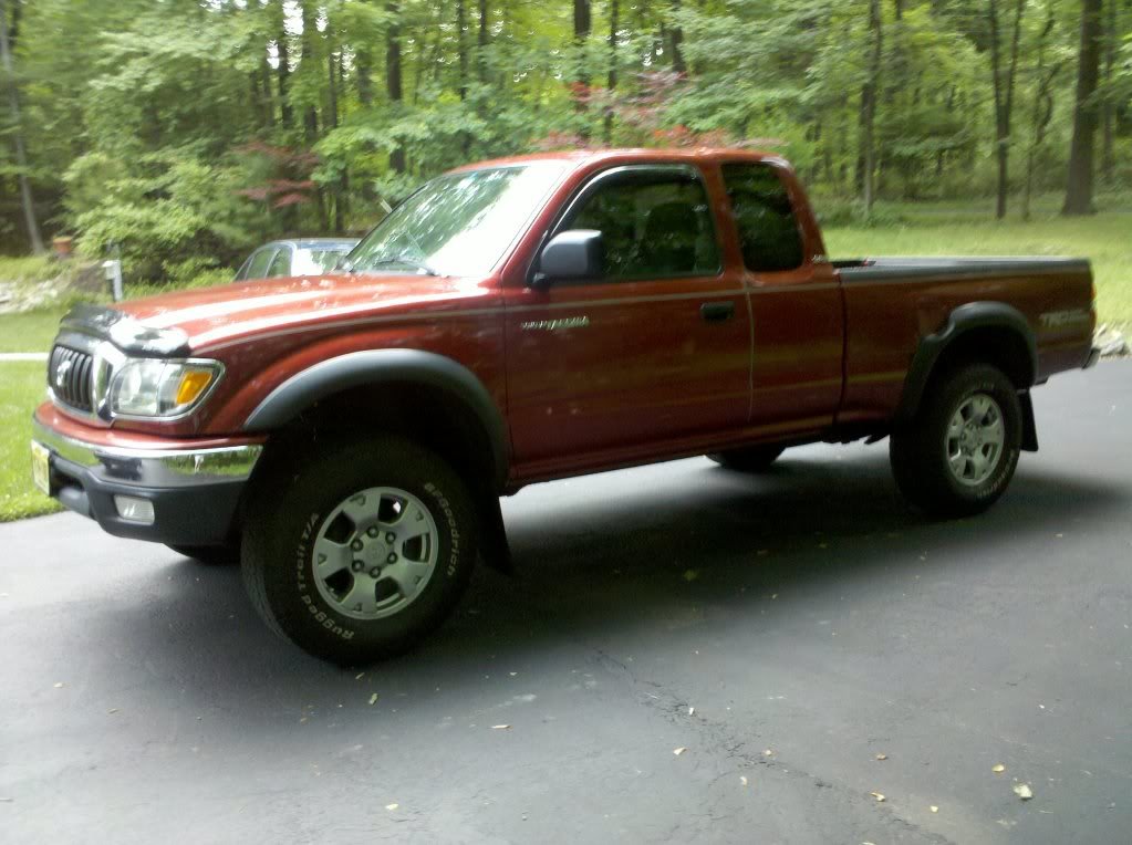

    140k miles. Coils are stock, 5100s at mid setting, ride is amazing.
    Truck 100% stock when I bought it:
    Stock front with new rear 4 pack:
    Stock coils, 5100s set at 1.25" with new rear 4 pack:

    It would have looked better with a 5 pack in the rear but I wanted a better ride. You should put those coils on ebay and use the stock coils, or else I would imagine you will be level like my truck is. I like the rake look but I needed the front higher to compensate for the plow. The front is still really soft but yet very responsive, I think with those thicker coils its gonna ride harder.
