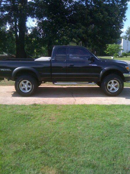

    gettin everything put on right now.
    pics later....

    OK boys and girl....
    Heres my measurements--
    BEFORE:
    DR front - 36 1/4
    Pass front - 36 1/2
    DR rear - 37
    pass rear - 37
    AFTER:
    DR front - 38 3/4
    Pass front - 38 3/4
    DR rear - 38 1/2
    pass rear - 38 1/2
