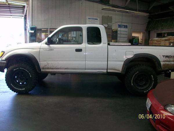

    All right guys i installed my new 5-pack yesterday and this is how she looks:
    measurements
    Before
    LR 38" RR 38-1/2" at the fender
    20" at the tow hitch
    After
    LR 39-3/4" RR 39-3/4"
    22" at the tow hitch
    down side is now i need rear shocks, the procomp shock are no longer long enough i have about an inch of down travel left on the shock it measures 8" i think i need 10" rod length to get by. any recommendations??

    :drool: Nice truck. Get some 5100's for the rear, they are meant to be used with up to around 3" of lift.

    Don't forget the leafs will settle out.. but yeah, new shocks would probably be a good idea.
