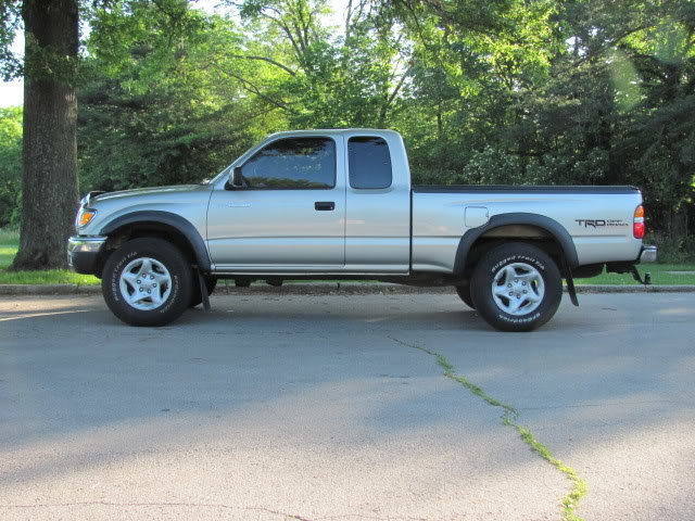

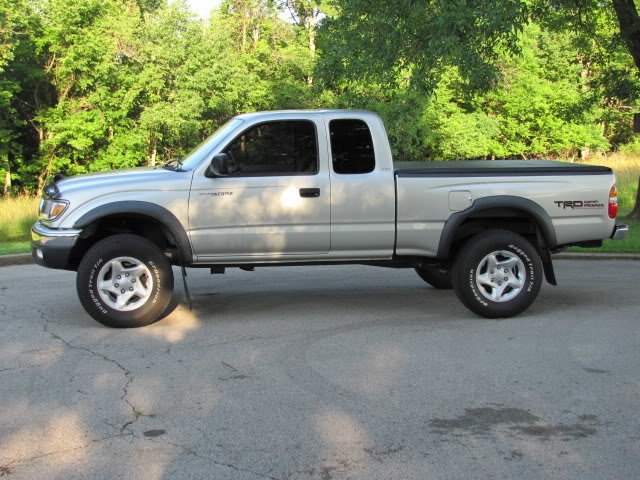

    Finally, got it done and got some pics and measurements. Thanks to Dan at Wheelers and ScoCar for setting up the leaf group buy which got this whole process started.
    Started with a 2001 Xtra Cab 4x4 v6 TRD Tacoma, all factory suspension with 85k. I don't think it led a hard life previous to me recently picking it up, but the leafs and shocks were tired.
    I picked up the 5 leaf pack, 881 OME coils and Bilstein 5100's all around. I also picked up the brake proportioning valve bracket, exhaust drop bracket and new U bolts. I did purchase the diff drop kit, but ended up having no need for it. Although it drove smooth after the install, I still had an alignment done. Retorqued everything after 200 miles.
    I also added new ProComp 1069 wheels, Michelin LTX tires, 265-75/16 and new lug nuts, lug locks.
    The only issues I had: had to cut the rear leaf front hanger bolts and Ubolts off as it was easier than to deal with the corrosion. On the ProComp wheels, I had to do some modification of the center caps to fit; they just didn't want to fit over the factory Toyota hub ridge.
    I didn't want a full 3" lift, somewhere between 1.5-2" is what I wanted and it worked out exactly as expected.
    Measurements are from the ground to the middle-bottom of the factory TRD flares:
    Initial dimensions:
    Front Right 35 1/8"
    Front Left 35"
    Rear Right 36"
    Rear Left 35 5/8"
    Dimension after lift, but with original wheels after 100 miles
    Front Right 37 1/4"
    Front Left 37"
    Rear Right 37 3/4"
    Rear Left 37 1/2"
    Dimension after lift and new tires and wheels
    Front Right 37 5/8"
    Front Left 37 1/2"
    Rear Right 38 1/8
    Rear Left 37 7/8"

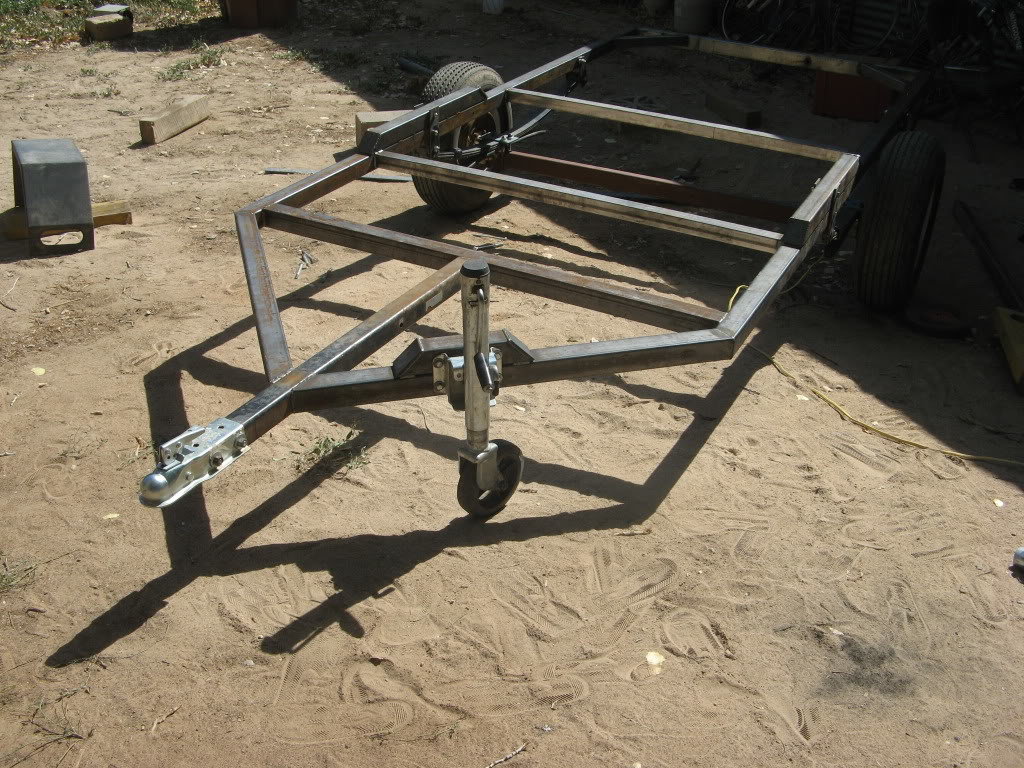

    Look where my old leafs are being re-used!
    Jet ski trailer! haha. Im glad I saved them because they are going to be perfect for the weight of 2 stand up jet skis.
