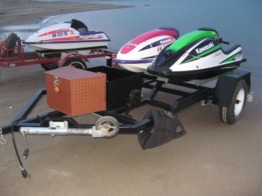

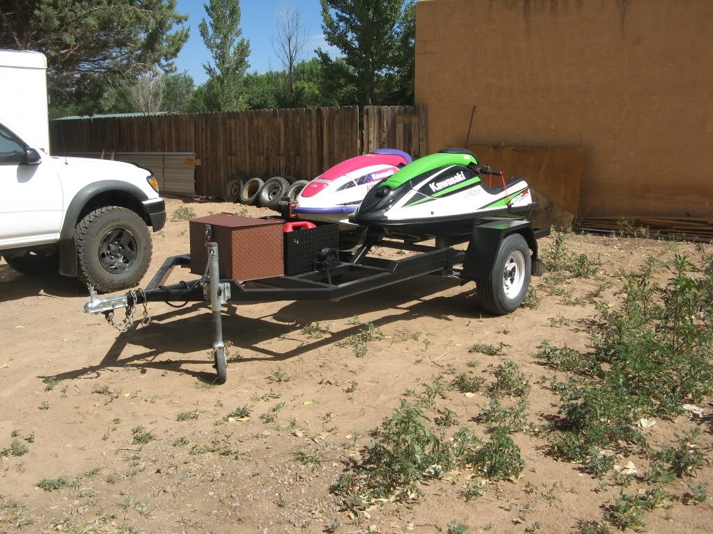

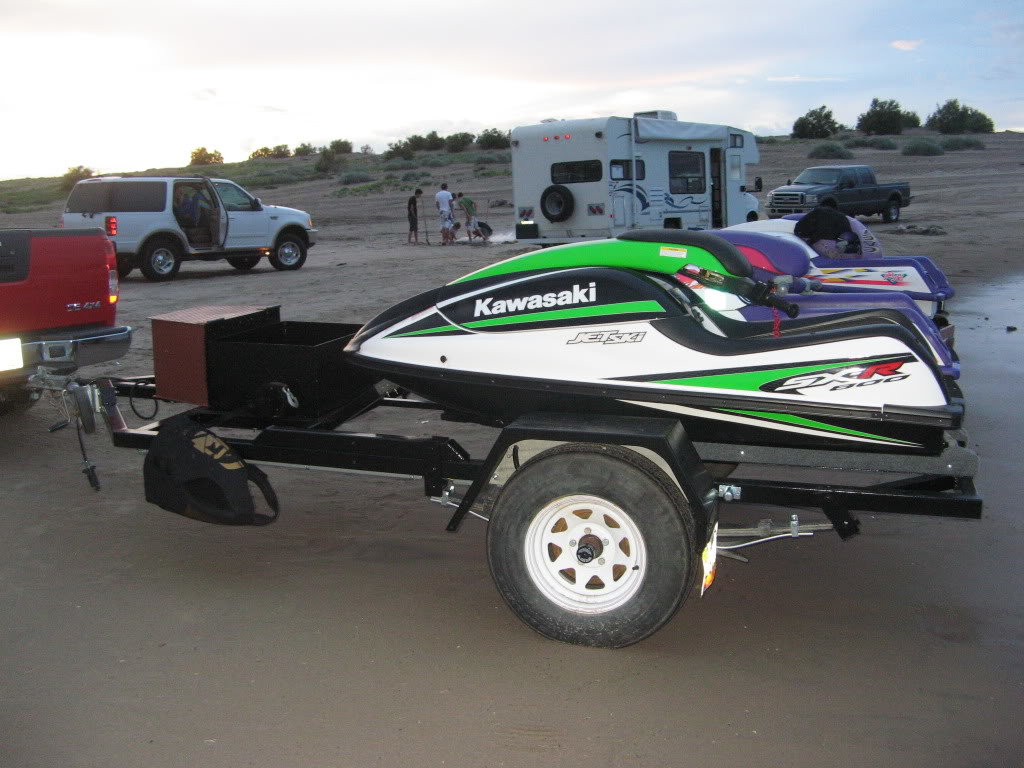

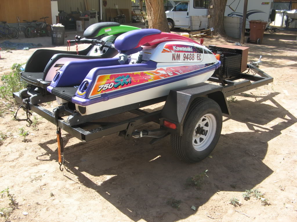

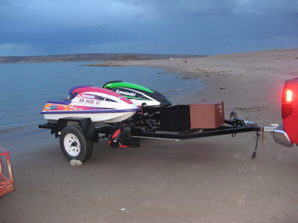

    Trailer has been done for a little over a month now. Its even registered!:D I ended up flipping the overload leafs because they were way to weak to support the weight of the skis.
    We took it down to the lake (about 300 mile round trip) about a month ago and it did great, tracks perfectly straight.
    I still had the terrible helper springs on their for the lake trip, they were bent pretty good on the drivers side by the time we got home lol.
    Back home. You can see how much the drives side is sagging in this pic:
    Now thats what I call a thread jack!:D

    Nice on the trailer... :)
