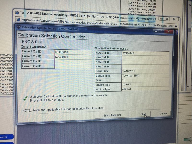

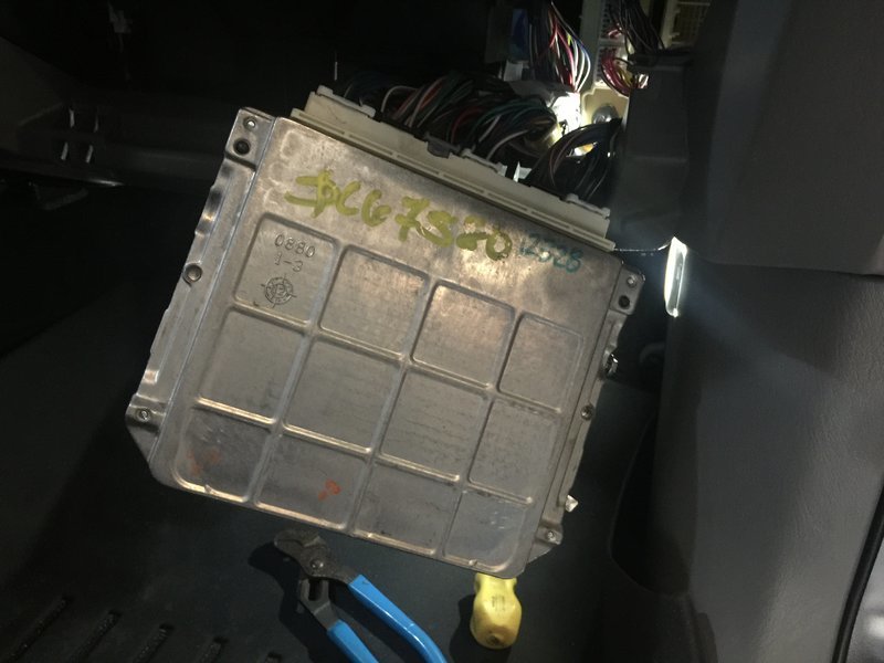

    Junk yard ECU.
    Supercharger flash available.

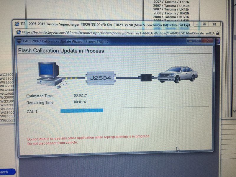

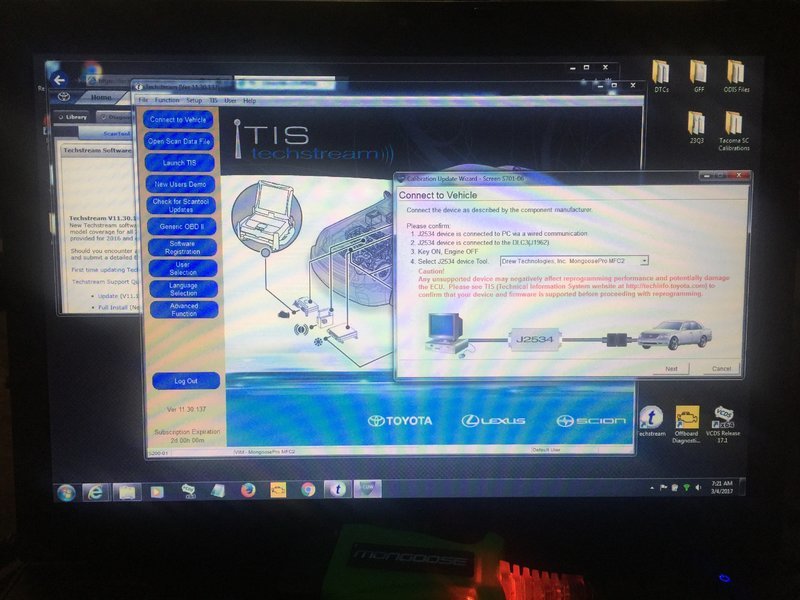

    Everything worked great. My truck is now officially running the TRD flash. I was also able to re-write my VIN into the used ECU.

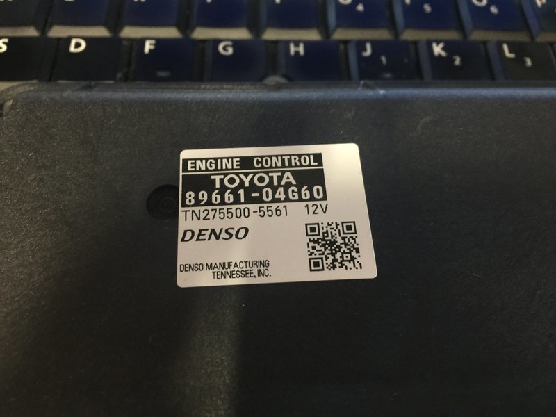

    What's the part number for the ECM? I found 89661-04G60 on ebay. Is that the same as yours?

    Yes, that is the number I removed and the number I installed. 89661-04G60 or 89661-04G61 are for 2013 or 2014 AT 4.0.
