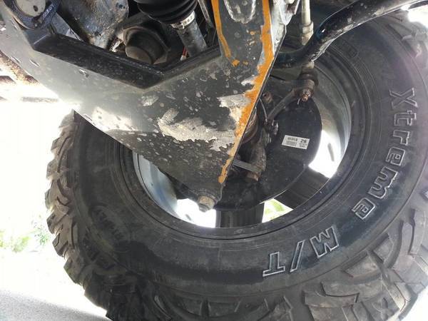

    a pic of my lsk stock length lowers after getting bounced off a few rocks(no damage whatsoever) [​IMG] ill get some more pics of the lca's for ya
    and as far as the upper balls squeaking, i had the same problem and switched em out for the fk balls. no noise now

    Eatabullet, Nice pictures! These lower A-arms look good (scratched up, but they can take it!), and yes FK uniballs is where I need to be. LSK, now I want a set of these lower stock geometry lower a-arms. I am running a 2012 Taco 4x4 with Icon extended travel R/R rear shocks and Icon ext travel coilovers up front, Camburg UCAs.
    But which should be first: 1) gusseted spindles, or 2) Icon air limit stops for the back, or 3) LSK lower A-arms?
