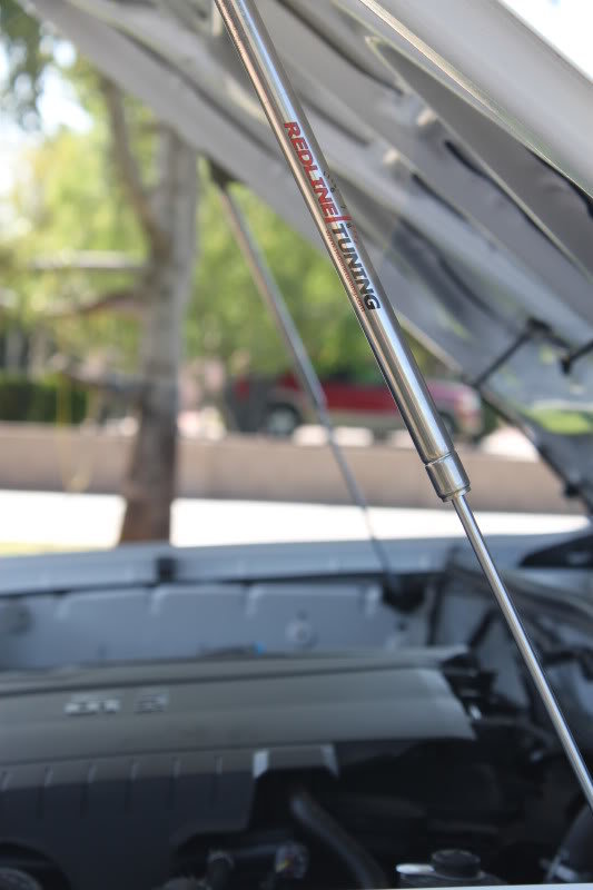

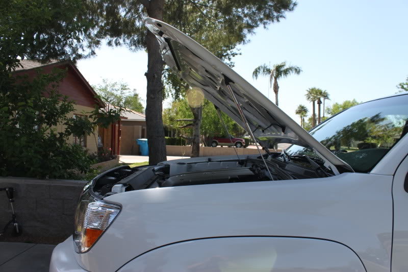

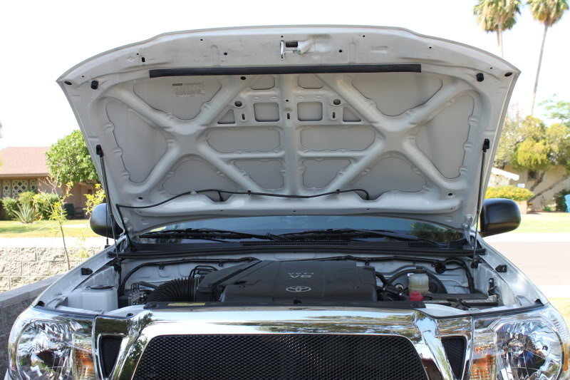

    Installed mine today!

    lookin good. the stainless steel look better than i expected.

    Really likin those in the pics above..........maybe next GB:D

    You were the first to post and you also posted the clearest pictures of how the install should look. I find your pictures to be more clear than the ones that came with the installation instructions. Thanks!

    The stainless look great. Can't wait until I get mine they are probably in my mailbox right now. Stupid post office hours..... :(

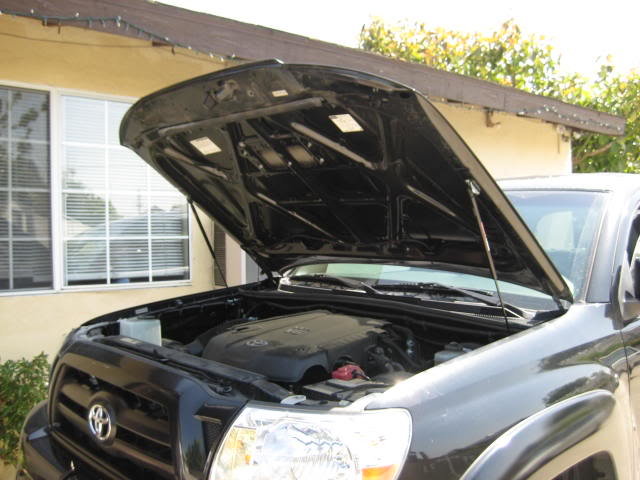

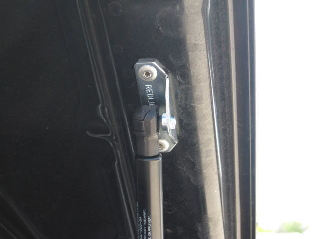

    Had this saturday off so thought i'd go install my redlines. I got the basic. Kinda wish i took the time to paint my brackets. Oh well.
    followed instructions. all together it took me about 2 hrs. only because i was procrastinating about drilling into my truck. haha.

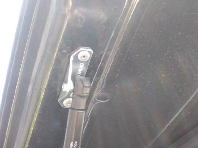

    Here are the hood brackets. attached with the supplied rivets.

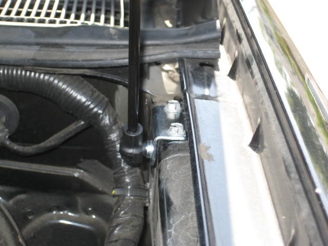

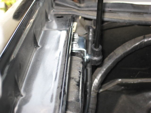

    Below are the lower brackets. the right side i had no problem with. but for some reason the left side was a pain. if you look closes at the 2 pics below, my left one is i guess too much to the left. it was hard to get my rachet on the bolts.
    All in all even with my brackets (i'm pretty sure are off by a few mm) they work great.

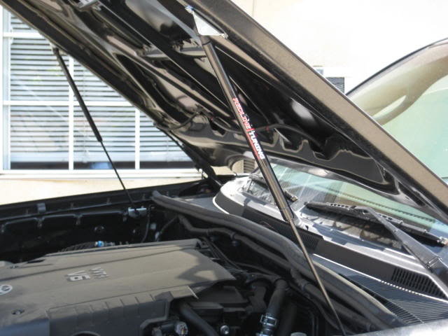

    I don't know about anyone else but i twisted my struts so that the REDline sticker shows out.
    I was not aware that the struts just snap into place. I tought they would be secured with something but i guess not.
    Also don't know about the rest of you guys but in the instructions it says to cycle the struts before install. I had a hell of a time trying to compress them as shown in the instructions. So i just installed them without doing that, and once both were attached, i just shut my hood about 10 times to cycle it that way.
    I measured it and it takes 12inches of lift before it starts to rise all the way automatically.
    I just kept opening and close my hood.....just so much fun. lol :D
