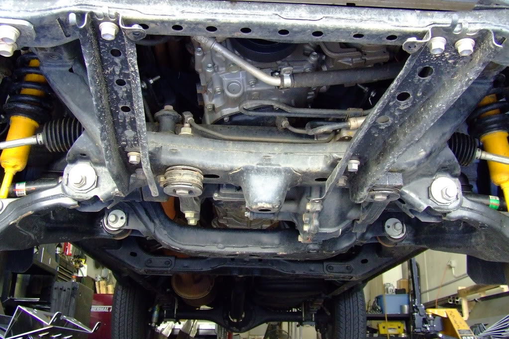

    BTW, are we removing, or bolting to these members?

    For the front skid,the two braces are removed.
    I did the usual man thing and tossed the instructions:(
    Read them only after a few minutes:)
    It is a real skid plate for sure.

    The supports are removed and four of the bolts that are removed are reused with the IFS skid.

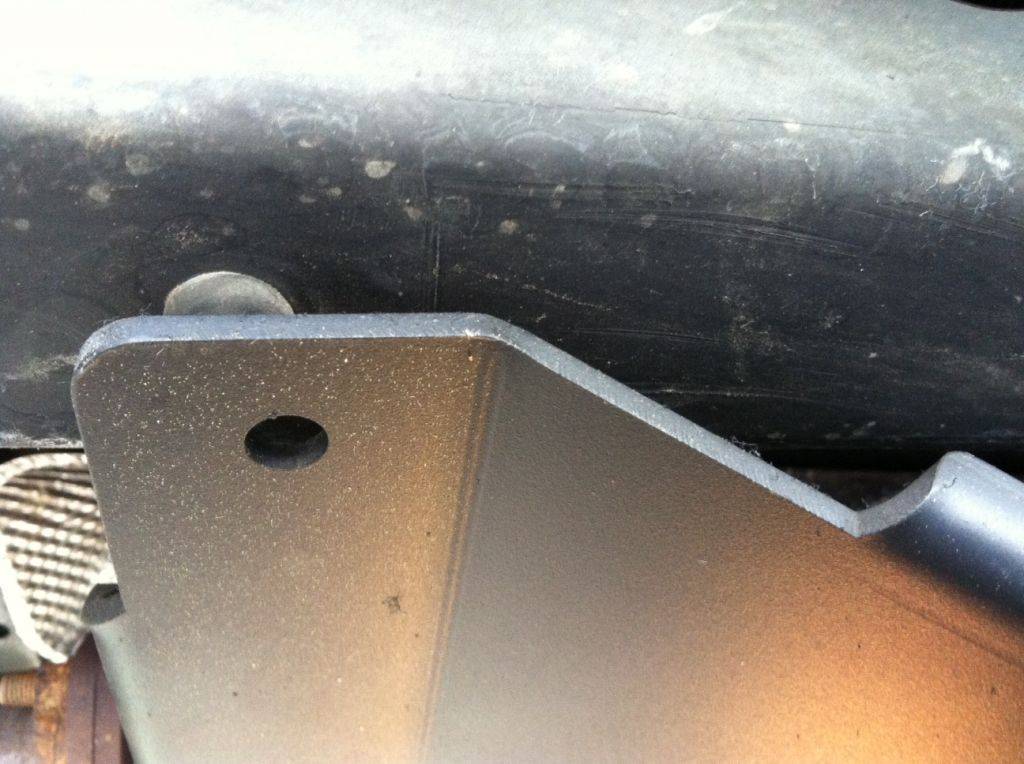

    I installed these today.
    On the regular cab, the mid-skid attachment point (where you drill the holes) lines up wrong with one of the frame rivets, like so.
    I ground off the rivet, then drilled and attached. Not sure everyone will want to do that. If the skid were 1.5" shorter, it would clear. Conversely, I can't see any reason not to grind off that rivet - all the frame plates are welded, and it would appear that the rivet is a leftover from an assembly step where the frame plates are fitted, riveted, and then welded together. Furthermore, the new bolt takes over the holding job that the rivet was previously performing.
    Also, when you're gonna drill the frame, just go down to the hardware store and pony up for the $15 cobalt drill bit. (That's the price for ONE bit, not a set.) Use oil and a low drill speed, and take breaks to keep the drill bit from getting too hot and losing its temper. If you do this, drilling the frame is still reasonably difficult, but it's no longer a swearing, sweating, cursing p@in in the @ss.
    Aside from that, no bolt hole line-up issues. (though for a few minutes I *thought* there was one. :rolleyes:)
    Anyhow, I'm quite happy with the sturdiness/strength, fit, and design.

    Yikes, first one on a reg cab. I assume you were able to make it work, the bolt will basically replace the rivet. How did everything work out with the 4banger on that particular skid with the exhaust?
    Thank you for letting me know, I will let reg cab folks know that removing that rivet is necessary.

    I ground off the rivet, and no issues with the exhaust.
