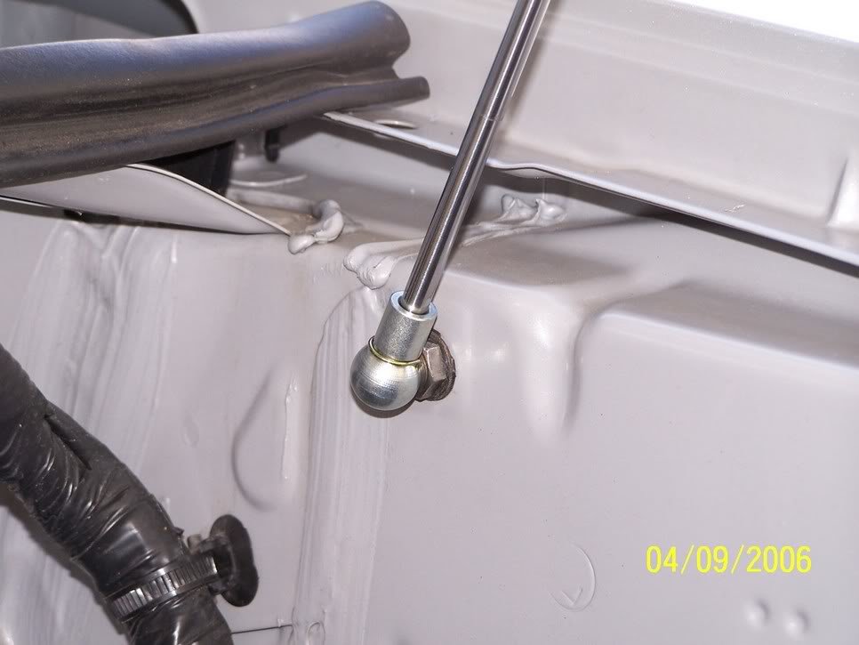

    Nice clean install.
    I was out of town last week so I just placed my order.
    Any tips on how you achieved this? Tapped hole or other additional hardware?

    I used the mounting ball/stud from an '81-'86 Celica/Supra. The Supras have lift cylinders front and back, whereas the Celica hatchbacks only have them in the back.
    If you look very closely at the inner fender, there is a raised stamped square. The redline brackets place the ball exactly there, so the placement is perfect. All I did was drill a hole, touchup the paint and install a large backing plate to take the load from the flimsy sheetmetal.
    The mounts I used are threaded to accept a nut on the backside.
    This way it looks less like a bolt on added aftermarket accessory.

    Did u have to take the plastic wheel well cover off to install the nut or is there easier way to do this?
