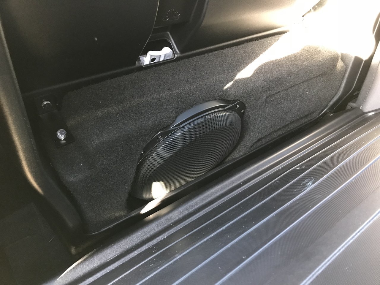

    its made to fit in the bin, does not mess w/ the seat function at all. you don't have to remove the bins or any of the plastic to make this box work.
    I can't speak to what kinda discount there might be. its gunna depend on them negotiation skills if this goes through.
    stealthbox in my truck

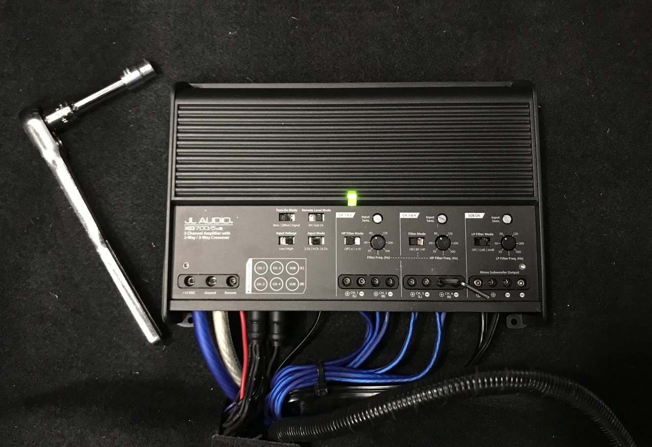

    Where did you put your amp?

    Under the driver's seat

    Got any pictures?

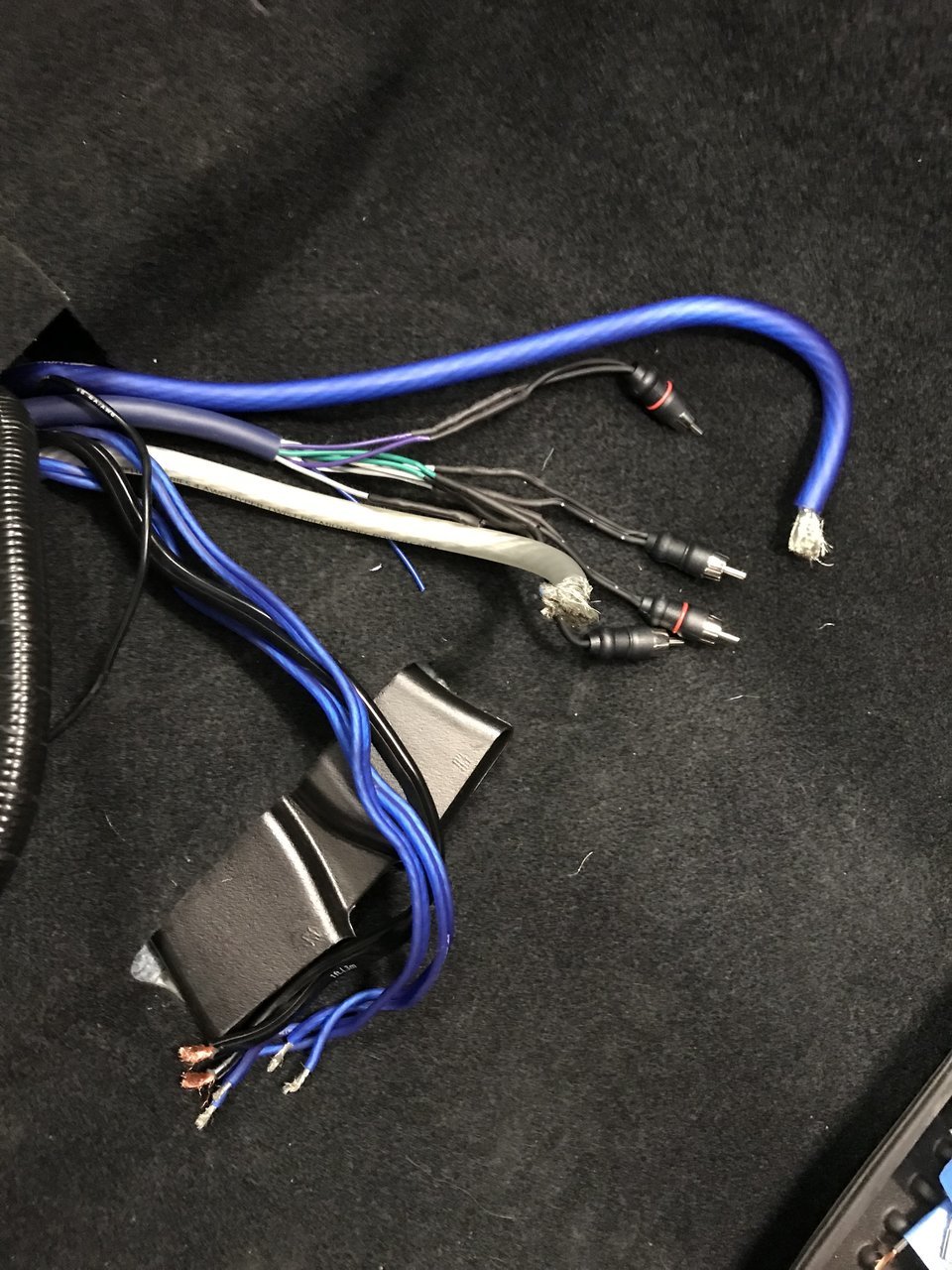

    only one w/ the drivers seat out looking down
    here is the wiring I ran through the carpet hole for the vent
    with the amp installed:

    Are you still happy with the XD700/5? It pushes the sub enough? I am trying to decide between that amp and the hd900/5. Almost double the price, but pushes 100w to front and rear doors and 500 to sub. I have run new wire to doors directly. Trying to decide between 300 and 500 watts to give this sub. JL is telling me the HD900 is too much and the XD700 is a good match, but have seen some people happier giving it 500. Not sure what to do there.

    I ran a single hd900/5 in my prior taco with the 2nd gen stealthbox and focal components in the doors. I was happy with the highs but the amp had to be at it's lowest gain to properly run the sub. The jl sub is only rated at 200w to 400w continuous power and easily distorts when pushed past 400w.

    Okay, that confirms it for me. XD700 it is.
