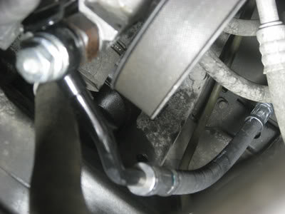

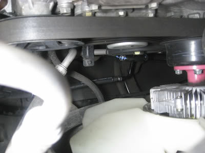

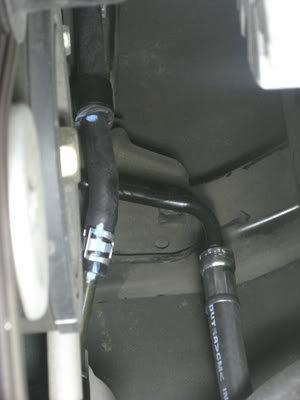

    Well I got the truck back today and I have to say the steering isn't quite as tight as it was before. There's also some "spray" on the fan housing so it definitely was leaking. It must have been just enough to slowly degrade steering to the point I didn't notice it. $300 though for a "hose". I attached photos for those that aren't sure what line exactly it was. The first photo is the connection to the power steering pump on the passenger side of the engine compartment. The line then goes down and all the way across the lower part of the engine as shown in photo 2. Metal in some places and rubber in other. Photo 3 is where it ultimately connects. Looks like they have to replace the entire line when something like this happens instead of just the section that's leaking. I guess that would be the smart thing to do anyway. Makes me wonder though how protected this line is should you be on a rock/pebble road and have crap fly in from under the truck.

    Wow, that isn't good news. Those pics scare me because they look like the exact same type of lines I had on my old Chevy S10 for the remote mount oil filter and the oil cooler. They were a very common failure item, always leaking at the junction between the metal and rubber parts. Usually they start with a slow leak but there were many instances of catastrophic failures. $500 seems pretty exorbitant for this repair, IMHO. Damn, I thought I'd left those hoses behind when I traded the S10 on my 09 Tacoma. :-(
