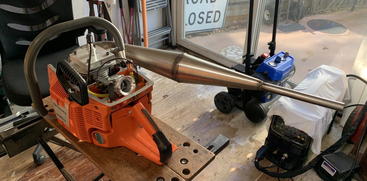

    I just recently finished building a 154cc Husqvarna/Stihl combo for Hot Saw competitions that will be buzzing 5%-10% Nitromethane. Using a 3120xp chassis with a Stihl 090 cylinder, 66mm Wiseco piston, and 3mm stroker crank.
    Initial start-up passed with no problems using Methanol. Biggest worry was the big piston clearing the case at BDC. There was very little room for error. Looking forward to the piston ring sitting and unleashing its true potential.
