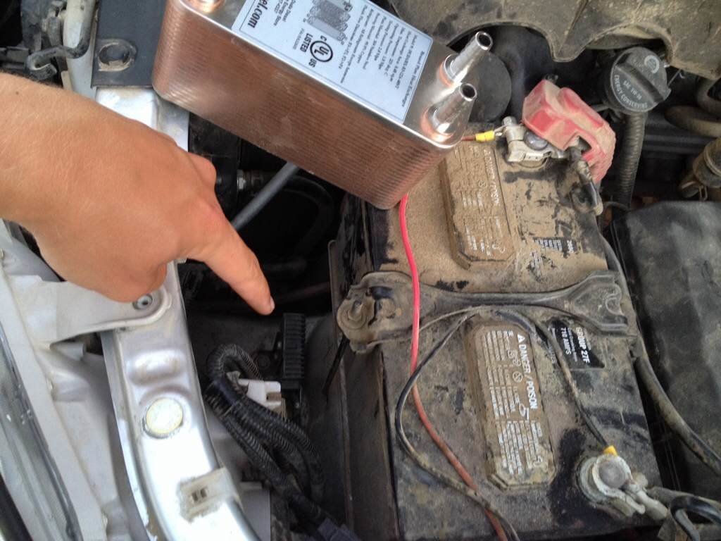

    I believe Its a grey box down in front of the battery. Unplug and take a piece of wire and jump the two pins together

    Our trucks have a 2 speed fuel pump, the resistor provides low speed via the fuel pump relay at idle and under low loads.
    I wouldn't expect it to be that since I'm pretty sure that it always starts with the pump on high speed but you can try it and see if it makes a difference, are you getting any trouble codes?
    Picture's borrowed from @Jimmyh.

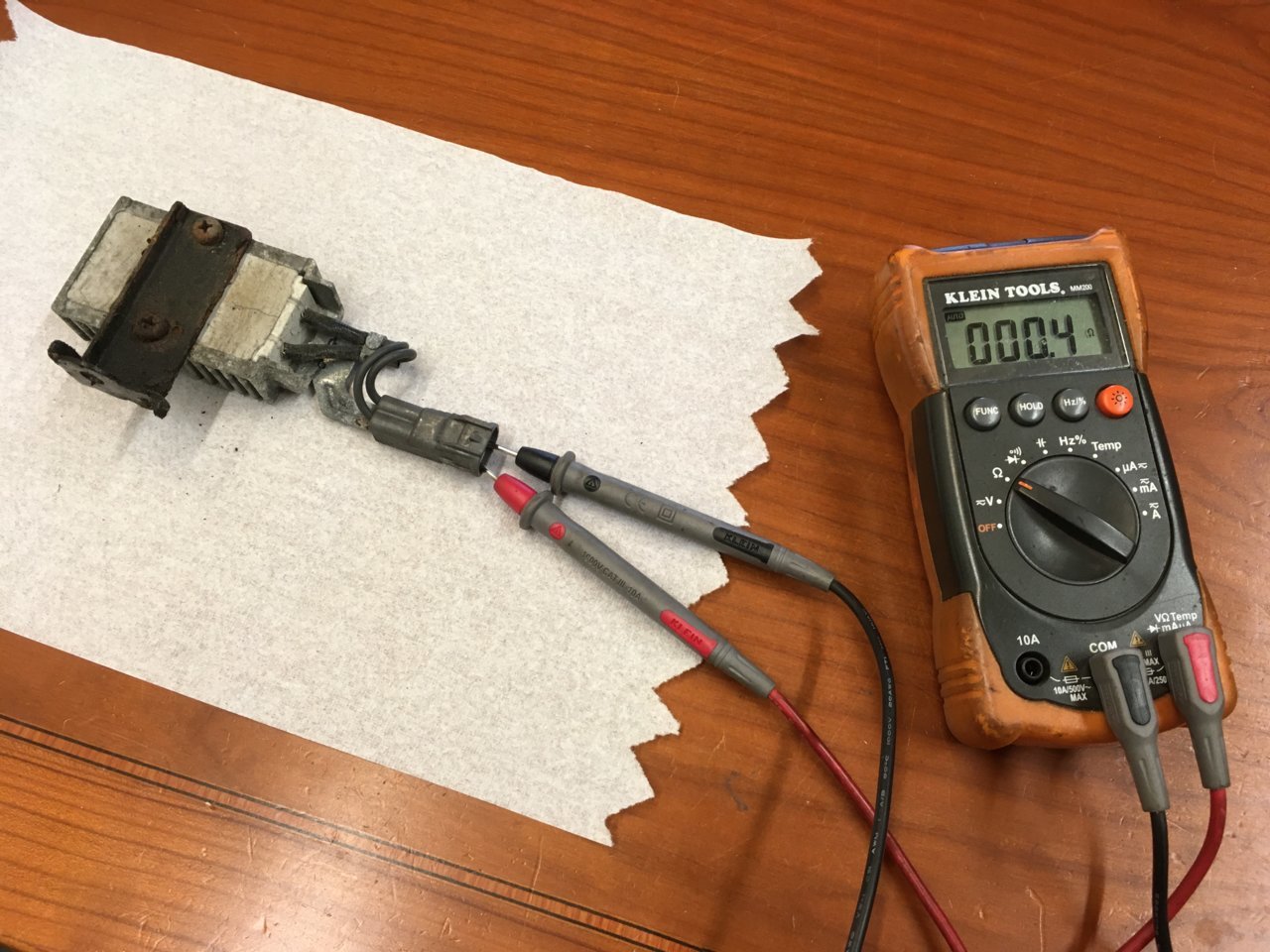

    Just tried that - no noticeable difference.
    I'll check out the fuel pump resistor now!

    Whoops, I think I wasn't waiting long enough to let the multimeter 'settle' on a resistance value. I discovered this after I picked up a new OEM fuel pump resistor today and thought it was also measuring zero. After several seconds it climbed to around .7 ohms.
    So it would seem my original resistor might actually be fine.
    Any other ideas?

    For these value of resistance, you need to take 4 wire sensing measurment (https://en.wikipedia.org/wiki/Four-terminal_sensing). I don't trust anything cheap for these low value. The last digit can be off +- 5 (or more) and you add a % error over that. They only say Basic DC accuracy ±0.5% error on the site for your mm200, this is mostly useless since they don't say which range this is true (and they will probably write the best lab result they can do in a controlled enviroment @ 25c).
    .2 ohm difference is alot at these small value.
    12v @ 0.7 ohm is 17.14 amp.
    12v @ 0.5 ohm is 24 amp.
    V = I * R
    Like you did trying a new resistor is a good idea but if you have corroded wire or a bad connection on the path this can affect the performance greatly. If you can measure the real resistance with a good meter and measure the voltage between the 2 pin of the resitance when the pump is working you can calculate the current flowing in the circuit. You will know if the pump work correctly. The "bad wire" will add resistance on the circuit and this will lower the current flowing in the path.

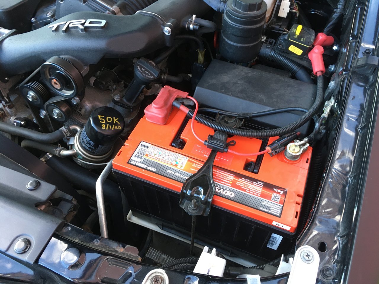

    Brand new Odyssey 27F battery installed. A good 13lbs heavier than stock. Zero change in the starting hesitation.
