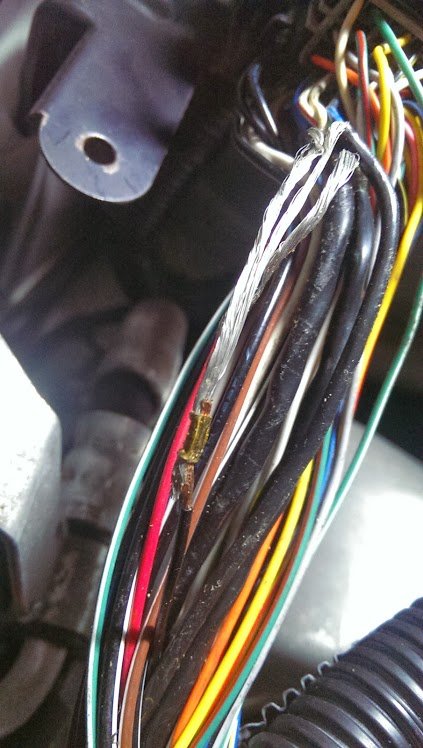

    Not that anyone cares but a couple weeks back i had a check engine light issue that was becoming a nuisance. Consistently throwing code P0300 (random misfire) and had a noticeably rough idle literally every time i started the car. I believe Corey (Monster Coma) had the same exact issue with his 2013 WRX.
    Did some research and came across a random thread in the dark depths of Google and found some info about the problem. In this wiring harness is a ground wire which branches off into 4 separate exposed wires...Like so:
    Not my picture
    23864d1382935212-13-wrx-misfire-issue-st_e07e5948d041645736134e0e46b1243fff50be58.jpg
    Dropped a big glob of solder onto where the wires branch off from eachother and the check engine light/rough idle has been completely gone ever since.
    Now that i've shared all this worthless Subaru information on a Toyota forum...i guess moral of the story is that electrical gremlins are dirty little bastards.
    This stupid little 20 minute fix saved me a 2 hour drive to the nearest Subaru dealership and the additional headache that comes with going to a car dealership...so that was pretty cool.

    Hmm, that makes no sense to me.... Haha

    So a single ground wire splits up into four separate pieces of wire that just sit there exposed?

    Well they are raveled up in a few layers of electrical tape. But once the tape is off then yes they are exposed. I though that was a little hokey. That entire harness is inside of a chunk of wire loom which is then covered in an ungodly amount of electrical tape. That picture is with all the tape/loom/ect taken off.
