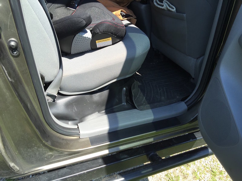

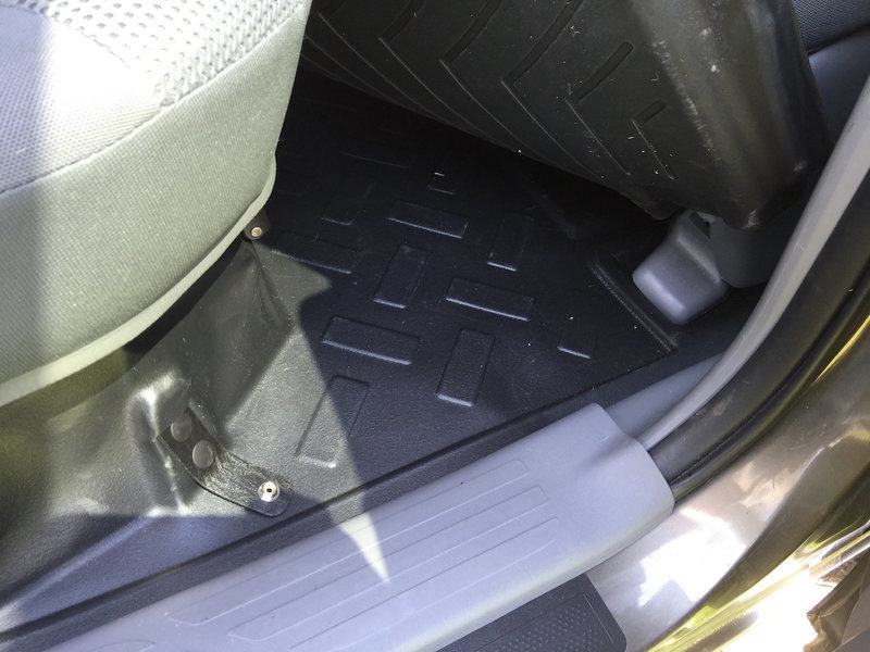

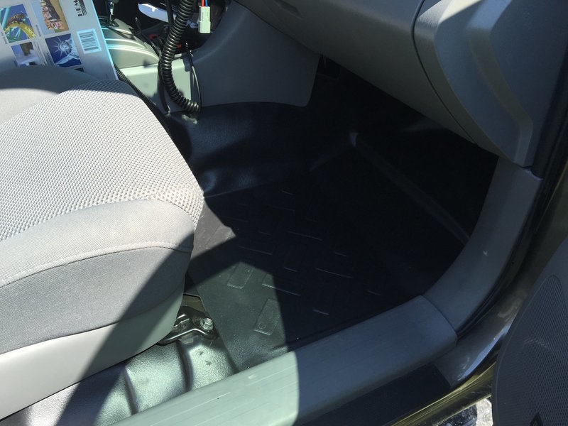

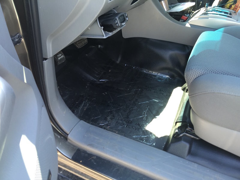

    Decided to pull out the useless black boxes behind the rear seats for good this time to make room for my soon to arrive @docloco MOLLE panel. While I was back there I checked to see how my five year old sound dampening install looked and everything was perfect. @HIYota told me that he was going to swing by later in the day so I got agressive and tore out the factory interior to make room for the all weather floor that I had waiting to be installed.
    While I was working on getting the last of the interior out I went ahead and laid the new all weather floor out in the sun in the hopes that it would heat up a bit and be a bit easier to fit to all the factory contours. In retrospect, it probably wasn't really necessary as it fit perfectly.
    Note: The floor mat hold down grommets and tabs are not installed on the all weather floor. I dropped my old weathertech mats in on top of it just to help keep things clean-ish in the cab.
    Protip: When installing the new floor make certain that your accelerator pedal is not under it. We had everything buttoned up and I was ready to pull the truck out of the shop and when I hit the ignition, the tach bounced off of the rev limiter twice before I could get it shut back down again with both of us making the "That's Not Right" face. I immediately knew what I had done wrong and we quickly rectified it after being startled, we both had a good laugh at the situation.
    The part name on the label is "carpet assy, floor" which is confusing when trying to order but it does check out. For those that missed the part number the first time I posted it here you go.
    Toyota part # 58510-04870-B2
  4. Apr 2, 2016 at 5:32 PM
