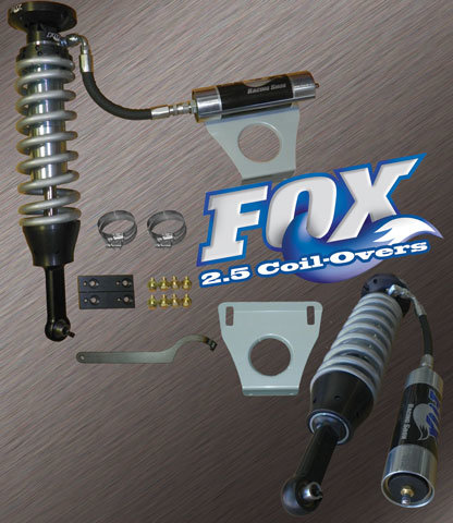

    Hey Micah @Downsouth Motorsports, these bumps and lowers are wicked! Thank you sir.
    Time to troubleshoot as the front coil bucket gusset makes it really difficult to put the remote reservoir on top of the frame horn and still be able to use the clickers. Might have to take a little out of the front lip on that gusset.

    How does Fox mount the RR up?
    This is bringing back memories from a long night when we did mine.

    Older picture but brackets are nearly identical. The bracket bolts in using the swaybar bolts under the frame horn and then pushes it up. We can get it up there without a problem, but it's nearly impossible to cycle the clickers due to the gussets. Solution coming soon.

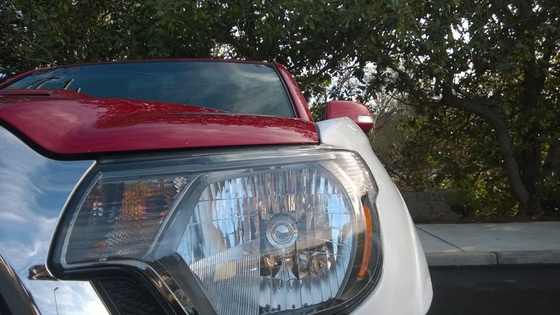

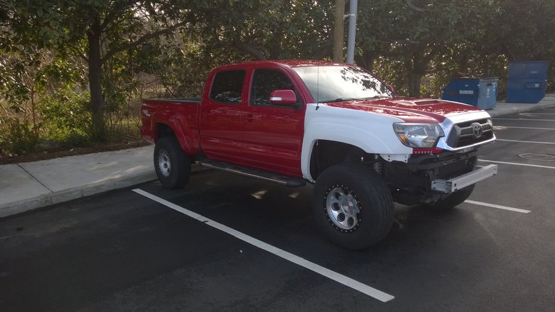

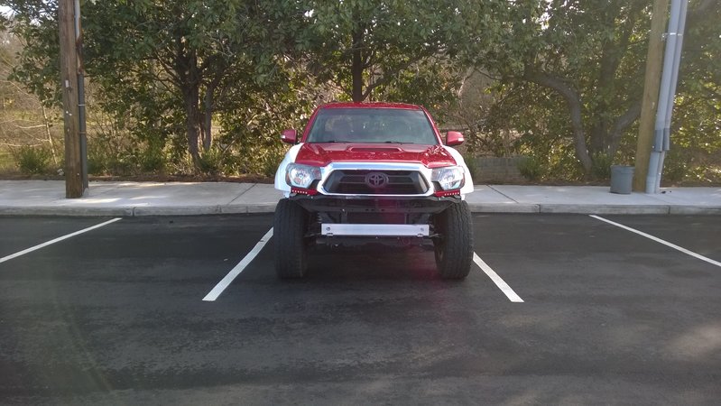

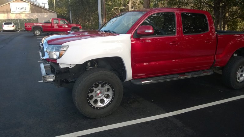

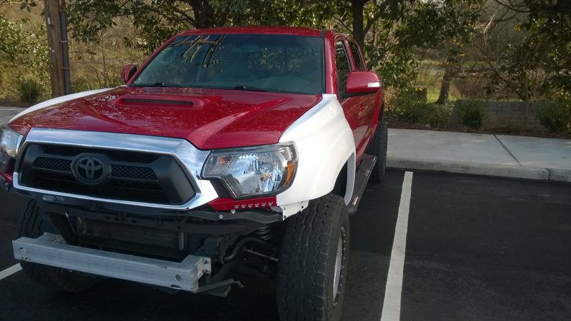

    well it was exactly a month.. but received and 8hour install.. pay no attention to the chrome grill on a TRD Sport, I have my color match, I was using it as a guide for fit.

    They look great! Hopefully mine ship today. Really anxious to get my new tires on.

    Dude they look awesome. Are they sturdy?

    About 100x more than the tin can they used to make the factory fenders. I am still playing with the fit though, it looks like they used a factory Toyota fender for the drivers side for the templet, but the passenger side is not so tight. but with a little more massaging I think they will work out great.
