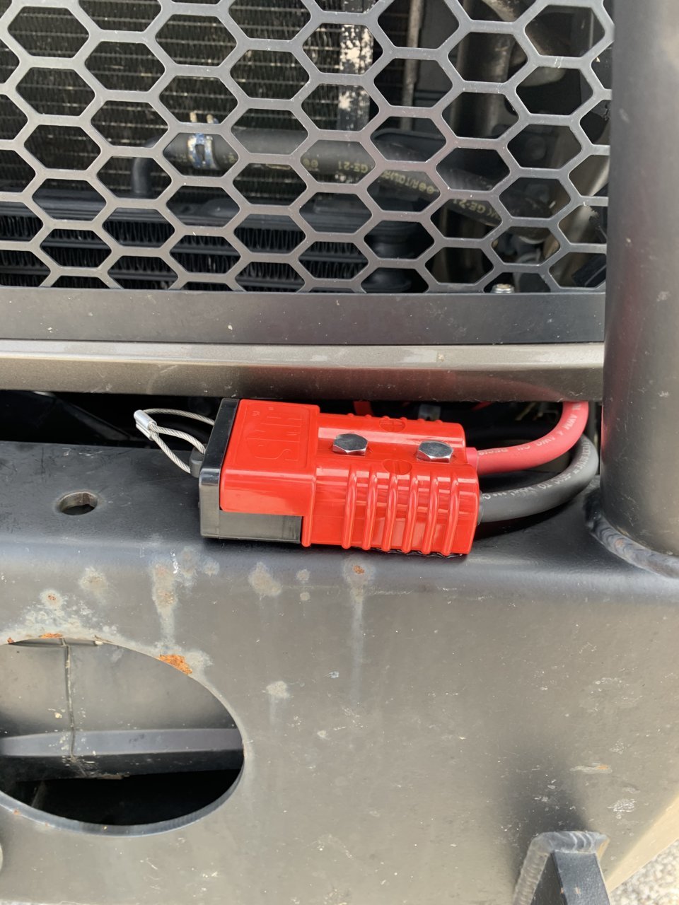

    Been dealing with long time electrical gremlins and finally sorted it. The battery side ring on the battery to chassis ground was torn. There was barely any metal left to complete the circuit and I’m thinking that is what may have led to my improper battery charging issue. Got a new 4ga wire and used it to replace the tiny factory and we are back in business.
    While there went ahead and wired in a PolarWire brand jumper cable system. Wires directly in and you plug in the leads to an Anderson type plug and use the clamps on the other end. I won’t be without jumper cables now and I have removed the fear of someone who doesn’t understand electricity fouling up the mix by trying to help me and getting it wrong. Clamp to their car, connect the Anderson plugs and we’re off.

    Ive been thinking of a similar system after seeing a AAA truck with that setup. I decided one of those jump packs worked way better and were even more stupid proof.
    G.T.[QUOTED][OP] and mcharfauros like this.

    I went with a very high quality (read: not inexpensive) prebuilt setup but I’ve used it about half a dozen times to help boost other cars and it’s convenient.
