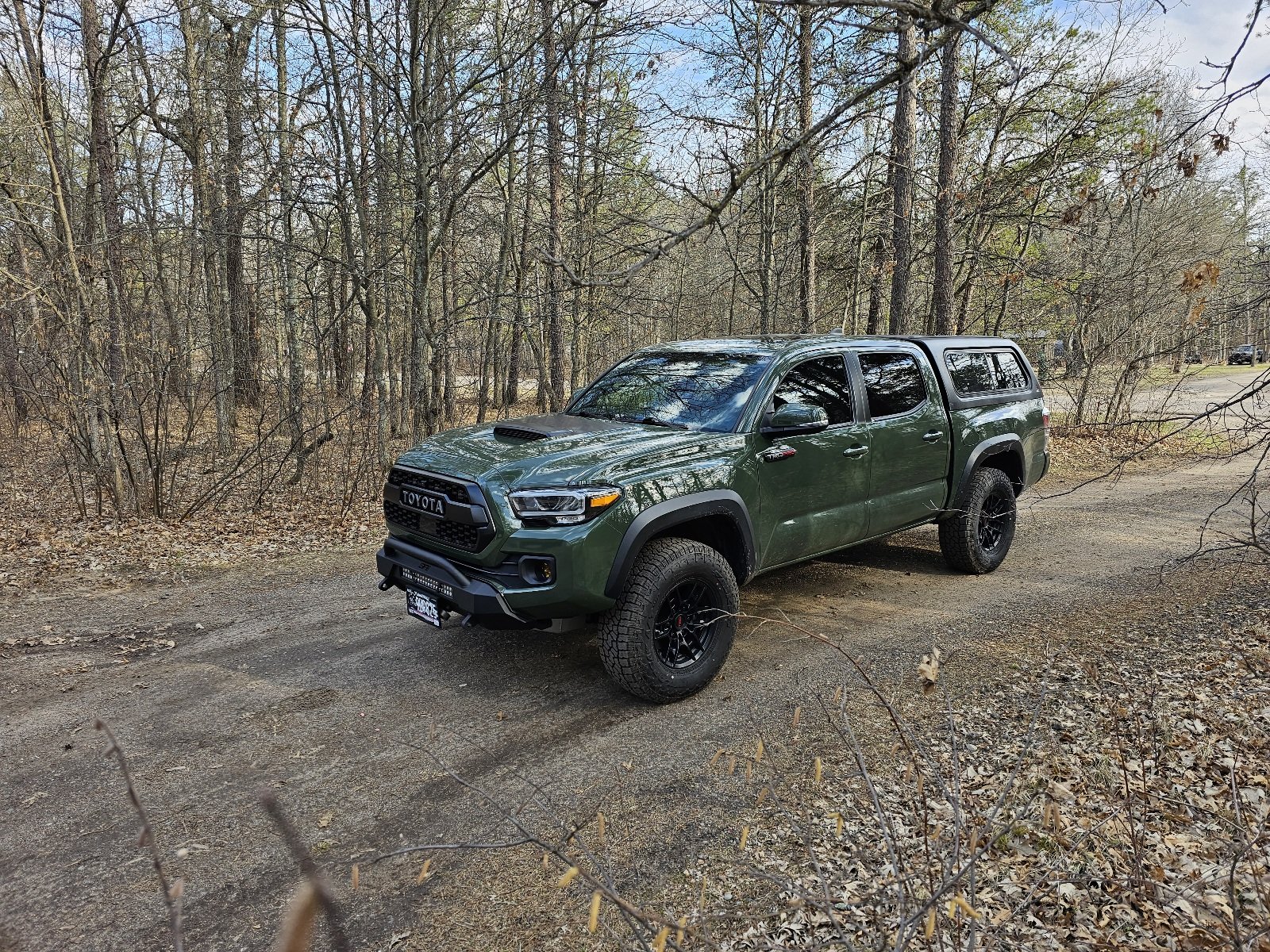

    Hi all, new here (been lurking for a bit). Names Wes. Veteran, unapologetically American, f*ck around and find out advocate. I like to do outdoors shit. Starting this thread as a central place for updates and shenanigans.
    Prior to this I had a 2016 BMW X5 diesel that I had a 1.5" lift and 30" AT3W. Great fuel economy, loads of power, unconventional for a BMW and I loved it but not a great off-road platform even though it performed well enough. Decided it was time to move on so I picked up a 202 TRD Pro. Goal is a truck capable of long distance self-supported on/off-road trips that's still a daily that can be used for work around home as well. My thoughts are while at home I'll leave the cap off and run the tonneau cover, while on solo trips I'll run the cap and sleep in the bed, while the mrs is with on trips we will drag the camper trailer. I plan to build a bed drawer system and probably leave that in all the time to help keep weight on the rear for the leaf springs and winter traction, but it's design will mean it can be easily removed if needed.
    So far I love the truck, don't love the fuel economy and lack of power. In all honesty the truck has plenty of power, it's just difficult to access due to the piss poor programming of the TCM. Looking to get a good setup ready by August as we are planning to run the WYBDR.
    I need to come up with a name for this truck. Sadly Guaco Taco is already taken.

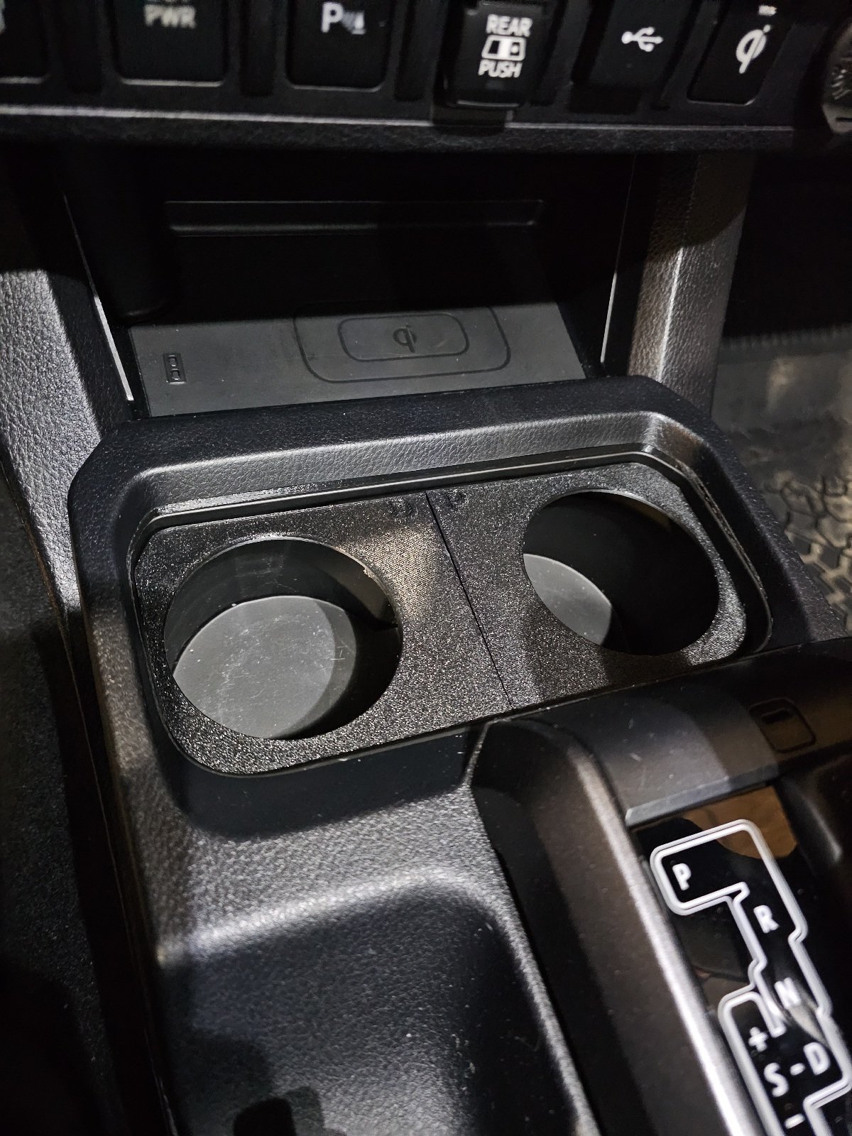

    Aye, finally got some things done. Nothing too exciting yet. Going to start planning out the drawer system soon. I first need to build a urn box for my pops who passed away in January. I've been kind of avoiding that, but it's time to get to it.
    -Hiline bumper and RC 9500lb Pro Series with synth rope
    -removed the Predator side steps

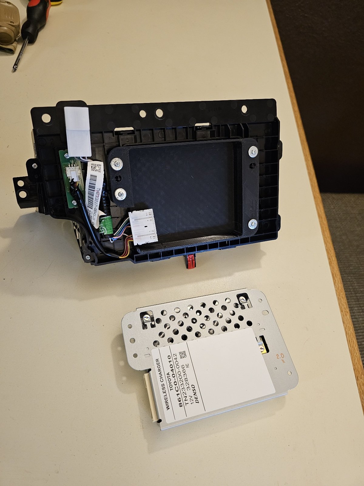

    -designed and 3d Printed a new phone mount
    -designed and 3d Printed some inserts for the Z Precision cup holder that keep my coffee thermos and red bull cans in place so they dont slide around
    -designed and 3d Printed a box to replace the QI charger, and then wired the QI button to power my wireless quadmount charger
    -replaced the Rigid fogs with some yellow DD SS3

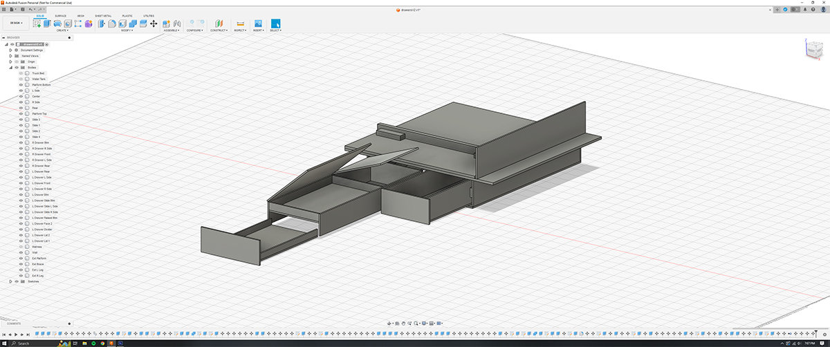

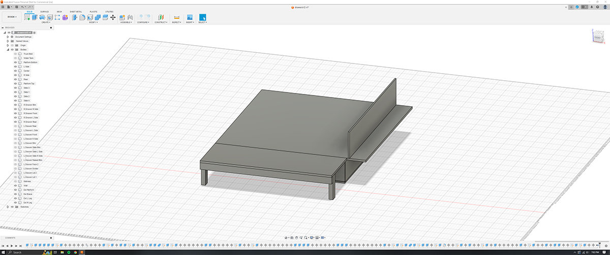

    Started drawing up the drawer platform in Fusion. Largely based off the K.A.M.P. drawers by sachou, https://www.tacomaworld.com/threads/k-a-m-p-drawers-kitchen-and-mattress-platform.703676/.
    Bed platform is wide enough for a 48" wide mattress, and since I have a 5ft bed theres a hinged ext piece. The wall on the top side will have some storage bins with doors, and also house the battery and solar controller. Also planning to run a removable 5gal water tank that just slides in the end when used.
    Sorry for the image quality, I use a 34in ultrawide monitor and scaled it down so it's not too massive.

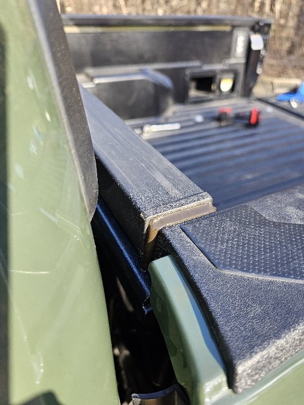

    The past couple days I worked on removing all the velcro from the BedRug that came with the truck, sealed the bed and put the cap back on.
    I still need to figure out what do do around the corners of the cap door, theres pretty big gaps where it meetst he tailgate. I think if I order a new seal kit I can trim it a little long and cover most of the gap.
    I know the side windows leak a little during a car wash, so I need to see what can be done to fix that while still allowing the windows to slide open.
    And yes, I popped off the rail caps and front top piece and sealed under those.

    Could you use foam wedges for those corners of the cap by the tailgate? I considered doing that but never did because for some reason I never actually have water intrusion there.

    Possibly. The gaps on my topper are quite large, large enough I can get a finger through them, so I am pretty sure I'll see water get through. If not water dust will certainly make it in. We have a couple heavy rain days coming so I'll get some good tests this week.

    Hopefully you will be pleasantly surprised, that’s how big the gaps on mine are and I haven’t had any issues with water. Dust I’m sure would be more of an issue.

    Welp, I still have a couple leaks.
    The front upper corners still leak a little. My guess is I didnt get silicone into one of the corners enough.
    I have a small leak from under the rail cover in front of the drivers tail light. That is around the spot that I noticed I dragged the edge of the trim through my silicone when installing, so I'm guessing I caused a gap when I did that.
    The gaps for the rear window didn't "leak", but the topper carpet was wet at the edges. Long enough trips in the rain will soak it enough to back water inside, so I'll have to figure that out as well.
    Overall not horrible, would have preferred zero leaks, but these should be easy enough to resolve.

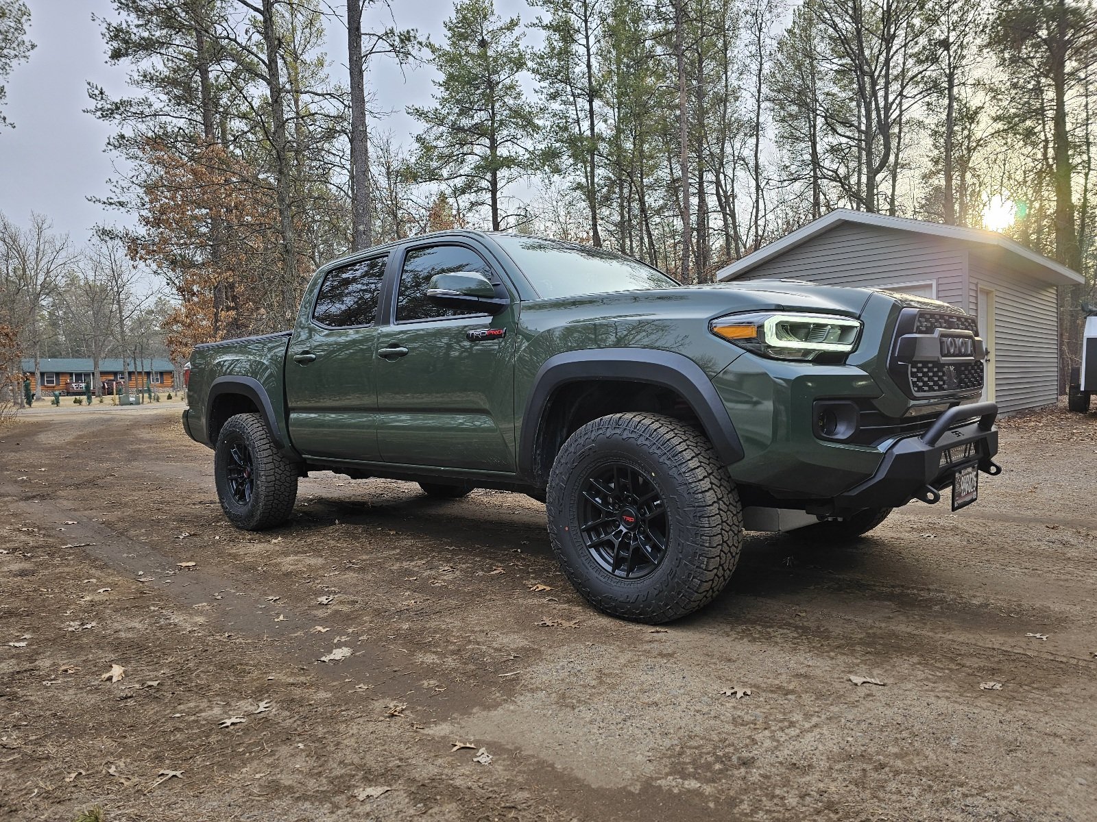

    Lift is in!
    When I ordered the lift I also ordered some leaf spring liners in hopes it would help stop the squeaks. I ordered two packs, one per side, one pack arrived on time, the other pack got delayed for two weeks. I already had plans to install everything and didn't want to wait another two weeks, so I went to the hardware store and picked up a 20ft roll of garden edging and cut it in strips. Unfortunately I didnt get photos of cutting the edging, but you should get the idea from the photos I did take. Along with the liners I also coated each layer with teflon spray lubricant. So far no squeaks driving around today, we will see if it lasts.
    I went with the RXT option 2 for the rear. gained about 1.75 in in the front, and about 3 in in the rear. Will measure again in a few weeks after things settle.
    I also got my Total Chaos stiffeners installed. No photos but we all know what they look like.

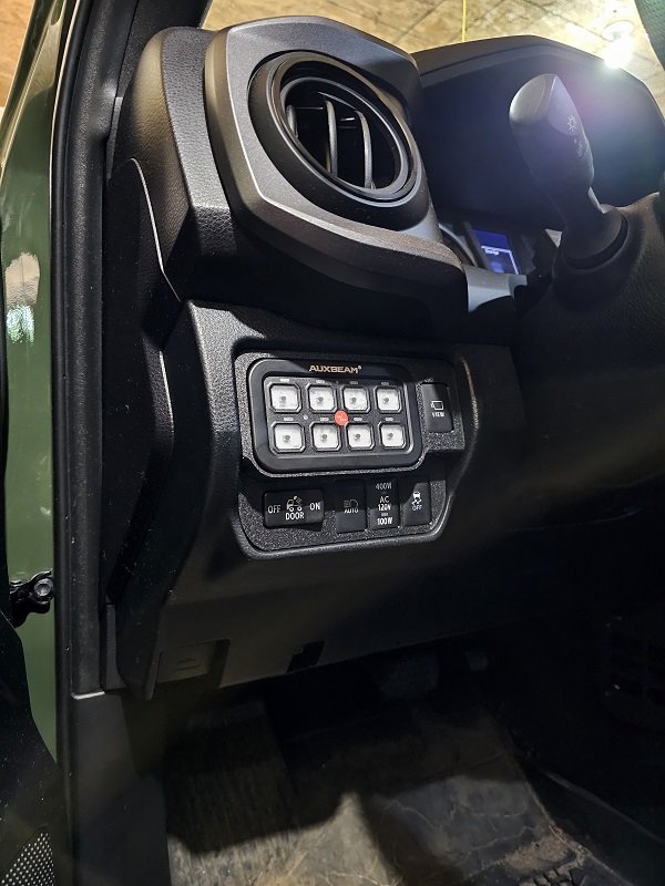

    I printed a switch panel and installed a Auxbeam 8-gang
    Added a larger transmission cooler with puller fan. Fan can be turned on through Auxbeam.

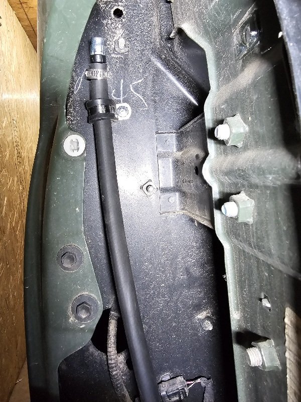

    Rear diff breather relocated to rear tail light.

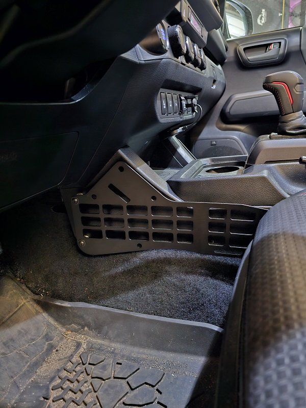

    CaliRaised molle installed

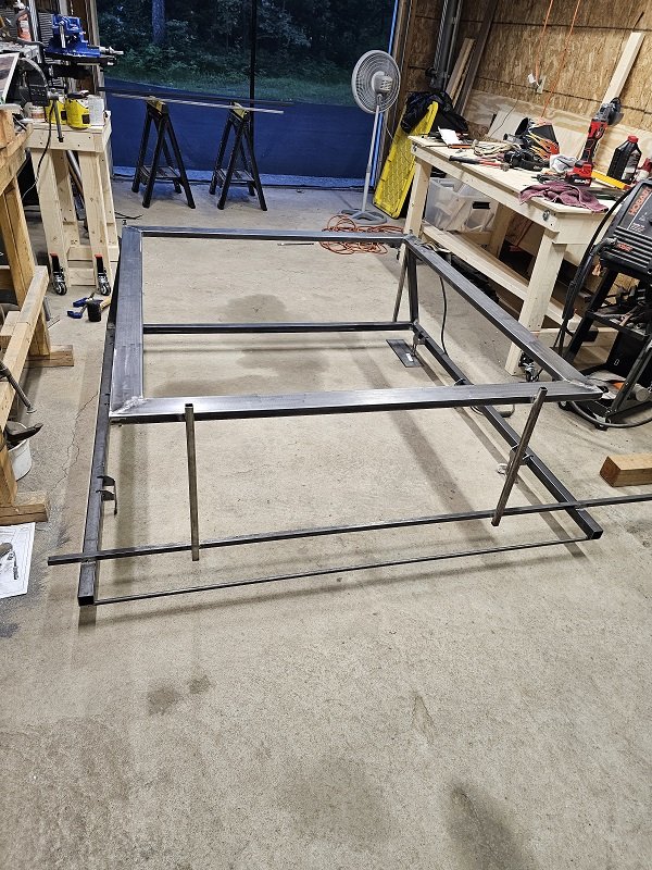

    Wholy crap I've been busy. I need to stop doing these projects in the summer when I want to be out doing stuff.

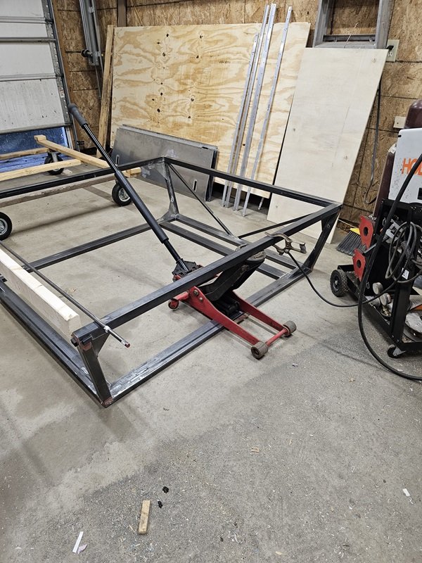

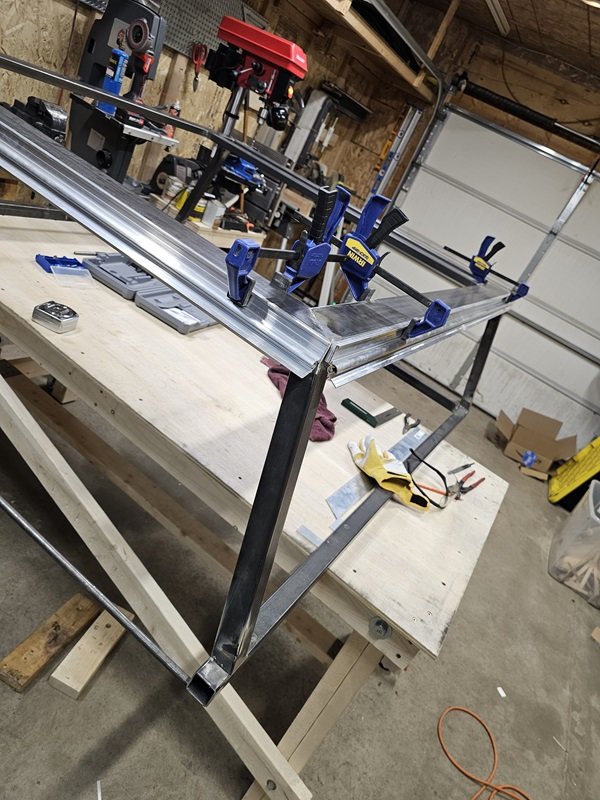

    Started my build on my DIY wedge camper. I actually started this early July as I mentioned it in a previous post, but have been really cracking at it the past couple weeks trying to get the topper portion finished for our upcoming trip end of August.
    Plans based off Ripcords thread here, https://www.tacomaworld.com/threads/how-to-diy-wedge-camper.604686/
    I wanted a GoFast style camper, but I want the RTT portion removable. Since the RTT bolts to the space frame I figured it would be easy enough to do. No weld porn here, I can make two pieces of metal become one but I can't make it pretty. All the red stuff you see is a metal filler to smooth things out after some grinding (hopefully it holds and doesn't chip).

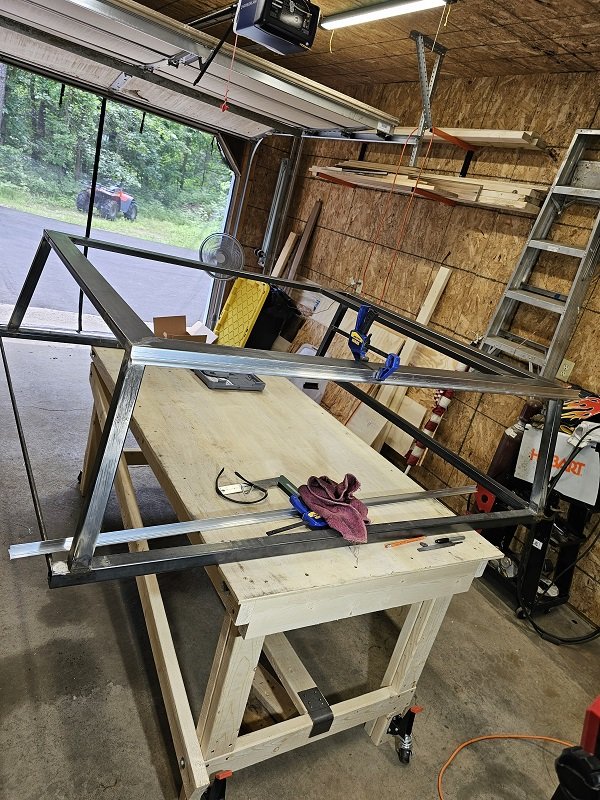

    Started with the space frame. 14ga 1.5x1.5 and 1x3 square tube.
    Plans for brackets for bolting to the bed bought from Ripcords website. Sent files to a local steel shop and they knocked them out quick and easy.
    To my surprise everything was dimensionally correct and square within 1/8 inch!
    Next was mocking up hurricane hinges for the doors. These hinges are spendy, but they work great and stop water from getting past your hinge.
    I needed something to close off the ends of the hinges at the rear, so I designed up a piece and printed it. After a few revisions I have a good prototype, so I'll print in PETG once everything is ready.
    I decided against using the Aluma-panel that everyone in Ripcords thread was using, and instead opted for .125 solid aluminum panel. This offers far better resistance to bending and warping. I also added a slight bend at the bottom of each door to fit the frame and add a little structural support. I drew everything up in Fusion360 and sent the files off to the shop to get cut and formed.
    I designed the front panel to overlap the hinges so help keep water from blowing into the hinge on the highway.
    This is where I messed up... while drawing up the braces that the latches will catch onto, I also drew up some corner braces for the upper corners. When welding these in I was careless and ended up causing the frame to warp. The frame bowed inwards and the rear door opening moved in about 1/2 inch. I was able to use the floor jack to straighten things for the most part, and I had to add some inconvenient vertical supports to keep things in place. I tried to use cross supports from the corners, but since i didn't plan them in originally they would interfere with my latches and gas shocks so, oh well. Ended up cutting all the corner braces out except the ones the latches use. Lesson learned! In the end I was able to save the frame and continue to use it, but I might build another one this winter and swap everything over to it.
    Side and rear door with latches and gas struts in place, everything works!
    I have a few more holes to drill tonight for the roof panel and need to weld on the bed rail brackets, but then I think the frame is ready to sand and paint. I need to order a rear brake light still, and design and fab something up for the Wolfbox camera, but thats should be easy. Matte black wrap is on the way for the panels. Hopefully I will have this part of this project finished in a couple weeks!
