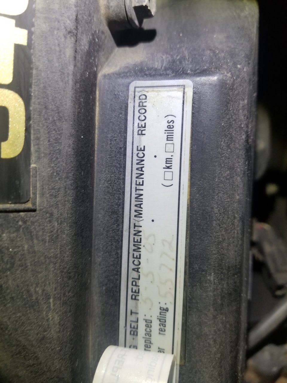

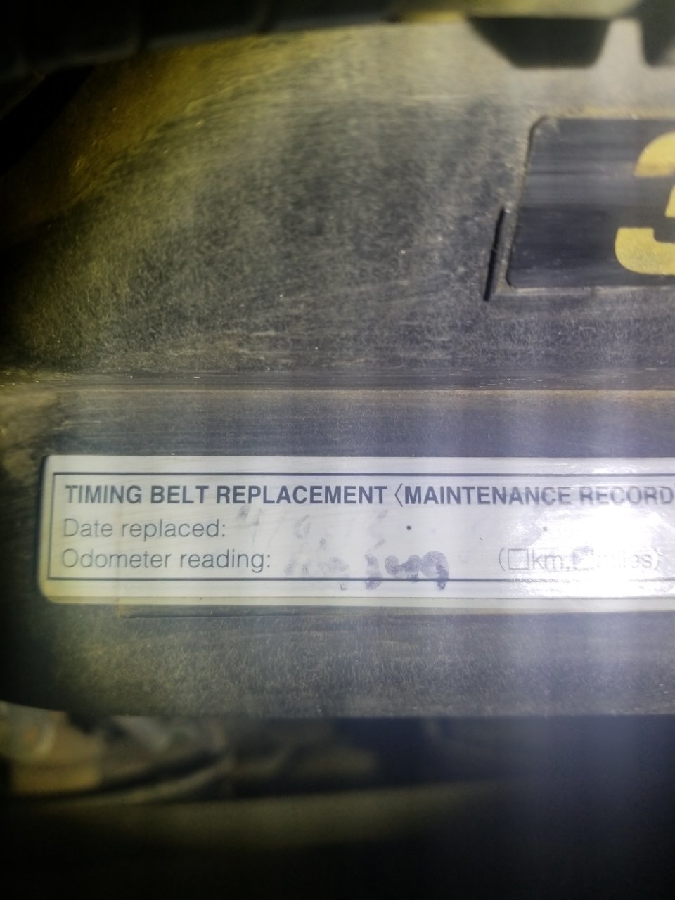

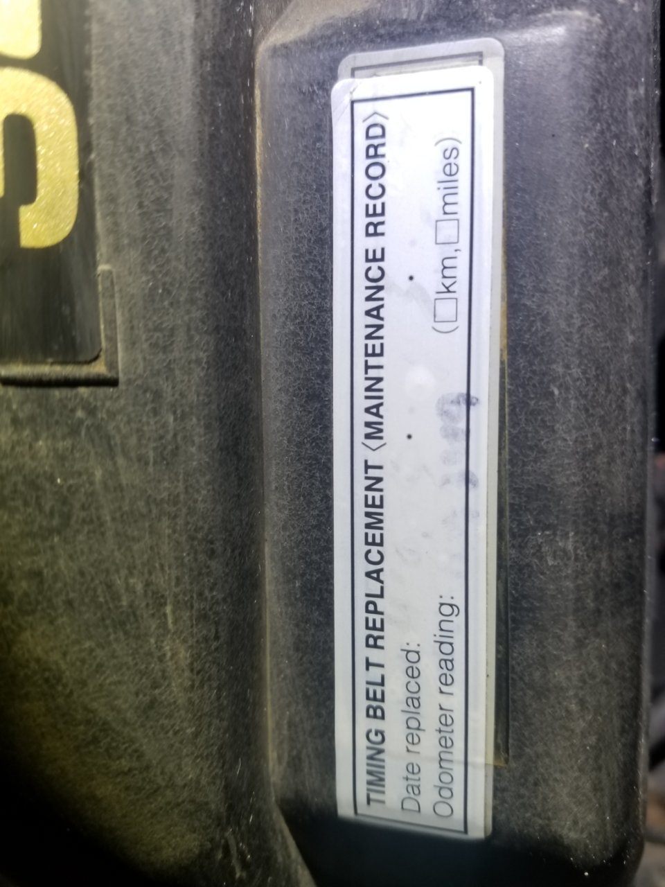

    My timing belt has been a thing I have been looking at doing. But while switching vacuum lines saw the sticker for timing belt replacement. First sticker it was done at 55k miles back in 05'. Cant tell the last time it was done. Or any guesses when they would have done it again after 55k miles? Truck currently has 117k miles.

    To me it looks like the date might be 4/9/15 but I have no clue about the milage.

    Toyota wants you to change it every 90,000 miles. He did his at 55,000 which means he cared about that truck. I know cause I changed mine at 57,000 miles and I REALLY care about mine:) You don't need to change yours again for a while. Maybe at 145,000.

    At that mileage the engine needed to come apart so it was done while it was off.

    In 08 it had 99857 miles and I bought it in January with 115k miles. That's what I thought I see as well. So it maybe had 105k or so miles when done.

    date is 4/8(or 9)/15 (slashes not dashes for separator), and then over 11x,000 but that bump in the sticker allowed it to be worn away easier (unless a doctor wrote it, in which case you'd never know :) )
    and they must have either beat the hell out of it or highway drove the shizz. honestly we can't tell what year it is, you have 2005 listed in your description but this is a 96-04 engine, if it's an '03 then that's 55k in 2 years

    This is a 2001 Tacoma Double Cab with the 3.4 engine. Have not updated my ride yet. I am getting the records from the 2 dealerships listed on the carfax to see what was all done and when it was done. Just curious if they did other things when they were changing the timing belt or not. So hopefully I can know something or atleast timing on when it was done.
