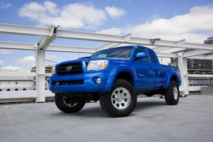

    image.jpg Hey guys,
    I'm looking to get some new wheels and tires for my truck. I love the look of the truck in the attached picture. I have a similar lift (2.5" up front and 1.25" in the rear). Given someone with a little more experience than me, what is your best guess on wheel size/tire size? I'm guessing they are 18 x 9 rims. No idea about offset but they look like they're about an 1" further outside compared to stock. If I had to guess I would say tires are 265/70/r18? What do you guys think? Can I get a similar look with 17 inch rims? Any ideas would be much appreciated. I'm new to this...

    Look like 17s to me, with a mild lift.

    My money is on 17s as well. Probably 2" lift and 265/75/17 for tires..?

    Any idea what sort of offset? 17x9 with a 4.5 or 5 back spacing?

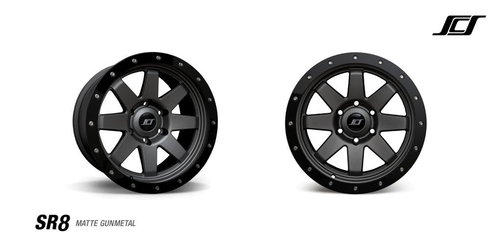

    Peter North
    British Columbia
    Who makes a 265/75/17 ?

    887 1.5 AAL JBA UCA's 285/70/17 Trail Graps 17x9 Fuel Hostage Custom Headlights

    Both, I was actually looking at those wheels earlier. I'm not set on them though. My main concern right now is getting the stance I like. There are a few styles of rims that I think will look good so I'm not too concerned about that yet.

    Those are pretty slick. I'm a little bided towards polished aluminum though. So 17x 8.5 with a 12mm offset should get me what I want?

    They don't make any SCS in polished aluminum that I'm aware of. As far as the offset, look through that thread, there are like 40-something pages. All kinds of pics of them mounted. Also compare those with the stock wheels with the calculator I linked to. That will tell you how much more the wheels will stick out. On most pics I've seen, the tire is just past the wheel well. You need to know what the your stock wheel specs are.
    If you had the Offroad wheels, the wheels would stick out 1.73" more toward the fender. BTW the offset is -12 mm.
