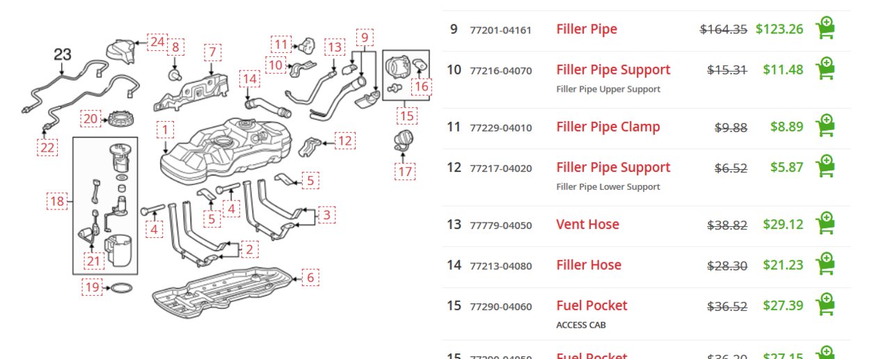

    Yeah, you're not the first, assuming you mean that you drilled through #9. I think the dealer wanted over $500 to replace the last one I read about.

    A cheap trick (not the band) is to put some electrical tape on the drill bit as a stop for going trough only as far as you need.

    A few people have done this. Always best to use a uni-bit.
    I would drop the tank before I unbolted the bed.

    Might as well completely cut the line, install a piece of hose over the cut with a pair of hose clamps. It will be fine.

    Depends on what line and where it was cut. Pics! Is it the fill tube?

    I'm on a ten day road trip, sadly without my new taco. Hoping to have a plan by the time I get back and can post pictures then.
    The Mrs says I should bite the bullet and let the dealer fix it and move on but I'd like to tackle it and avenge my stupidity.

    what fuel line did u drill thru:confused: if u drilled thru the filler pipe its somewhat easier to replace than the high pressure fuel lines
