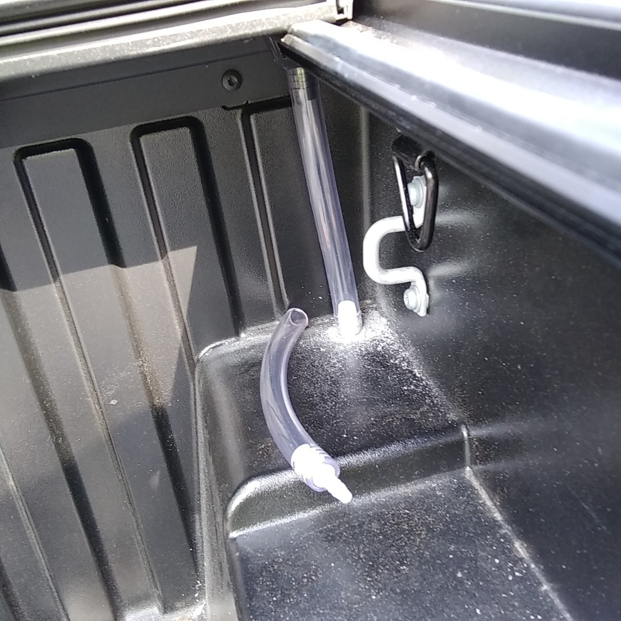

    OP, reading my post about drain lines. Might have saved you. 20190629_165629.jpg 20190629_165944.jpg

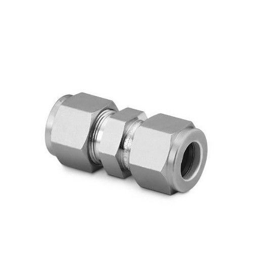

    If it's in the filler line, Jb weld. Not kidding. At least even as a temporary fix until you can order in a proper replacement.
    If it's a metal high pressure line cut it out and install a compression fitting.6B39834D-C4B0-4486-B000-9CD6B81988C1.jpg
