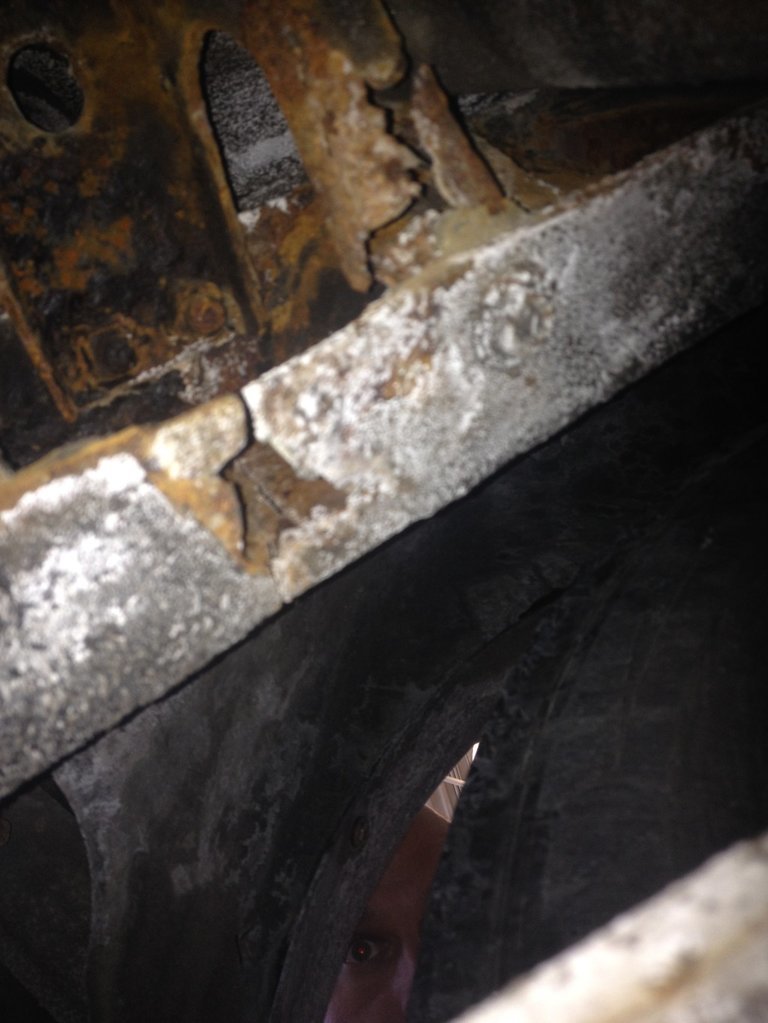

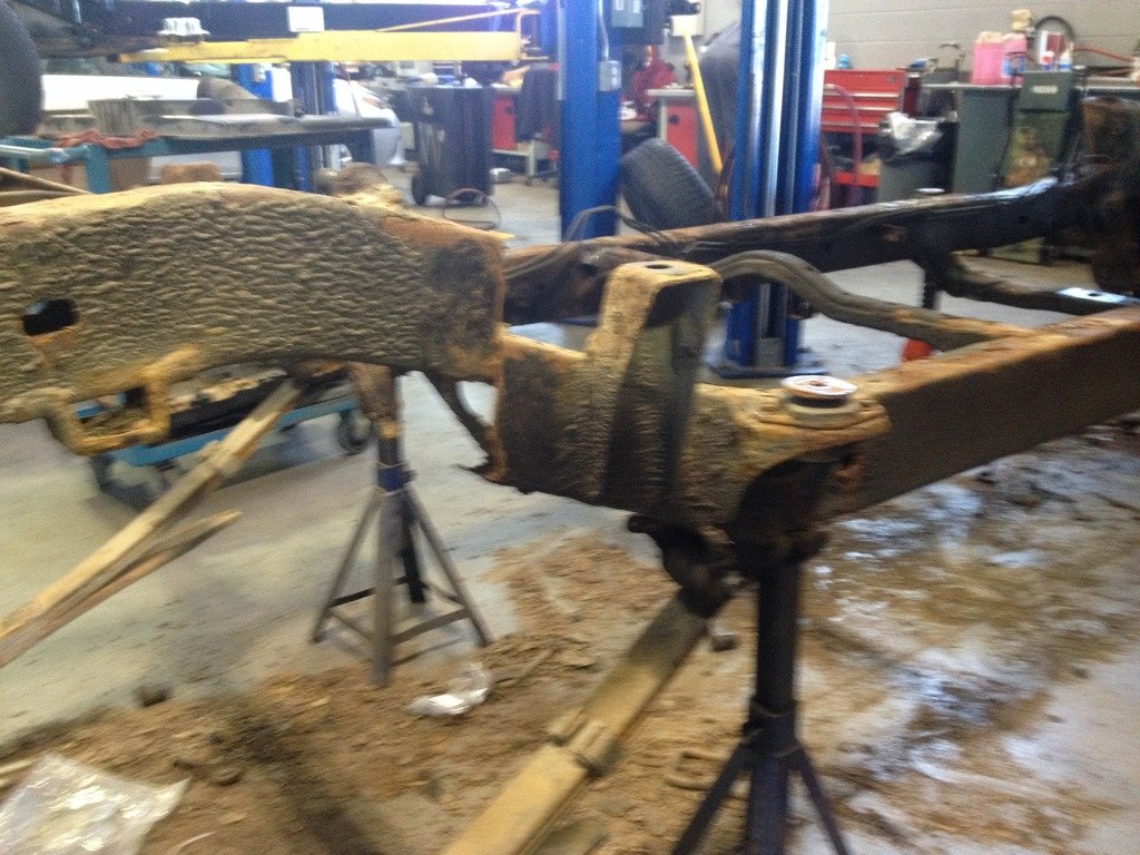

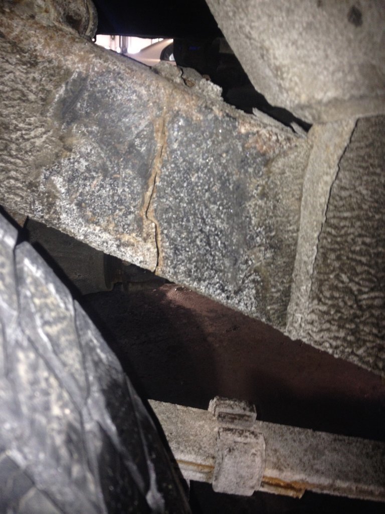

    I bought it on febuary 25 of 2015, all looked well when i went to look at it, i was familiar with the frame rust issues before i checked it out, in fact i have an inside guy who has worked in parts at the dealer for some time who gave me some history on the vehicle when i provided him with the VIN, one crucial piece was the fact that the frame inspection was done in July 2009, it passed and was "rustproofed" with the dealer coating which extended the warranty on the frame for 15 years from the in service date, for me was may 2002.
    So i purchased the truck on the wednesday, and brought it into the shop on the followinfg Saturday to give it a good going over when i found this
    89886725-4F89-4B81-8163-9EF8E4E1C93C_zps_8f1fc19c80bd857bd011e0cf2406a20dfd8bfe41.jpg
    2B8050E1-840C-474D-98A5-016E021B69A4_zps_1672f6aa33a2c193e1f4e969ec3ab7b49849e8d0.jpg
    So i sweated it out over the weekend and with the info i already had i figured i would be covered for the frame under warrany
    I brought it to the dealer on the following monday showed them what i found(remember i just bought this truck 5 days prior) the next day(which im told is pretty quick) i got a call and they told me that it qualified for a frame replacement under warranty!
    For me this was like christmas in March!

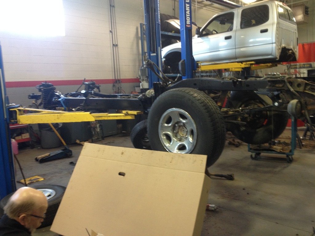

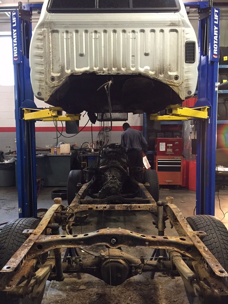

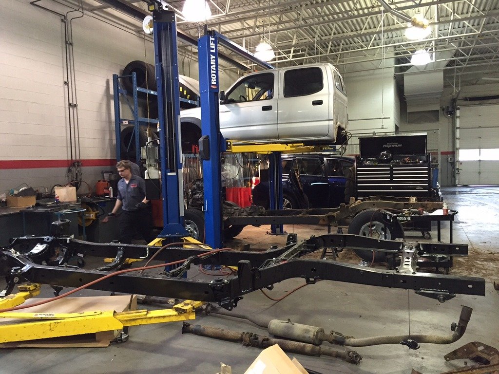

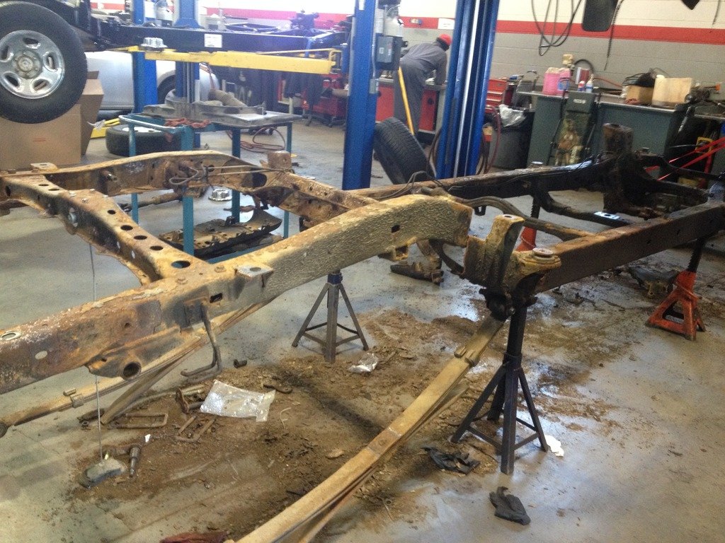

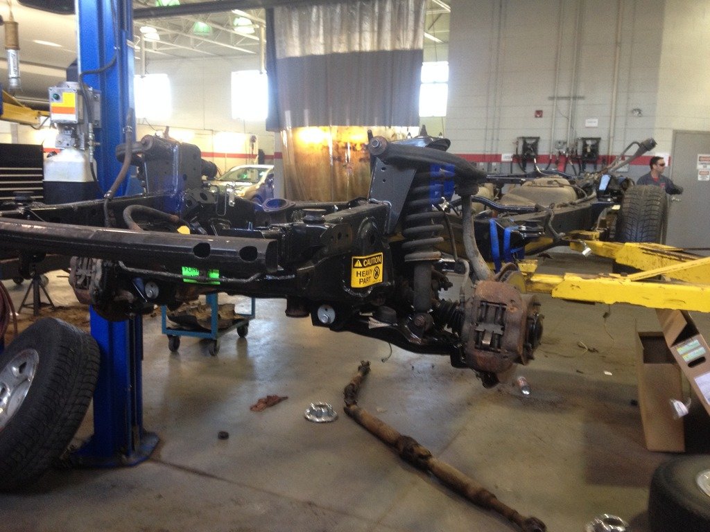

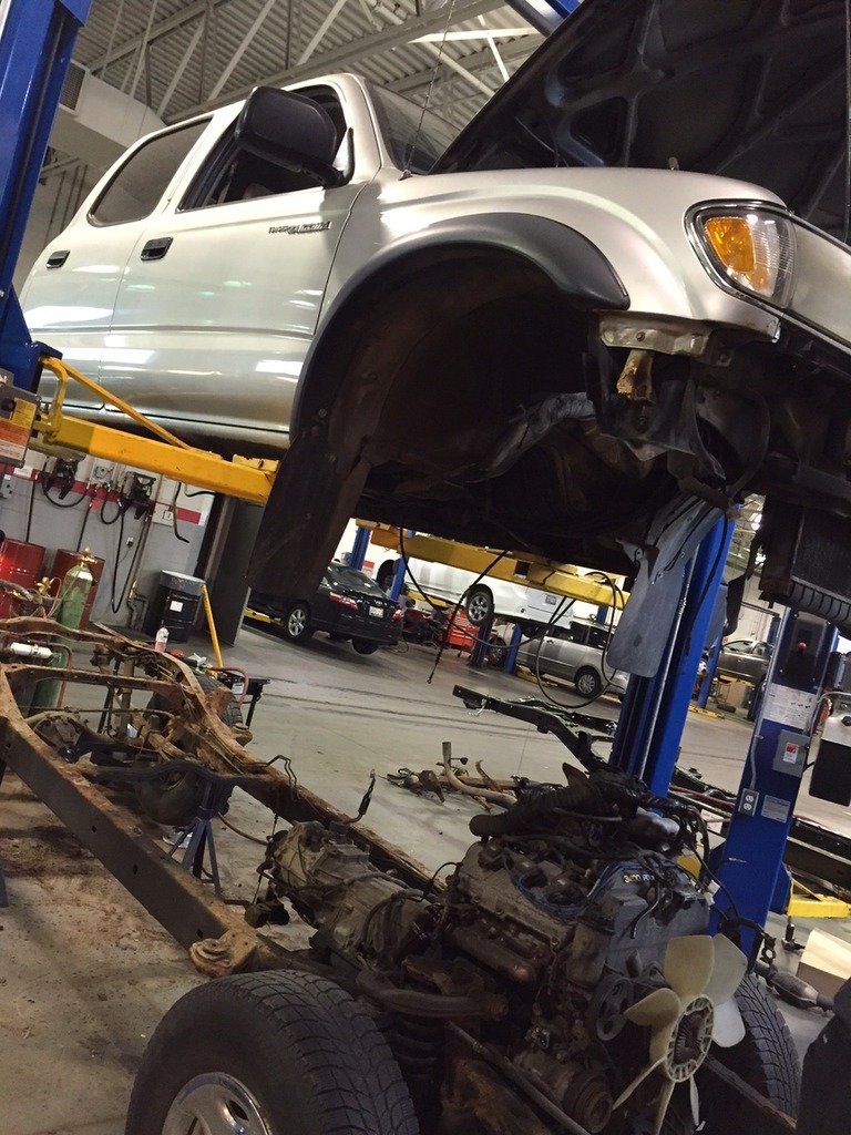

    7 weeks later all the parts were rounded up and the process began, it took them another 3 weeks to get it all together but ive got it back now
    The tech was nice enough to take some pics, and i took some of my own on a visit to the dealer when they wanted me to switch out my loaner so here they are
    A59AF538-8672-4B81-84A3-1115461C0E49_zps_08c27ec4adec8691357a118e80d14cca8ddf1929.jpg
    3B954992-D5BE-43A9-A1DC-67BA72A9BAB0_zps_a92a6fd2468810eb85c97d9f124187d0c34ba1c6.jpg
    D1D7413B-688A-4A29-AFF3-141B12D0546D_zps_88ec707381da46bd8b257541b80c76bbd625e84b.jpg
    72FB0FEA-072C-4E9F-A03E-EC131CCDD130_zps_ee5fd27ef8f15312c551454debc9398abfcb7a7e.jpg
    1844C83A-7B11-4309-A65A-E84B38EA97A2_zps_533c07be0efe738c79e37bcd600cf2fd5a0baf33.jpg
    93504E54-1AB8-472B-8E94-324F1F1F1FD5_zps_9570749549b0591ca4c3a8d106161afe3fda8089.jpg
    BCB0D775-6E74-4905-8D8A-C29807F64163_zps_414b589363595462303f00910a918878c21c4d4e.jpg

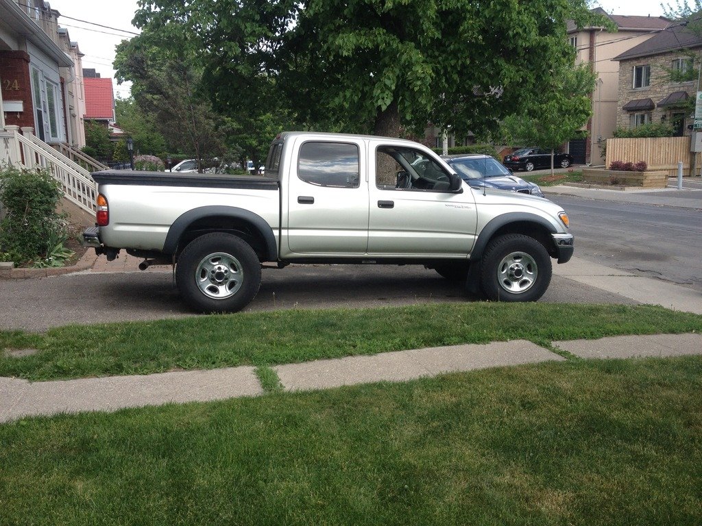

    This is how it sit as of today after i picked it up and brought it back to work

    grats on the frame.
    on a side note....not a fan of the chevy rims :D
  7. May 28, 2015 at 4:33 PM
    high n mighty
    high n mighty [OP] Well versed in sarcasm
    Mar 3, 2015
    #150031
    457
    Pickering Ontario
    01 DC
    Yeah those are the winter rims and tires still on there, it was there since early March, putting the summers on today

    do you know if the frame was completely separated like that on its own or was it still barely hanging on and pulling the rear axle "helped it" to completely separate on that one side?
  9. May 28, 2015 at 7:12 PM
    high n mighty
    Mar 3, 2015
    #150031
    457
    Pickering Ontario
    01 DC
    Yeah it was split while I was driving it, the ass end would jump around a lot changing lanes over uneven pavement or cornering, the leaf spring was holding it together
