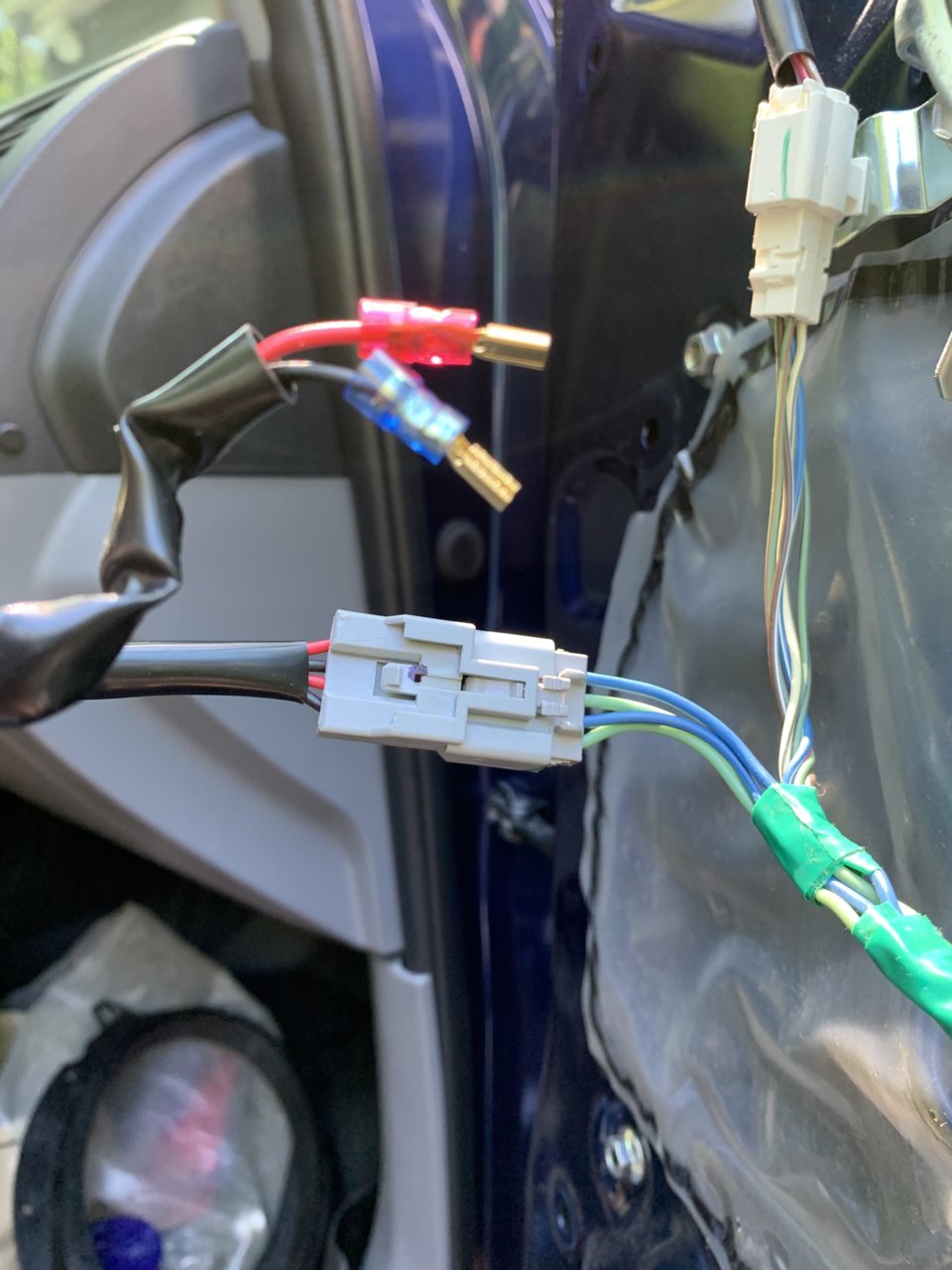

    Old thread but I just did this today and got away with a lot less harness tweaking.
    I cut the stock tweeter red and black wires right at the source. Installed kicker is above:
    The only connection I needed to do is pos/neg for each tweeter. The rest of the factory harness was kept. (Factory harness, male and female seen right below the crimped connections I made.

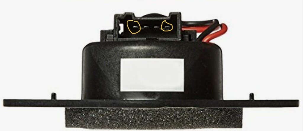

    The reason you only need one connector each for pos/neg is that the four pins on the Subaru Kicker are actually two sets each with two prongs joined. That one little connector for pos/neg for each side is all that it takes. This image is a crappy drawing of the side view of the Subaru tweet staring down at the built in connector harness. I might not have drawn this totally accurately.

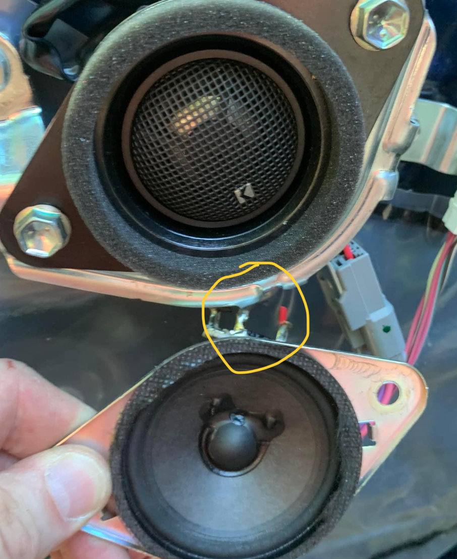

    - I cut the single black and red wire that is soldered to each factory tweeter (first photo)
    - I crimp a connector on the end of the black & red wires I cut off the factory tweeter (the red and blue connectors with gold tips in second photo).

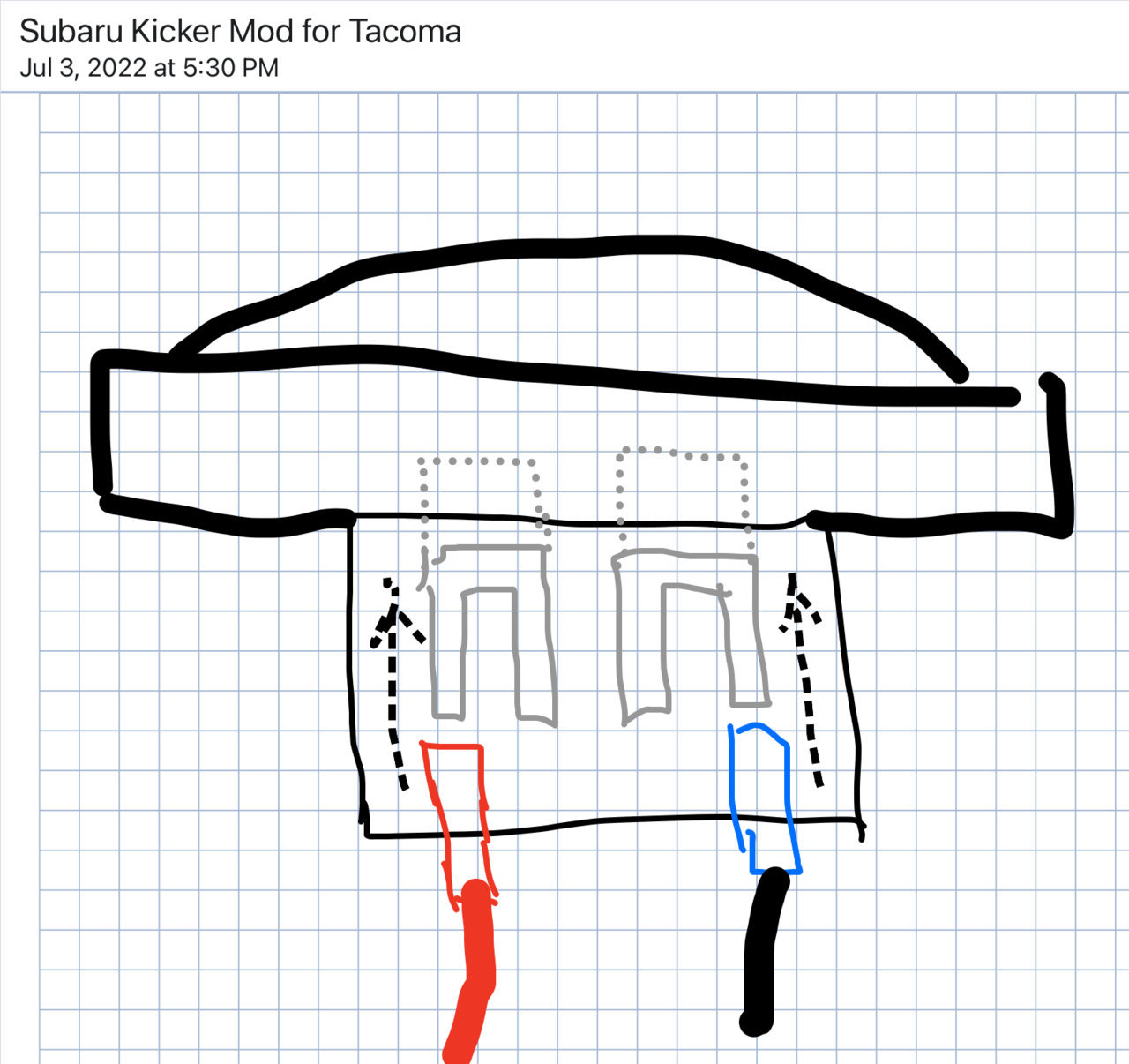

    - I put a red and blue connector I crimped on into the input of (each) Subaru Kicker as shown in that silly little drawing I tried to do (final image in my post).
    That’s all I got, first time ever posting a car wiring thing on the internets so a lot of room to grow.

    So, from this photo is looks like the OEM tweeter has a wire pigtail attached to a female connector so that the female connector is NOT integrated onto the tweeter body like the new Subie ones. Is that correct? If that is the case it seems like you could cut the female connector off the old OEM tweeter, then cut open the connector housing on the new Subie tweeter and solder on the wires from the OEM pigtail onto those pins. Then just plug in the factory male plug. I'd prefer to do that instead of messing with the male plug like the OP did. Has anyone here tried that?

    That's sort of what I did but a LOT less cutting and hacking. I cut the two wires off the Toyota factory tweet (all other Toyota OEM connector/harness stuff remained), crimped on two new connectors and attached those two connectors to the harness built into the Subaru Tweet. I didn't have to cut or hack any Toyota Harnesses or the Subaru Tweet. You only need two wires to go to the Subaru Tweet. The connector harness built into the Subaru tweeter has 4 prongs but they are joined together as two sets of two so you only need one connector to go to each pair. (As my crappy drawing tries to show.) I gotta do a better drawing!

    But from the photos I have seen the Subaru tweet doesn't have a harness or pigtail. The connector seems to be integral to the unit. Are the internal wires still accessible somehow?

    If you look straight into the built-in harness on the Subaru tweet you can see 4 pins. Picture below. Note that if you stare in there real close you will see that the left two pins are connected to each other as are the right two pins
    You can see where I made the yellow circles on this image. If you crimp on the smallest auto connector (2.8mm) to the wires cut from the original Toyota tweeter you can attach the connectors to two of these pins and you are good to go. No harness cutting, harness carving, etc.
    But that begs the question why bother with the Subaru Tweeter? If you cut the red/black wires at the Toyota tweeter and crimped some connectors you could hook up any tweeter.
