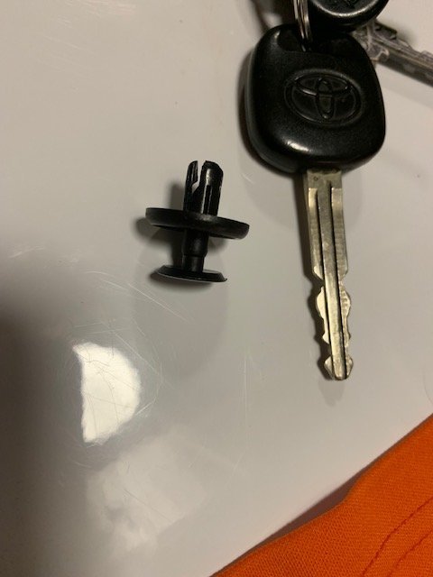

    Does anyone here have the part number for this infernal pin? I did my Focal component speaker install yesterday and both of these pins either broke or just came apart. They released just fine like in the 2nd photo but when I tried to ease them out with my fingernails the center pieces fell away into the door. Or, alternatively, maybe there is a specific push pin that would also work?

    I had some other 6mm Toyota/Lexus push pins around from replacing my headlights and these fit the door panel and work just fine. They look a little different from the original, but IMO look just fine in that location.
